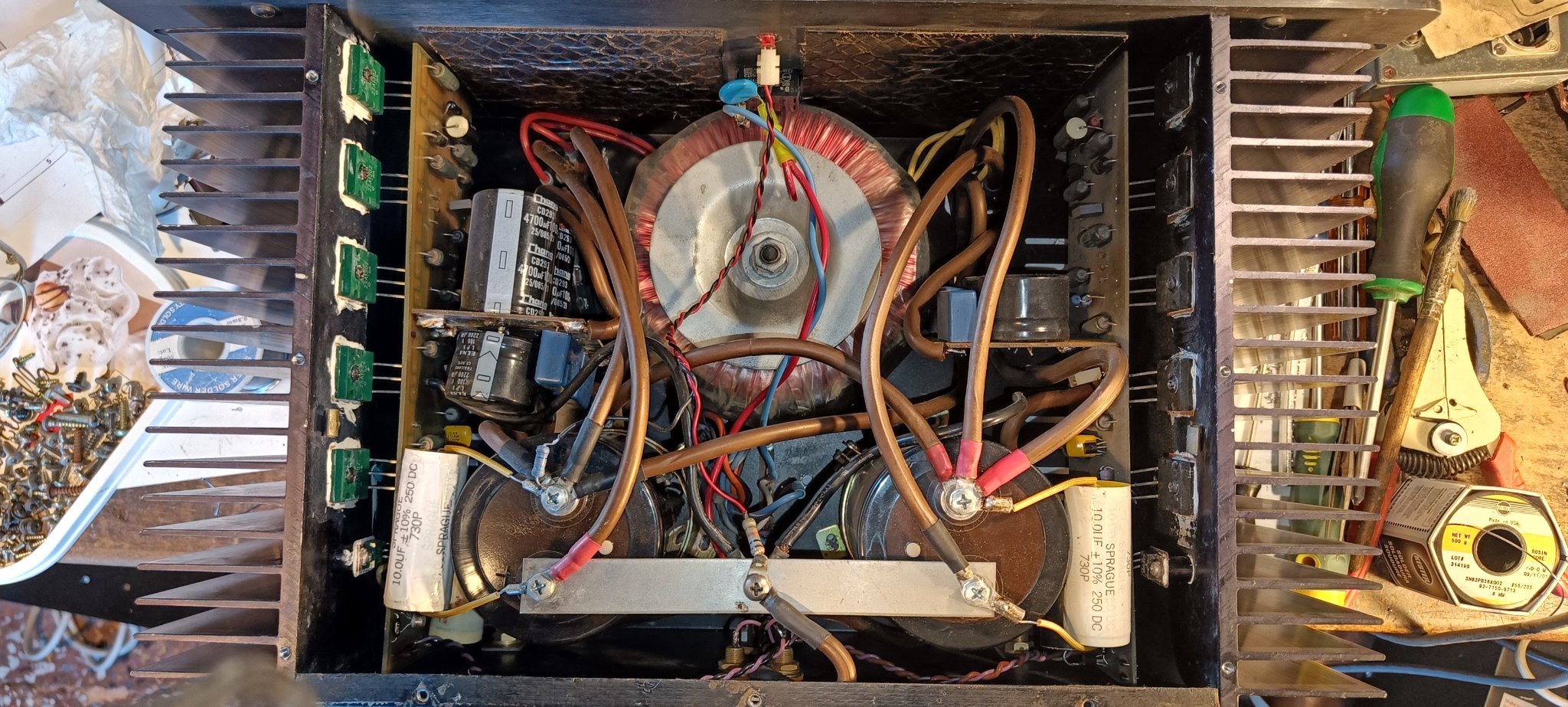

My Forte Audio model 3 "turbo"...
very large capacitors(47.000uf x2 + 4.700 & 2.200 uf x4)
New emitter resistors(0,22ohm)
All new resistor high precision RY55
cable VDH
High current polarization.

  • After 80 hours of use since the last upgrade the final change in sound for the better occurred, and stayed that way last four listening sessions - interestingly enough. Zero changes after 80 hours of full play time. Plays the same every time now since.
  • Checking again with my tech [Vintage Amp, Jon Soderberg], there is a theory as to why after upgrading my amp. To recap, about my upgrade 1) reconfigured it to Pure Class A 50 watts, different taps on the Torroidal transform too if it matters, 2) replaced all for main power caps, 3) soldered in bridge rectifiers, 4) upgraded rear wiring some, 5) changed out and soldered in binding posts to Cardas speaker binding posts. Multiple connectors removed in favor of direct wire soldering.
  • Here is what occurred leading to the weird changes in sound [temporarily]. Last summer I pulled this SS Forte' amp out of rotation maybe at 40-50 hours of use I'd guess since the last upgrade and service last summer. Swapped in and played my mono tube amps into the holidays. I then swapped out the tube amps an put the upgraded Forte' amp back into rotation. Again had 50hrs on it since the upgrade, was cold, and the first two times I played it only 3-4 hours each time - it just sounded a bit cold and grainy, was not sure why. I wrote the post above, was fishing for thoughts.
  • 3rd time I played the Forte' amp I left it on for 24-48 hours, and during that listening session I started to notice a nice smooth change in sound. Like "wow" sound, hey this sounds really nice type of thoughts. All the sudden the music started to become really engaging. I called Jon, he asked "how much time do you have on the amp again since the last upgrade and bias checking?" me: "now over 75-80 hours now, since I put the amp back in rotation". Jon: "That's it, you've got enough time on it now since the upgrade and changes we made", "that's about right for break-in again, that makes sense why you are now hearing the changes", etc.
  • Since that time, every time I play the amp, takes about 45-60 minutes of warmup, and consistently sounds good every time. No changes in sound now playing the last 4 times. It's really good now. Extra happy with the upgrade, sound, and consistency now. I guess it just needed more time for big caps and all to settle in. Whatever the case, super happy now.

Yes and No. Probably the first and most important question and concern I had with the decision to reconfigure the Forte 3 180w Class AB to Forte 1A 50w pure Class A operations. Four new and larger power capacitors were installed, all five Mosfet output transistors per side are still in play [and re-checking with Jon again, a correction], bias was turned up to a max 50 degree Celcius / 122 degree Farenheight at the heat sinks. Some suggest 45-47C, yet the tech Jon said something about voltage down, bias up, I don't recall exactly, about the amp "lasting".

Top end is smoother, really nice. There is this aspect about texture and tone that I really enjoy. Sound stage seems a tad larger maybe. Low end grunt is still there, maybe something more with the lower gutteral deep bass - or I'm imaginging that, I don't know, just hearing something more. It turns out now the break-in process [after upgrades] was more of a roller coaster than I was expecting. Last 7 listening sessions have all been the same. It does take at least the full 45-60 minutes for the amp to sound nice, maybe even a tad better at 120 minutes, more body to the sound, this added weight to the sound really becomes evident after its been on, warm, fully saturated.
