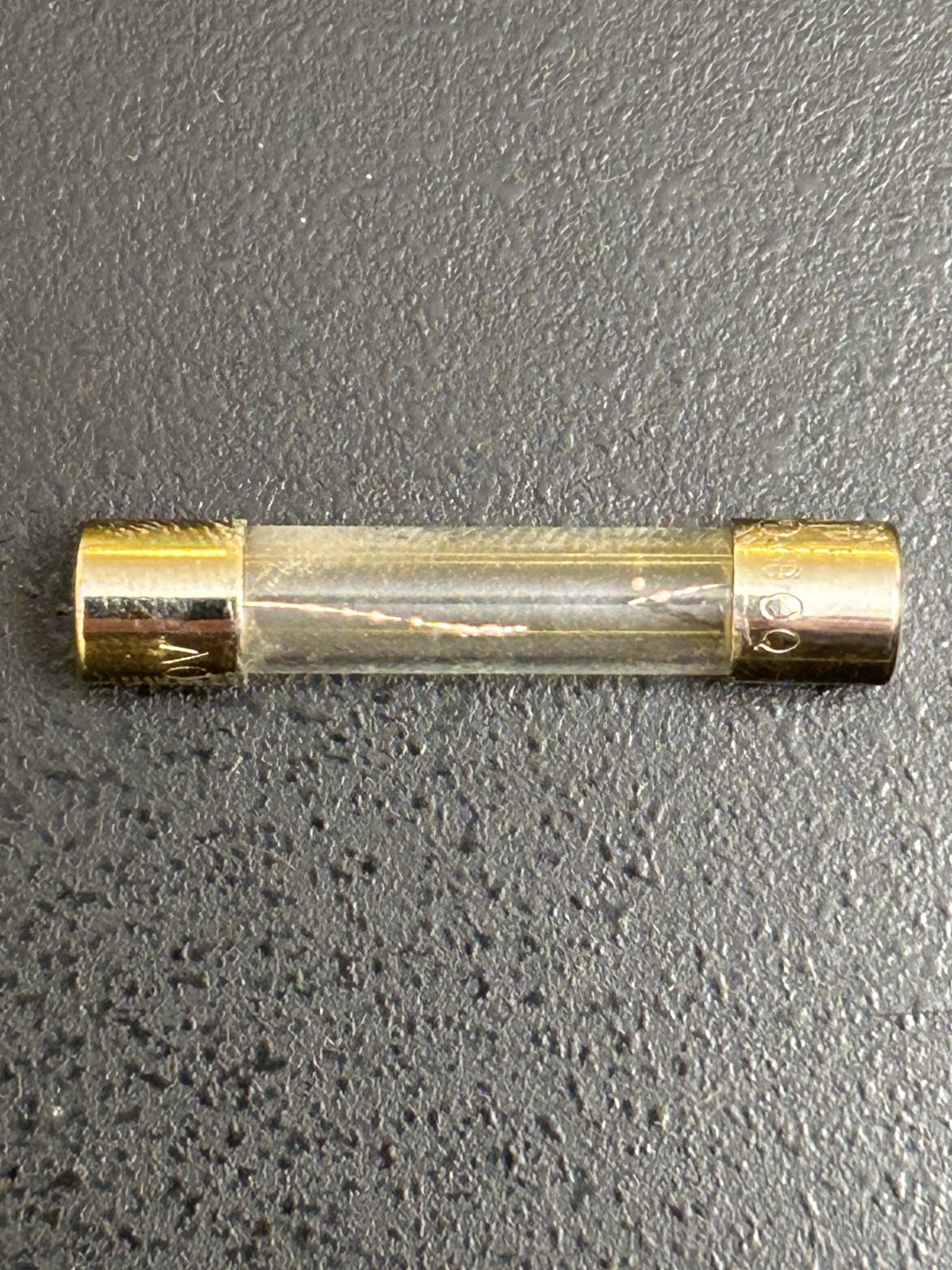

On a total side note... the negative rail fuse on the left channel of my brother's model 4A gave it's life in service after a power surge. I went through it yesterday, and all seems to be well after a quick replacement. (A Soderberg amp also).
Good luck. I hope it's well-loved and preserved in a new home.
Our fallen soldier...

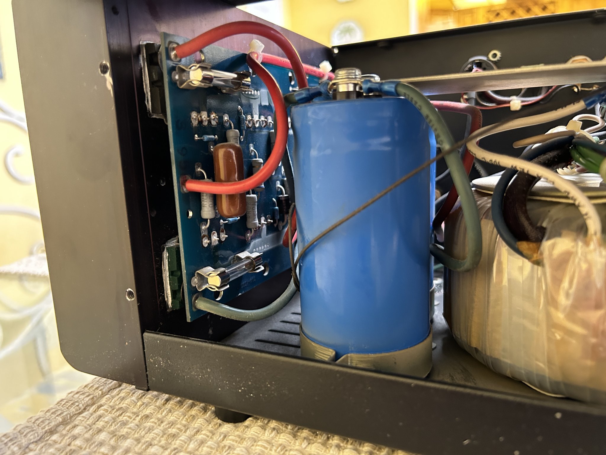

I'm the OP of this thread and even though my unit went through some maintenance that fixed most of the issues I was having at the time, I'm still dealing with a 100hz hum, so given the age of the unit, I'll probably go ahead and replace the electrolytic caps.
But even though I know how to solder and measure stuff, I'm not an expert and I was wondering if you could use the pictures on the first page to let me know where exactly is that DC blocker cap you mentioned. Do you have any more tips? The amp sounds great, but I'm sure replacing those caps is overdue and getting rid of the hum will help clear up the signal and improve it even further, so if you have tips on which caps brand/models to use, that would be great! I'm located in Europe, so Mouser and Digikey will be my sources for the components.
Thanks!
I have one of these too and the only electrolytics that I noticed are the power filter caps, I don't see any electrolytics on either of the channel boards; lots of film caps though. Where are the board electrolytics? Anyway, I've never had any warm-up issues when bringing the amp back into my system, why would that be the case unless there's some component that's failing? The amp does run on the warm side, and to set the transistor bias, I was told, that it's set by measuring the power transistor temps and when you reach a setting that maintains a stable 40degC the bias is considered correct; which for my amp was about 38mv on each channel. And then it takes about 30min to reach operational temp. Yes, the amp does sound better after a full warm up, but I thought that had more to do with the temperature related bias settling in, and it was never objectionable anyway, but the sound did take on a more detailed quality after warm up. Now, I have heard that it's much less stressful on the switch and electronic components to leave the amp powered on rather than turning it off after each listening session, but that's not what we're talking about here, is it? Lastly, my amp is dead quite, no hum at all, perhaps I missed something but how was it determined that the hum is 100Hz, and not say 60 or 120Hz?
