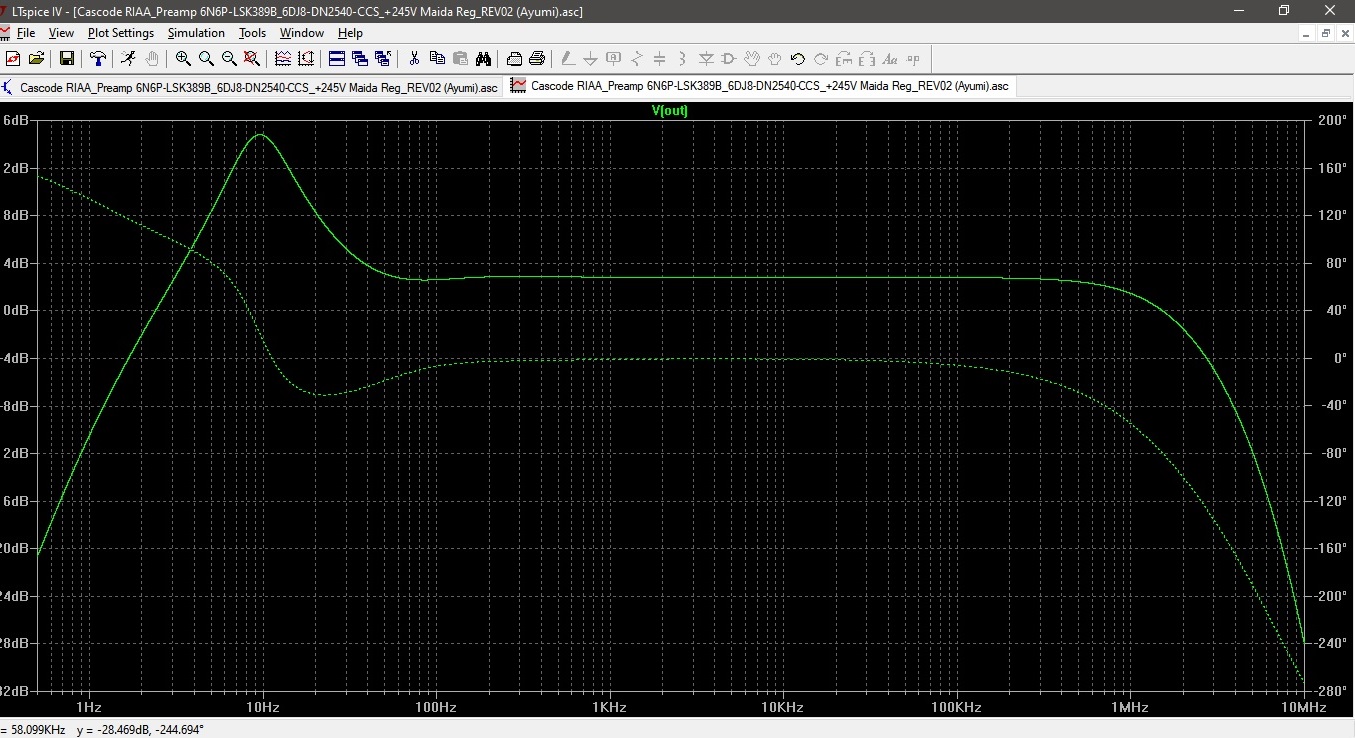

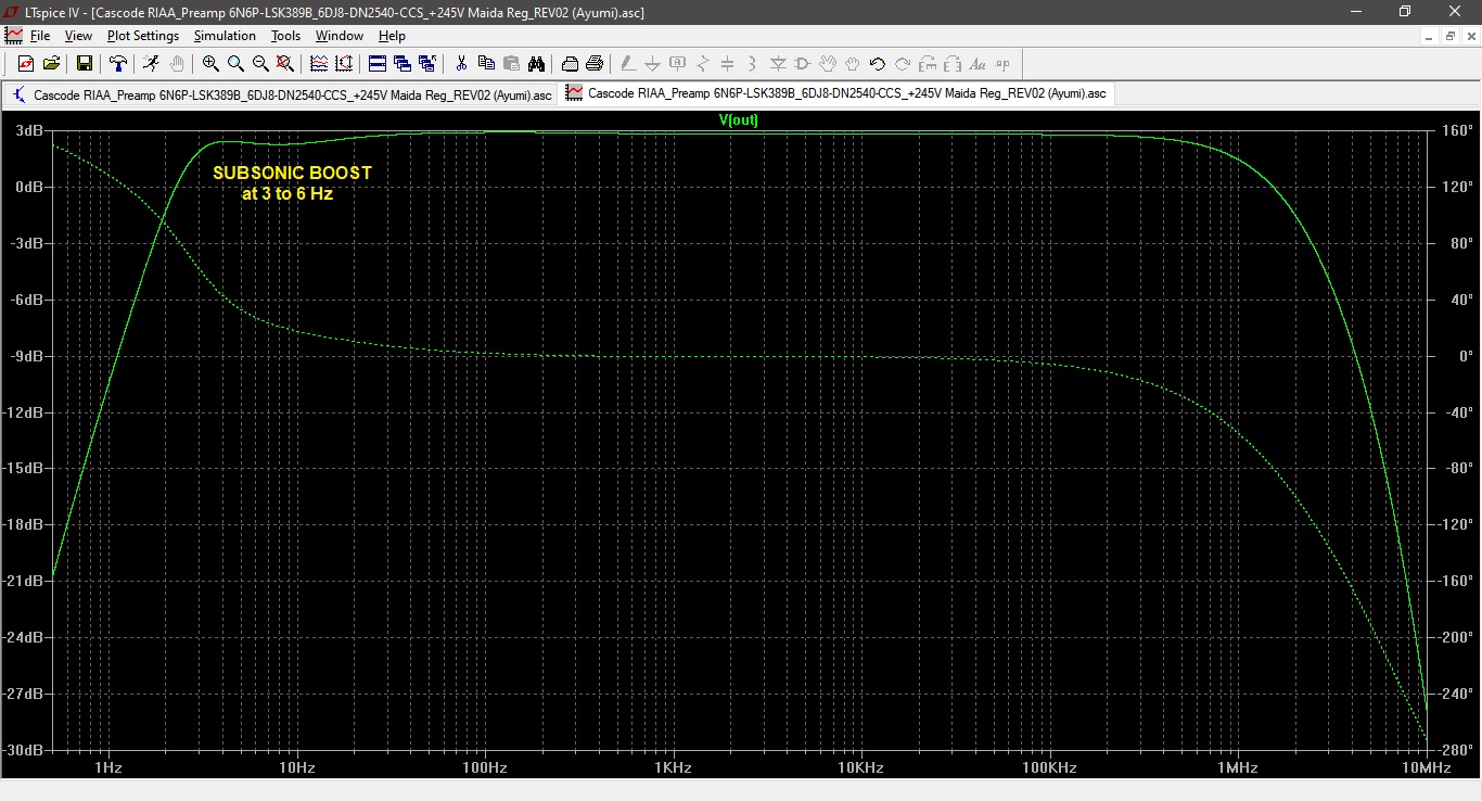

I was thinking about how subsonic booms could happen from inadequate decoupling between stages of a tube phono preamp even if the B+ is a super-low output impedance regulated supply. I wanted to believe that a stiff, regulated B+ would keep this from happening, so I could use fancy film caps for 'better sound'. So I tested the problem in LTspice.

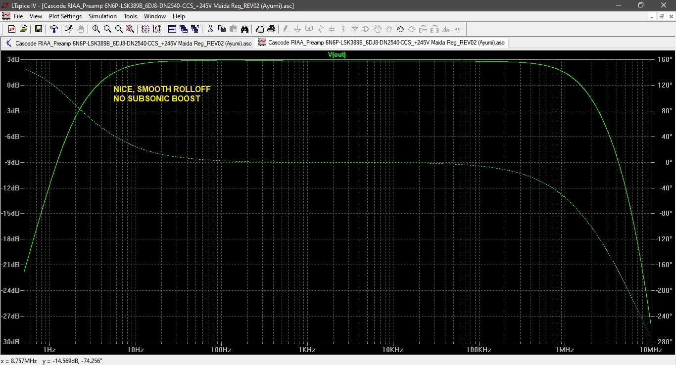

I have an RIAA preamp circuit worked up in an LTspice simulation, with a simulated Maida regulated B+ supply. It all runs fine and looks good. There is practically zero ripple on the plate supply.
The first (input) stage is a 6DJ8-LSK170 cascode, with an RC decoupling network of 2.2k ohms and 100uF for its plate supply.
The second (output) stage is a 6DJ8 with a DN2540 CCS in its plate, or a hybrid mu-follower. It has an RC decoupling network of 1.5k and 100uF for its plate supply.
The frequency response is shown in the first attached graphic. As you can see, the response rolls off smoothly below 20Hz, just like we want it to.
As an experiment, I reduced the 100uF decoupling caps to only 1uF. But... The Maida regulator's output impedance is like 2 or 3 ohms! It'll decouple everything all by itself, right? Well... No. The *audio* output frequency response with the 1uF caps in the decoupling networks is shown in the second attached graphic. As you can see, there's a big, fat BOOM centered right at 10Hz. Imagine what that would do to the cartridge/tonearm resonance! Wow. That's horrible.
I think what's happening is that the impedance phase reverses completely right at 10Hz. Since the amplifying stages invert, one is reversing 180 degrees and the other is reversing phase another 180 degrees again, to bring it back to 360 degrees (0 degrees) -- and now we have subsonic positive feedback. Argh. That's awful.
OK, what if I did the fashionable audiophile-approved thing and used 22uF metalized polypropylene caps in the decoupling networks? Won't that be enough? Well... The results are shown in the third attached graphic. As you can see, there's a shelf from about 3Hz to 6Hz where the response is close to 0dB (referenced to 1kHz) instead of being attenuated. That would cause unnecessary problems with footfalls, rumble, etc. Thoroughly marginal. Not good.
Thank you PRR for making this so clear to me.

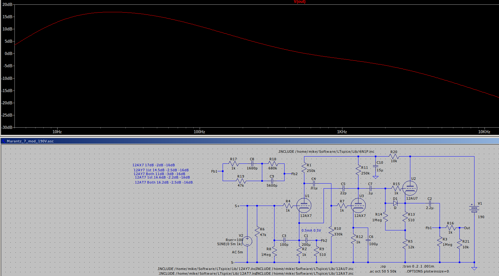

With regard to earlier discussion of 12AX7 Cmiller I suppose that if one has a passive phono stage then just popping in a 12AT7 or 12AY7 in the first stage would be worth a try at the expense of a little bit of gain. In a feedback implementation there would be loss of low bass output but it still might be worth a try. As an example I took a modified Marantz model 7 spice simulation that I have been playing with and substituted the above two tubes in 1st stage and both stages and got the following.
30Hz...1kHz...10kHz
12AX7s: 17dB -2dB -16dB
12AY7 1st: 14.5dB -2.5dB -16dB
12AY7 Both: 11dB -3dB -16dB
12AT7 1st: 16.6dB -2.2dB -16dB
12AT7 Both: 16.2dB -2.5dB -16dB
G-P capacitance mu
12AX7: 1.7pF 100
12AT7: 1.5pF 60
12AY7: 1.3pF 44
So for FB types 12AT7 has pretty small impact on bass response and would be worth trying first I think. 12AY7 is starting to make a likely quite noticeable reduction in low bass but has much lower capacitance. Again for a passive design I think that neither is likely to have a very noticeable impact on response just a drop in overall gain. Cheap and easy thing to try.

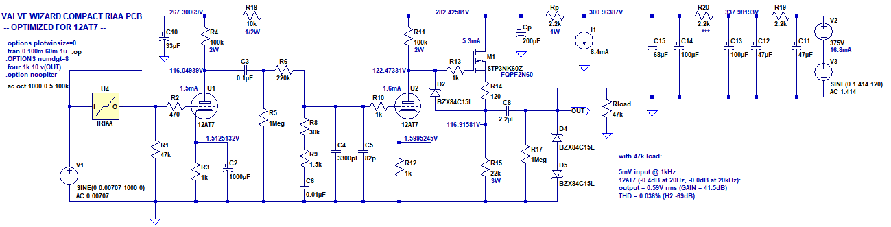

I have a spare pair of these audio PCBs, so I'm going to stuff them with an 'optimized for 12AT7' version of the audio circuits. LTspice predicts very good results, and still compatible with 12AX7. (12AX7 would have grid bias of only -1.1V, but I've seen lots of people use it that way in phono preamps.)
12AT7 operating points:
Input stage:
Ebb = 260V
Vp = 115V
Vg = -1.5V
Rp = 100k
Rk = 1k
Ck = 1000uF organic polymer
Ip = 1.5mA
Second stage:
Ebb = 275V
Vp = 125V
Vg = -1.6V
Rp = 100k
Rk = 1k
Ck = none
Ip = 1.6mA
LTspice predicts preamp gain of 41dB, frequency response very flat (-0.4dB at 20Hz).
How's that look?
Very cool Rongon. I don't have any ATs lying about but they are cheap enough. May play around with optimizing the first stage for AT and second for AX and see what can be done. IIRC I have some sort of AT cartridge on my TT too. In pushing for gain my sims have a pretty low plate current so I need to play around with operating points to see if I can get closer to the ideal noise current range.

Thanks for sharing that. That's a pretty elaborate feedback EQ. I can't say I understand it, though!
I'm fiddling with the simpler all-in-one-go, passive Lipshitz EQ.

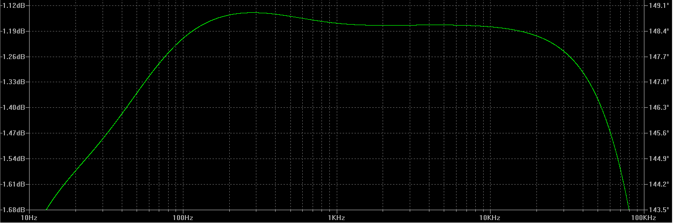

Here's the 'optimized for 12AT7' version of my passive RIAA circuit, along with the predicted frequency response (after inverse RIAA).

Your circuit is quite interesting also. The one I am looking at is basically plagiarized from the Marantz model 7 and slightly adjusted for hopefully better drive capability and lower B+ (limited supply of power trannies on hand). I initially picked it because I have tons of 12AX7s of various types and I thought the FB type might be a bit more forgiving and independent of the particular tube condition and characteristics.
I have to go back to work next week so may be a while before the solder flies.

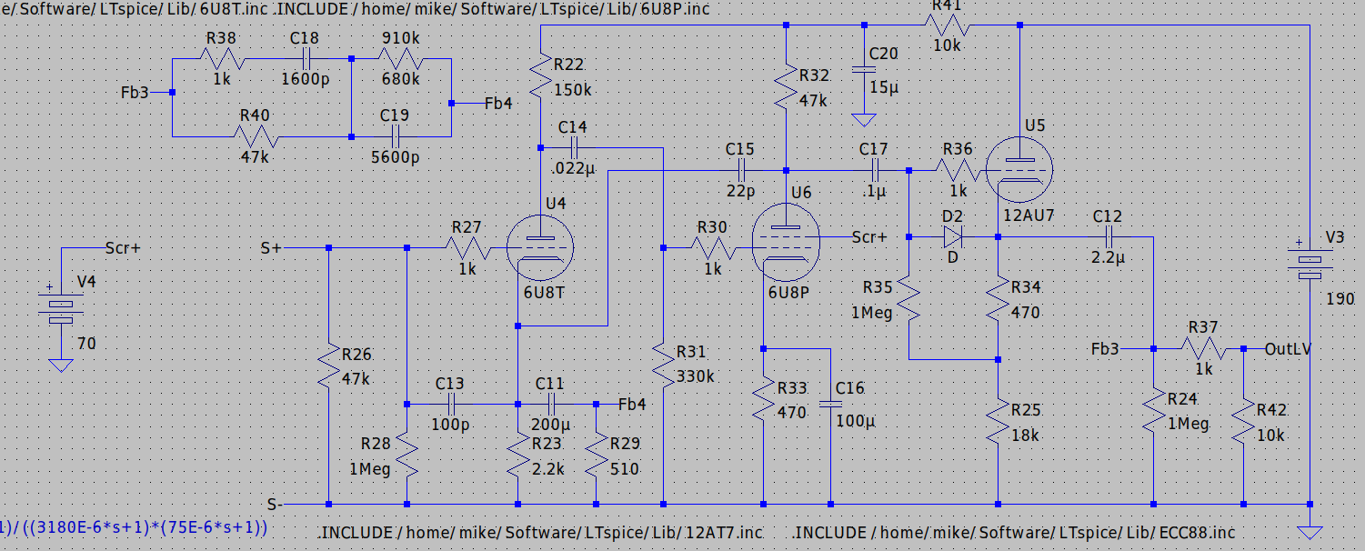

Another possibility that intrigues me is to use a medium mu triode (thus lower Cmiller) and a small signal pentode instead of two high mu triodes. There just happen to be several such things in a single bottle.
This is a picture of the idea based on the above Marantz circuit. Note this is not an actual design but just a picture of the idea.
Absolutely!
The trick is to find one with a low-noise, low Cin triode in the bottle with the pentode. Perhaps use the pentode as the input stage, triode second stage? Perhaps if the pentode is a very high-gm one, triode-wire it by grounding the plate and using the screen grid as the 'plate'.
People like to use the 6F12P for phono preamps, but the triode (and the trioded pentode section) have very high input capacitance.
Actually, there are many of those triode-pentode tubes that have something like a 12AT7 for the triode section. That works well enough, in my (newfound) experience because the 12AT7 has just low enough Cin to get by with an Audio Technica or similar MM cartridge. (I don't know about Ortofon 2M, but I figure that's similar to the AT carts in the L and DCR departments.)

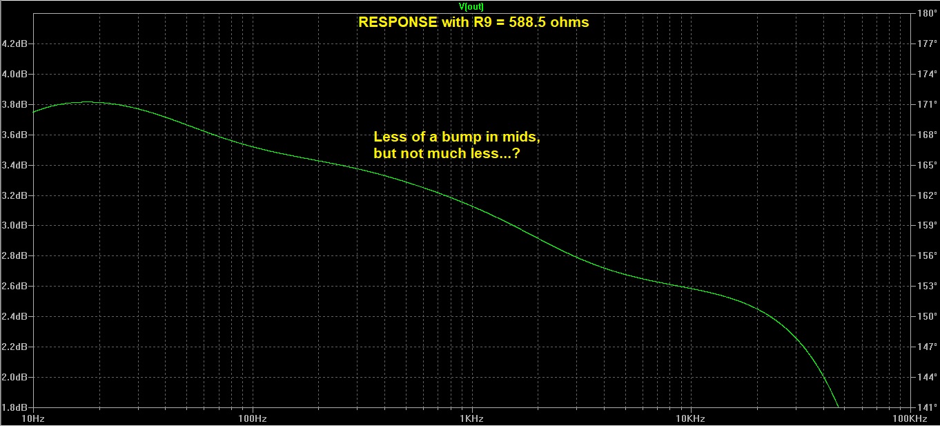

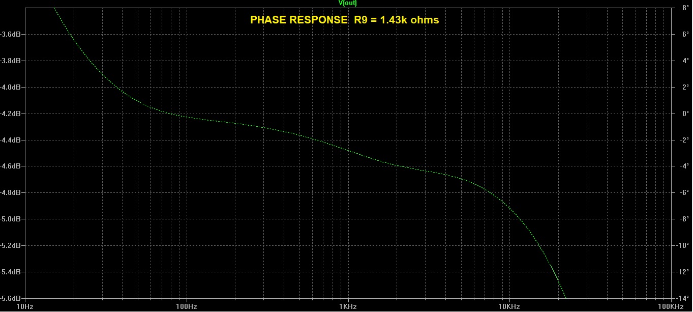

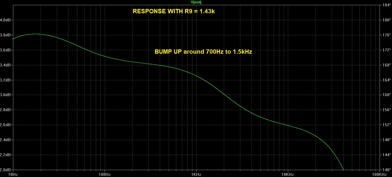

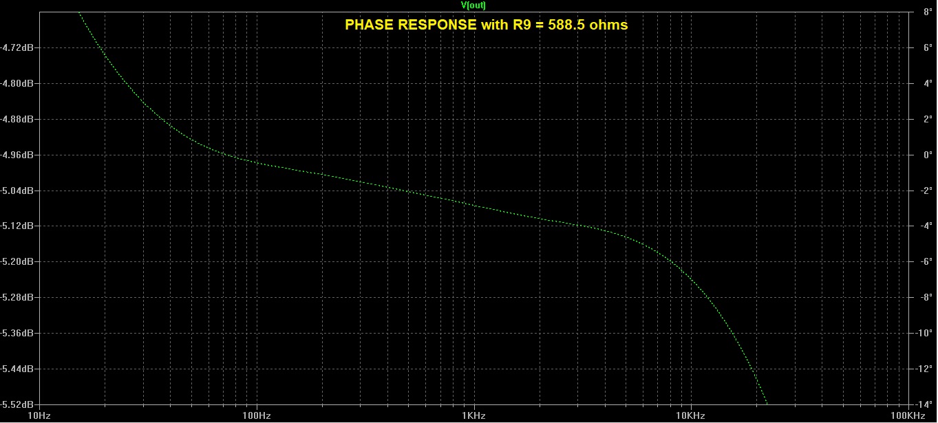

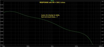

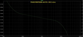

It's amazing how a tiny change of value in the RIAA network can change the perceived tonal quality so much...
Using 12AT7 now in this preamp.
I had R9 as 1.43k, which according to LTspice will give a very slight boost to output in the 1kHz region.
I put 1k ohms in parallel with R9 to make 1.43k//1k = 588.5 ohms
- Predicted frequency response changes hardly at all in LTspice.
- Perceived change in tone quality on playback is that it's now much brighter, more emphasis on high frequencies. Could this be a result of changes in phase response?
Attached screenshots from LTspice
- Freq response R9 = 1.43k
- Phase response R9 = 1.43k
- Freq response R9 = 588.5R
- Phase response R9 = 588.5R
It looks to me like the frequency response hardly changes at all, but the phase response in the 300Hz to 700Hz range changes a bit. Which one is more correct? The flatter phase response, or the phase response with a slight bump up at mid frequencies?
Are they both horrible? Or is this about what to expect from a passive 'all in one go' RIAA network?
