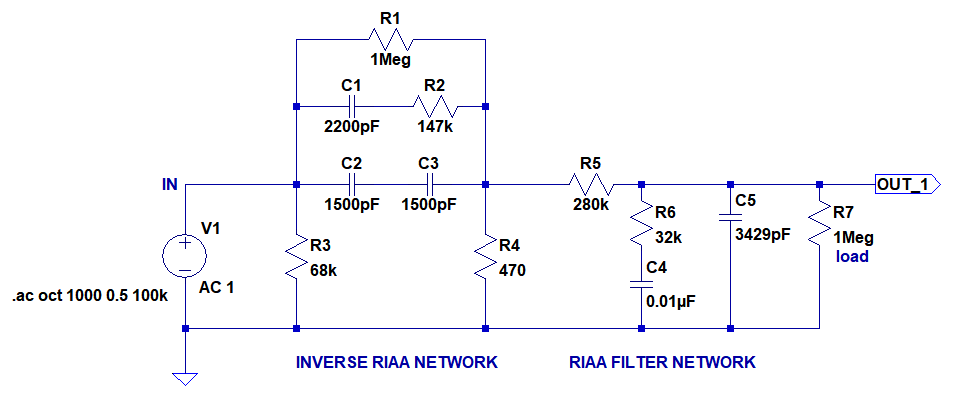

1st image is the circuit I used for the test.
1V signal in.
Inverse RIAA network on the left.
RIAA EQ network on the right.

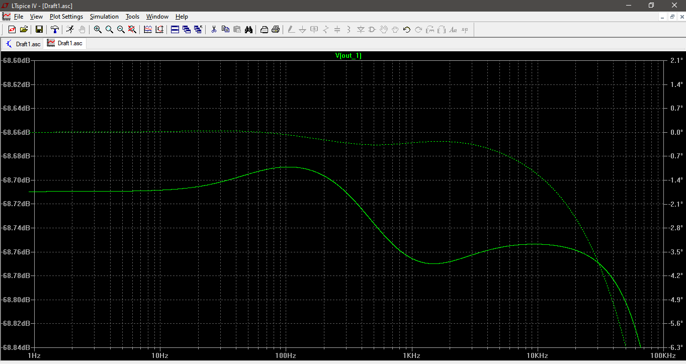

2nd image is the frequency response at the output.
Note the expanded scale!
If I did a valid test, then it looks like this Inverse RIAA network is accurate.
No? Yes?

If you want to compare it against the Laplace thing, you could swap its numerator and denominator. A voltage-controlled voltage source with value
Laplace = (318E-6*s+1)/((3180E-6*s+1)*(75E-6*s+1))
would be a perfect RIAA correction. If you connect that to the inverse RIAA network, the only inaccuracies in the transfer of the cascade of these two would come from the inverse RIAA network.
I'll try turning the Laplace inverse-RIAA upside down and putting it in series with the proposed RC inverse-RIAA at some point.
