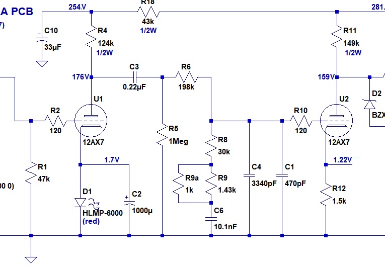

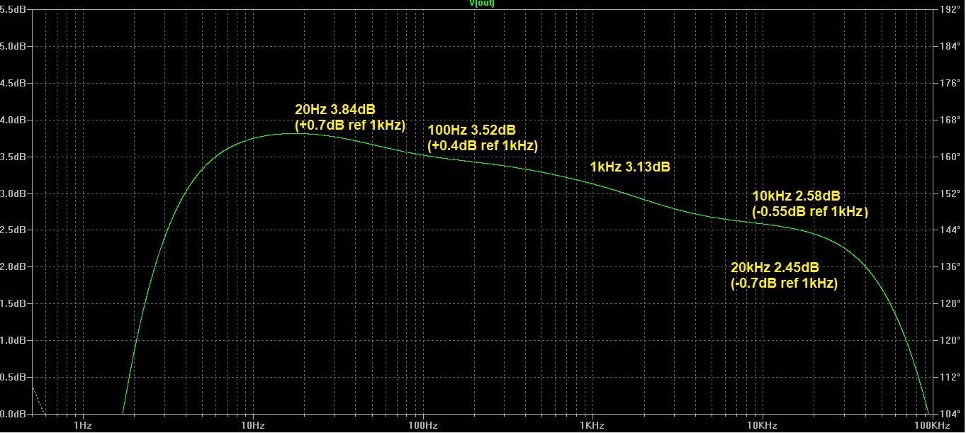

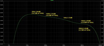

I've attached a schematic and LTspice predicted freq resp of the current 'state of the EQ' in this preamp.
Just wanted to wrap this thread up with the findings from using the KAB inverse RIAA with signal generator and 'scope.
Basically, the real-life output frequency response looks very close to flat, with a slight boost in response in the 100Hz area, and a slight rolloff above 10kHz (looks like as much as -1dB at 20kHz using 12AX7).
Changing the value of C1 (parallel cap from U2 grid to ground) caused very slight changes in high frequency response. Barely observable on the 'scope. Probably difference of -0.5dB and -1dB at 20kHz.
I played with changing the value of C1, deciding by ear alone which I preferred. I found that in this particular preamp, I liked the sound using a 220pF for C1. 470pF sounded too dark. 100pF sounded too bright. The differences were just noticeable on the 'scope (angle of rolloff of HF above 10kHz).
My conclusions:
- LTspice predictions were close to reality. The RIAA EQ came out nearly as predicted, although with ever-so-slightly lower HF response than the simulation predicted. I figure there must be stray capacitances at work in real life that are not accounted for in simulation.
- I prefer a slightly dark sounding presentation. I don't like it when things get too bright.
- Once I got the HF response from the EQ where I wanted it, I enjoyed the sound of the 12AX7 about as much as from 12AT7. They're different, but I couldn't say one is better than the other.
- Listening tests were done using a cheap AT-VM95E cartridge into the preamp. I've since upgraded the stylus to the "ML" version, which made a noticeable improvement in smoothness of the treble frequencies, so the results of my 12AX7 vs. 12AT7 bake-off would probably be different were I to repeat them today.

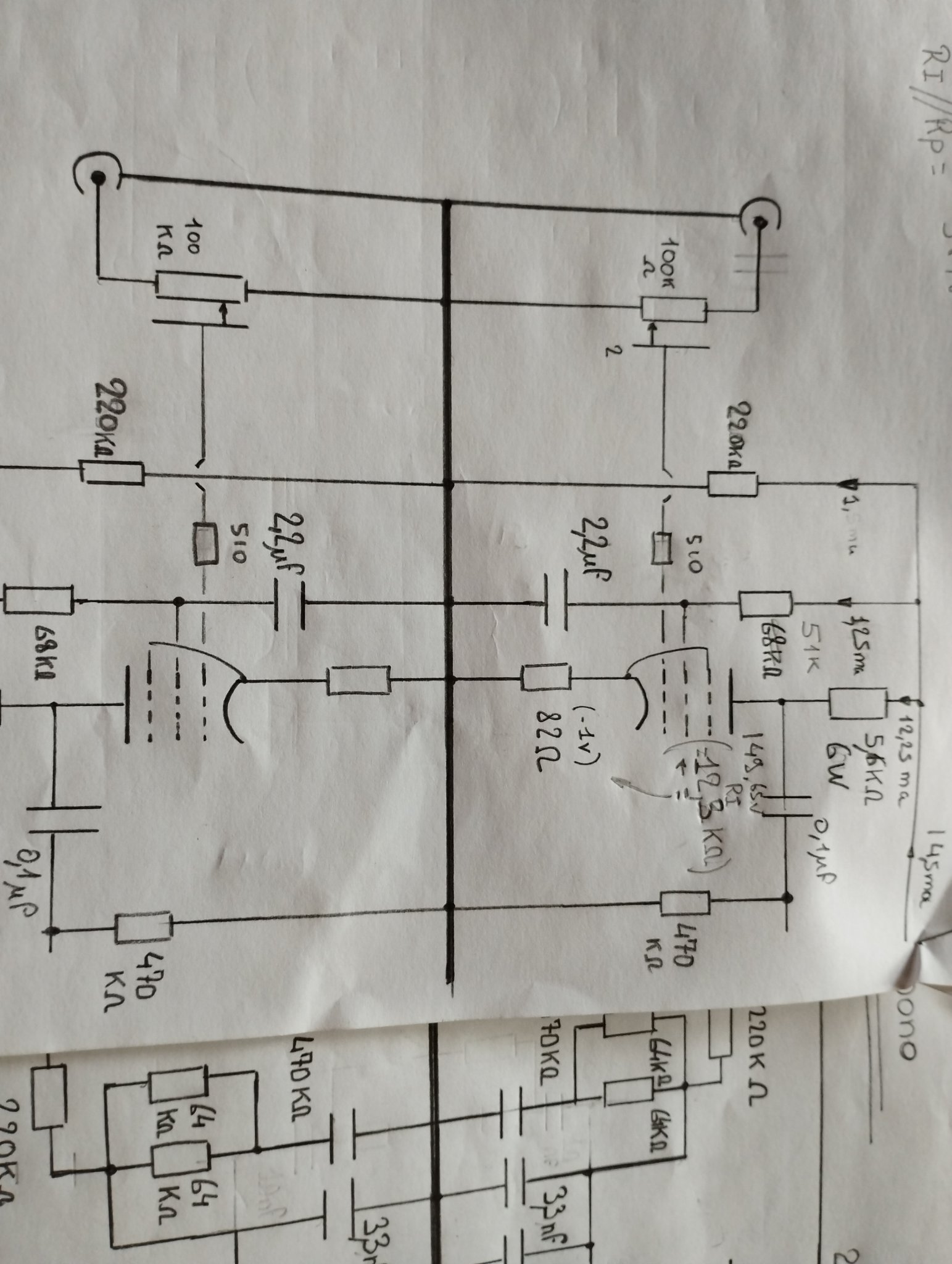

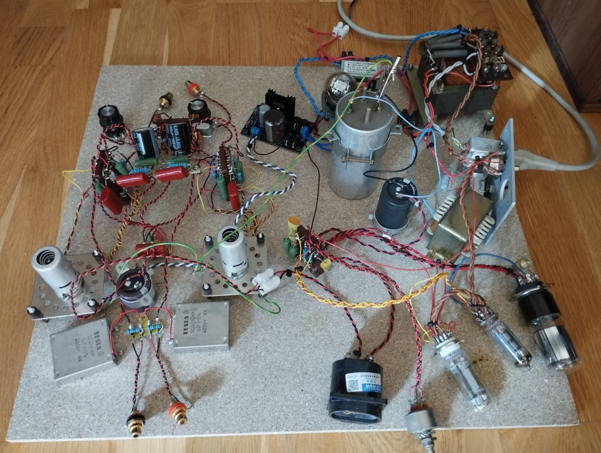

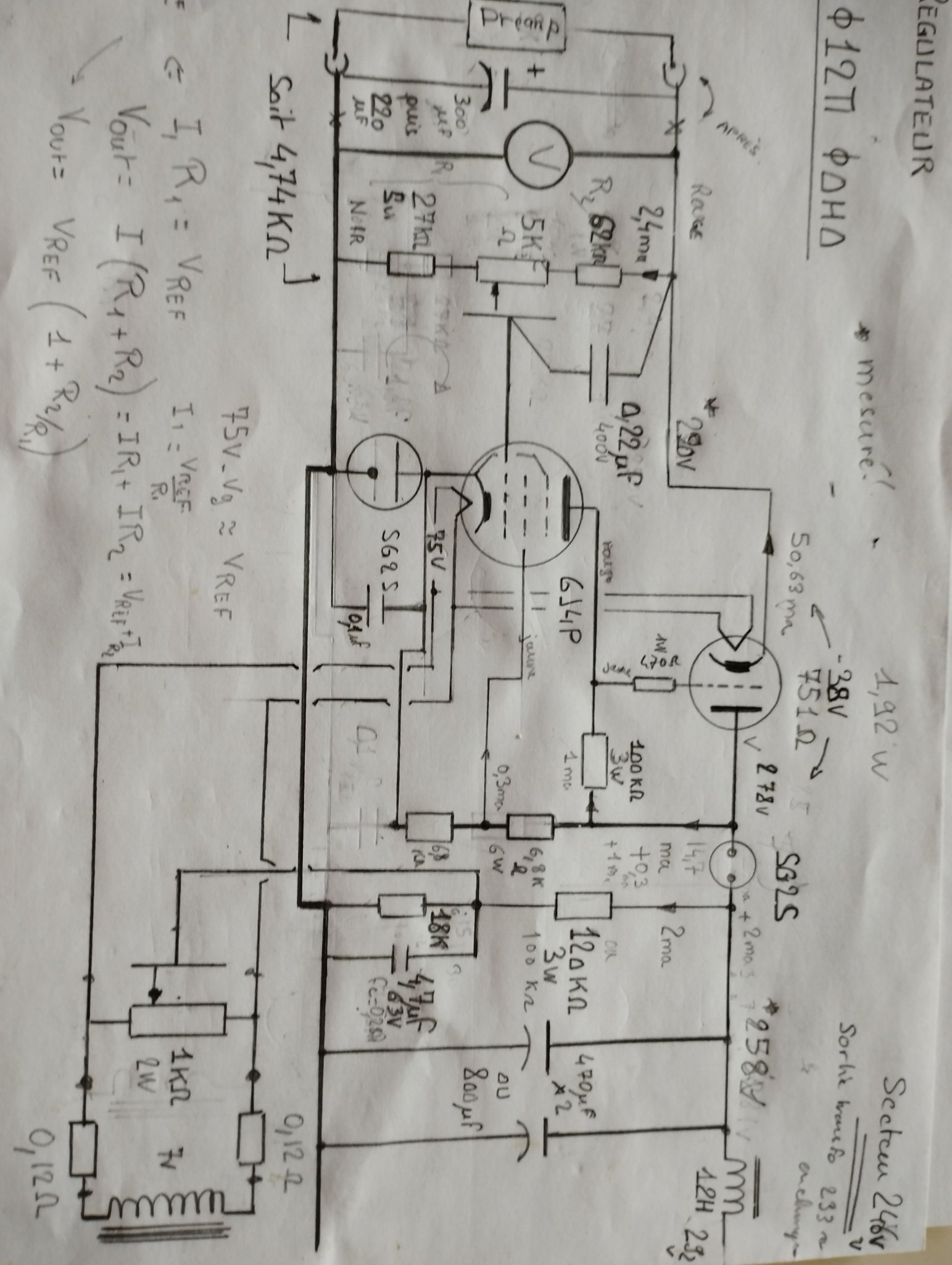

I tried to build a 6f12p phono preamp with a regulated psu.
I plug it to my amplifier:HUM !
Not too surprising. Low level, high gain circuits are too critical for this sort of breadboarding.
You could try it with a lab supply to see if the regulator is a big part of the problem.
But rather than waste a lot of time trying to fix this, just build it in a more proper fashion.
Should i build first my chassis for power supplyNot too surprising. Low level, high gain circuits are too critical for this sort of breadboarding.
"Should i build first my chassis for power supply"
The audio circuit will be the most difficult to lay out, so I would do that first.
You could lay out one mono channel, and just duplicate that for the other channel.
In the mean time, you could do more testing with what you have.
I would try a HV lab supply first, if you have one, to see if the hum is affected.
Otherwise, first verify that your regulated PS circuit is in regulation.
Then if the regulated supply is working ok, determine where the hum originates.
Start at the last audio stage, and ground its grid to see if the hum goes away.
Then work backwards one stage at a time, towards the input stage, doing the same for each stage.

Usually phono stages will benefit from DC filaments.

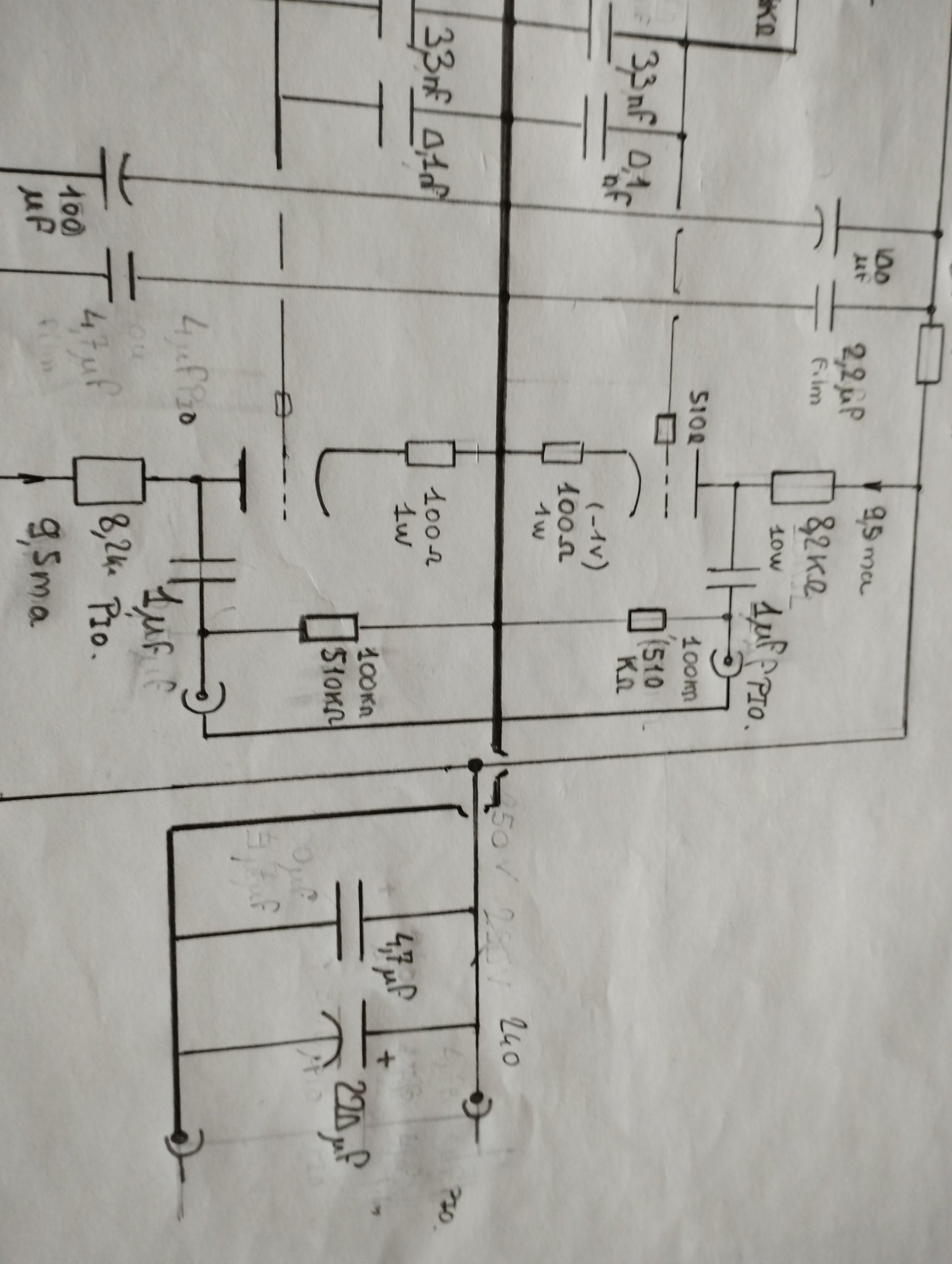

That's a clever screen supply, but you don't want to couple subsonics back to the first stage, so C5 must be very large.
I suspect that 1000uF would not be too large, given that R8 is also shunted by 1/gm of the follower, plus the
screen impedance of the first stage.

Descartes wrotes :divide the difficulty to solve the problem.
Generally the screen is normally bypassed to the cathode, not to ground.

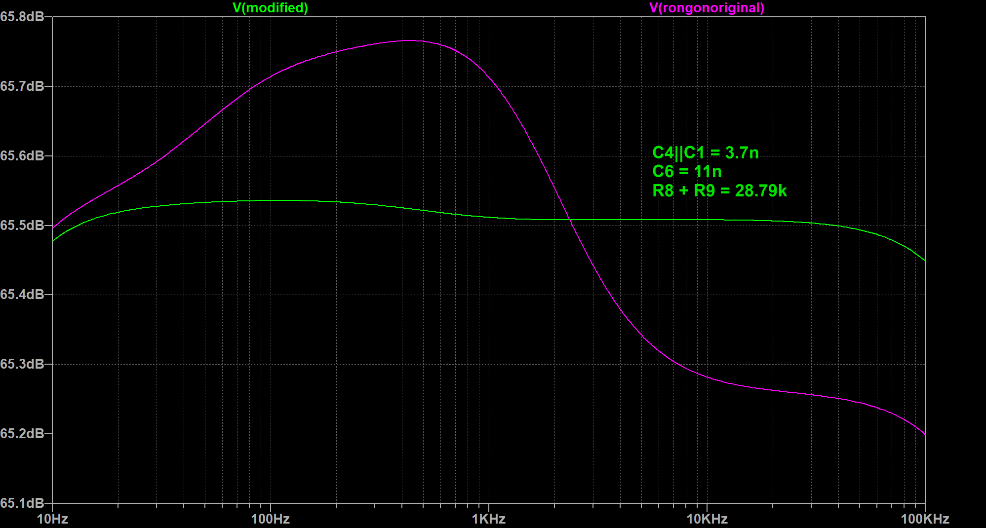

...but for the purposes of analysis I played around with the passive RIAA network values and offer the following suggestions (see picture below).
The issue with high resistance values in passive tube RIAA networks is noise.

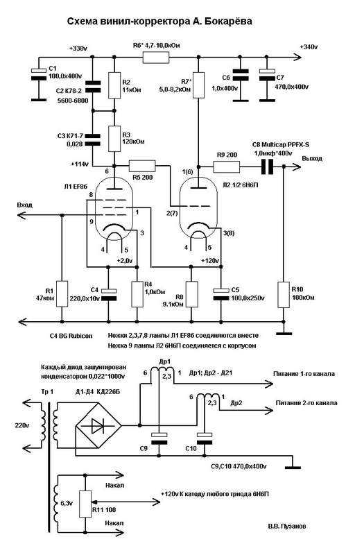

In my experience, an AC filament supply works fine in an MM amplifier when you use an EF86 in the first stage, decouple its cathode to ground with a big capacitor and use twisted and shielded wire for the filament connections.
You are 100% correct. I stuck with the 10.1nF caps I had for C6 and worked around that. The result was close enough for me (and for my brother, who now has that preamp). Your tweaks certainly make it more accurate. Thanks!
When you're working with 12AX7 or 12AT7 tubes on a pre-designed PCB with no follower after the first stage, you're stuck in a high impedance world. Using lower resistances would load down a 12AX7 common cathode stage. Everything is a compromise.
