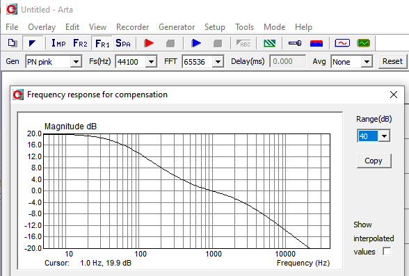

I also have an alternative method for phono frequency response test without hardware anti-Riaa. I load textbook Riaa curve numbers as FR compensation filter in ARTA or alike FFT analysis software. I then run noise from its software generator in a loop from the audio card's output into the phono and back to the audio card's input. The resulting curve includes any deviation of the actual phono curve from a perfect mathematical Riaa model.
How do you load the RIAA curve numbers as FR compensation data?
Set 1kHz at 0dB, then pick a frequency and set it at + or - this or that many dB from 1kHz?
You prepare a text file like those for microphone compensation when measuring speakers and you load it. In Arta specifically has to end with .mic
Yes, you normalize for 0dB at 1kHz.

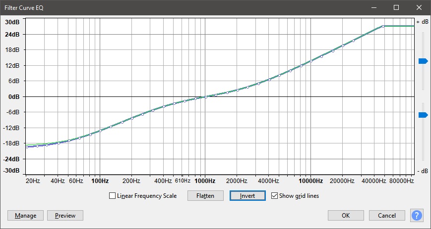

I just found out that the freeware audio editor Audacity has a Filter EQ function with an RIAA preset, which you can invert. I suppose I could make a WAV file of white noise with an inverse RIAA EQ applied, then play that into the preamp, record what comes out, and see how far off flat that is.
EDIT TO ADD:
The feature is buried, but it's there. I was able to create a WAV file of 30 seconds of white noise with inverse RIAA curve applied.
Am I correct in thinking that if I play this (attenuated by a lot!) into the phono preamp, the output should be restored flat response white noise?

That looks like anti Riaa EQ for the software generator. You should be good without pushing invert I guess. In ARTA its a microphone compensation curve. Like when it measures xdB at 10kHz the curve tells it how much it should be pushed up when displayed because the mic is dull.

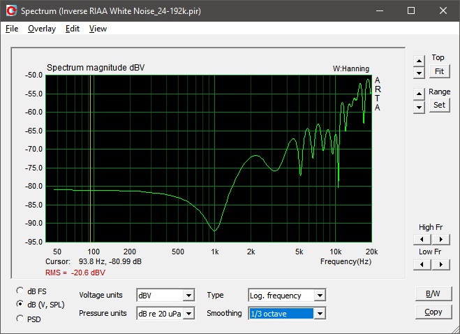

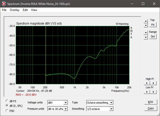

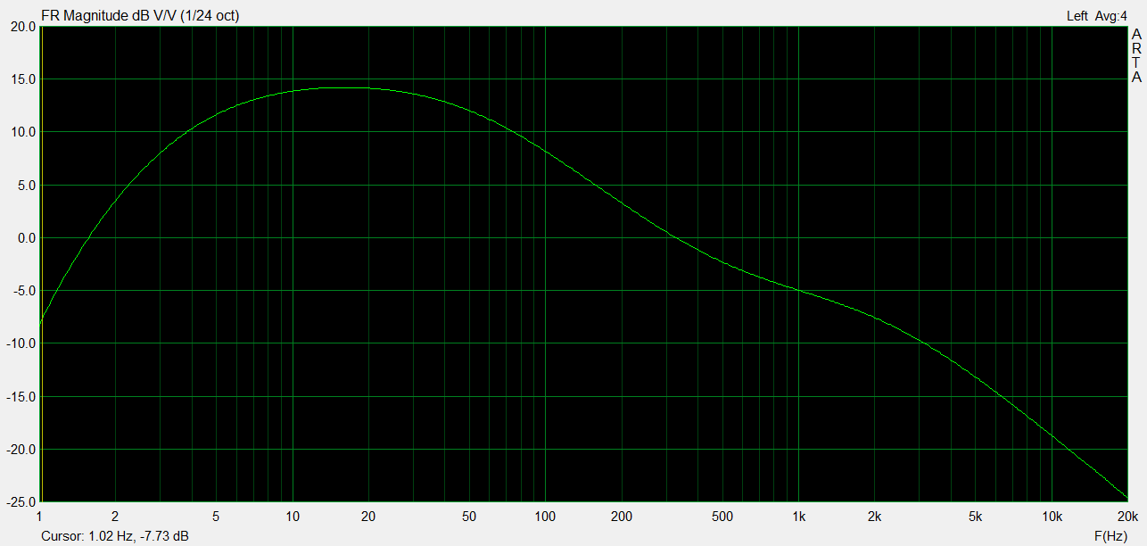

OK, so I ran Arta and did Analysis > Unsmoothed DFT Frequency Response/Spectrum and Single-gated Smoothed Frequency Response/Spectrum, and got what's in these two screenshots.
Not quite what I expected, but it looks kind of/sort of close...?
My thinking is that if you take white noise and play it through an RIAA EQ filter, the highs will be rolled off according to the RIAA characteristic.
If you take white noise and play it through an inverted RIAA EQ filter, the highs will be *boosted* according to the exact *opposite* of the RIAA characteristic.
If I take white noise with inverse RIAA applied and play that into the preamp that applies the RIAA EQ characteristic, if both versions of the RIAA (inverted and normal) are correct, they should sum back to flat response (all frequencies at equal amplitude). If anything is boosted or attenuated at the output of the RIAA preamp then that's the error.
I could record the output of the preamp playing the recorded white noise with inverse RIAA and import that WAV file into Arta, then have it run these frequency response/spectrum analyses.
All this assumes the inverted RIAA filter applied to the white noise is actually accurate. That might not be the case with Audacity's built in effects/filters.
It looks like the computer stuff might be giving too much detail, and showing me its own internal errors. Now I have to think about upgrading my PC sound gear? Will this never end??

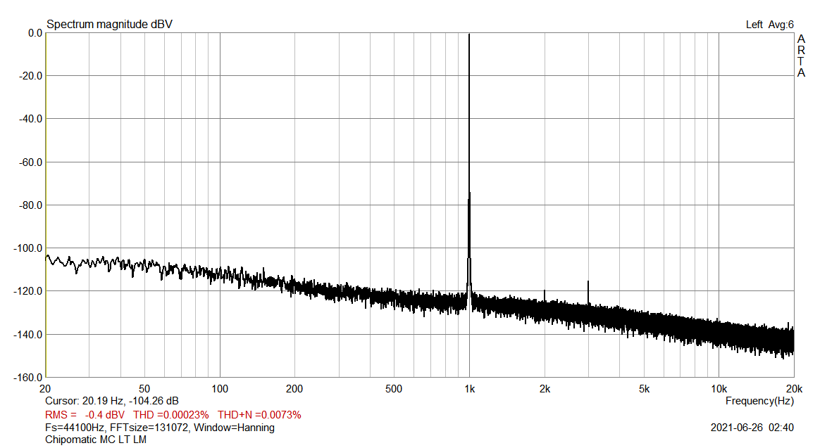

Unfortunately its a mess. Examples from testing a prototype phono of mine on ARTA to know what kind of shapes to look for: A. Phono raw FR (Riaa) B. Phono FR compensated by software Anti-Riaa. C. FFT for Phono at 62dB gain setting and 1V RMS output.OK, so I ran Arta and did Analysis > Unsmoothed DFT Frequency Response/Spectrum and Single-gated Smoothed Frequency Response/Spectrum, and got what's in these two screenshots.
Not quite what I expected, but it looks kind of/sort of close...?--

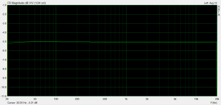

I decided to first try it the old fashioned way, so I bought that inverse-RIAA box from KAB. I have a Tenma audio signal generator and a Rigol oscilloscope. I'll have to finally hook it up and take some measurements.

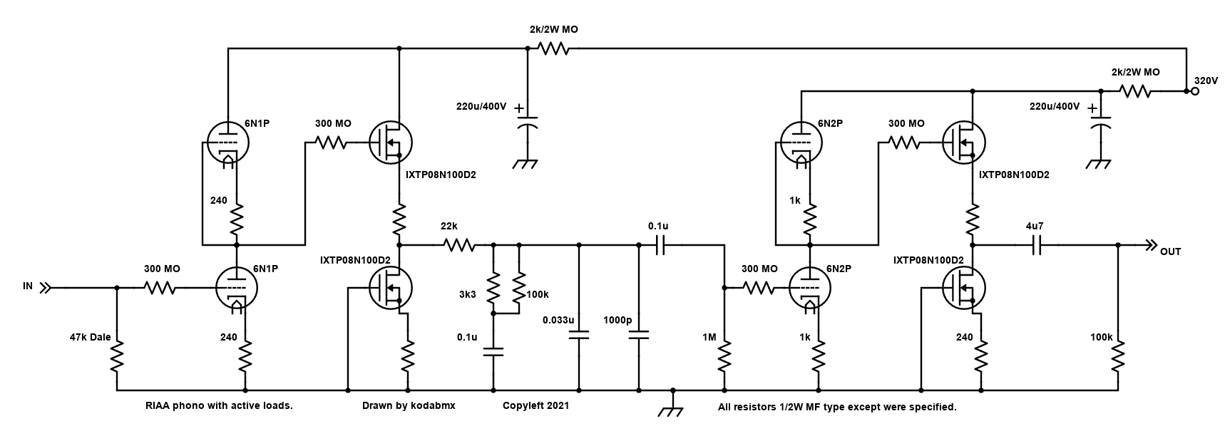

Maybe I'm boring or predictable, but this is my take on making a tube/MOSFET hybrid. The MOSFETs are IXTP08N100D2 - a 1000V 800mA Depletion MOSFET (because I find transistors fragile, I overspec the parts)
TVS gate diodes not shown but you better damned well use them!
If you run the second pair of MOSFETs hard enough, you could drive headphones directly (if you make the 4u7 cap bigger), too!
