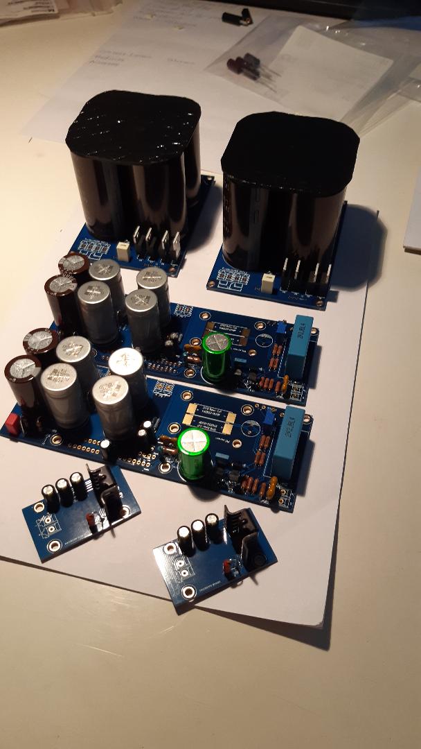

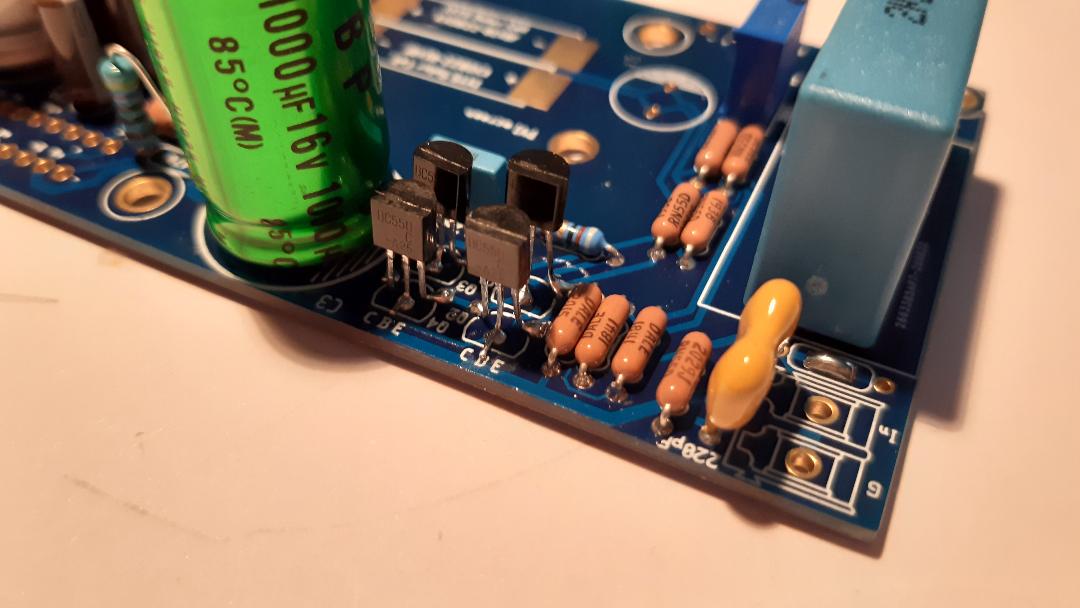

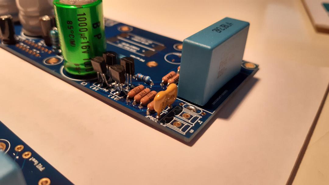

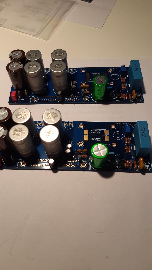

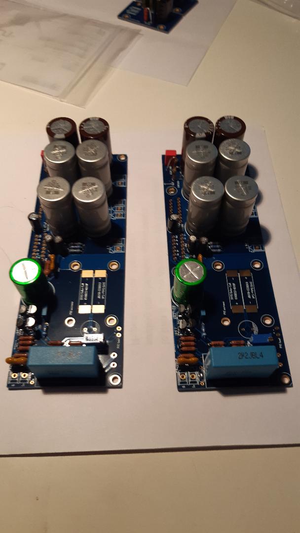

So I got the boards assembled last night! Everything went well, some of the resistore had to be mounted vertically due to space issues.
The one thing that was a bit of a challenge was the transistors....
I have been soldering for 30 years or so and I still had to really concentrate and pull out all of my bag of tricks to get them all soldered on!
The one thing missing is the cap that comes after the solar cells... What value and voltage should that be?
Now I am just waiting on the Leds, Solar cells, and the power trafos. I am thinking about Toroidy as I have had good experiences with them in the past.
Thanks again Jeremy for the great design!!:D

680-1000uf 16vmin, same size as feedback will fit.
Glad you were able to solder transistors. This wasn’t intended for a beginner project. The way I do it is to carefully trim the leads first, pool a little solder on the back leg pad, and try to tin the back leg real quick. Then hold the transistor where you want it and heat the pad, the leg will sit down in the pool onto the pad. You can just just solder the other joints like anything else. It doesn’t feel out perfect but is repeatable.
