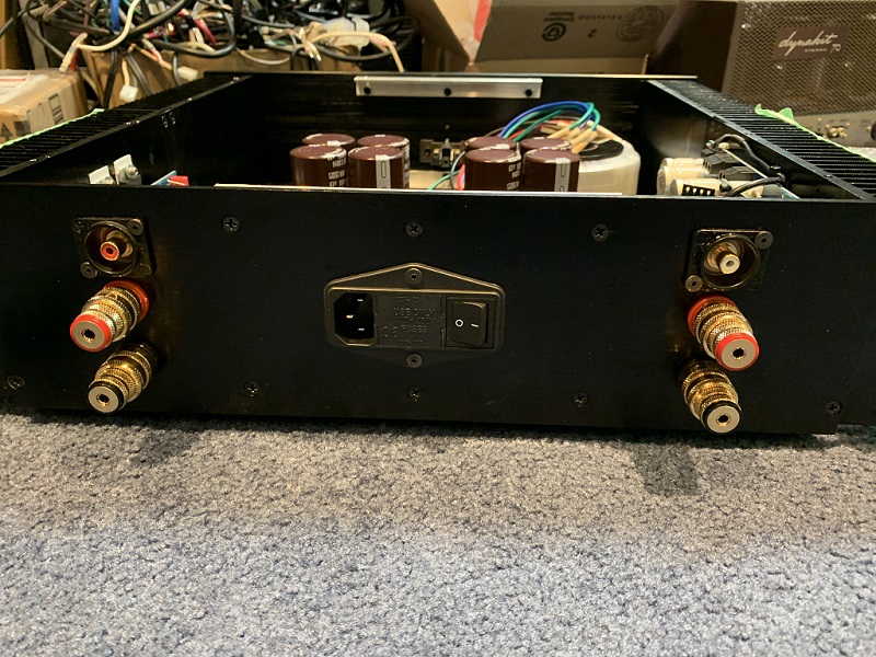

which enclosure was used for this build
im guessing it is the 3u dissipante from diy audio store. If it is is it the 400 or 500mm model?

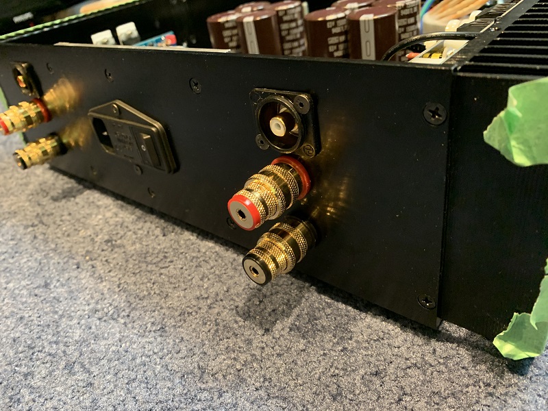

I've been working these past couple weeks assembling this amplifier for sanjeev.
I'm almost done with the build, so I thought I'd share some pictures with you all. Right channel has not been connected yet in the chassis but has been fully tested.
So here's the build so far!

re: Case
It is not the dissipante (which was unavailable during the early days of the pandemic). It was obtained from ebay. There is a link in one of my posts around pinocchio's

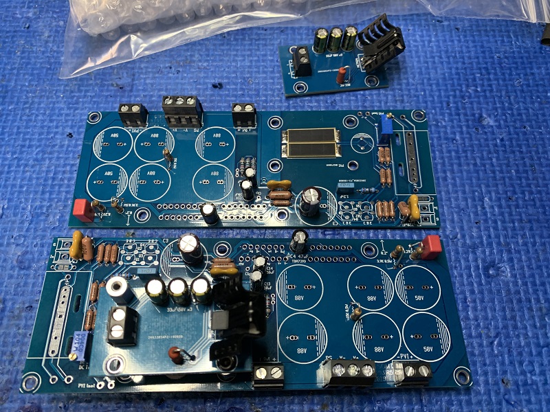

Just started stuffing my boards and have a couple of questions
1) is there a pre setting for the trimmer pot ?
2)pvi board calls for three 33uf 50v caps but the bom had 56uf 50v is this correct ?
