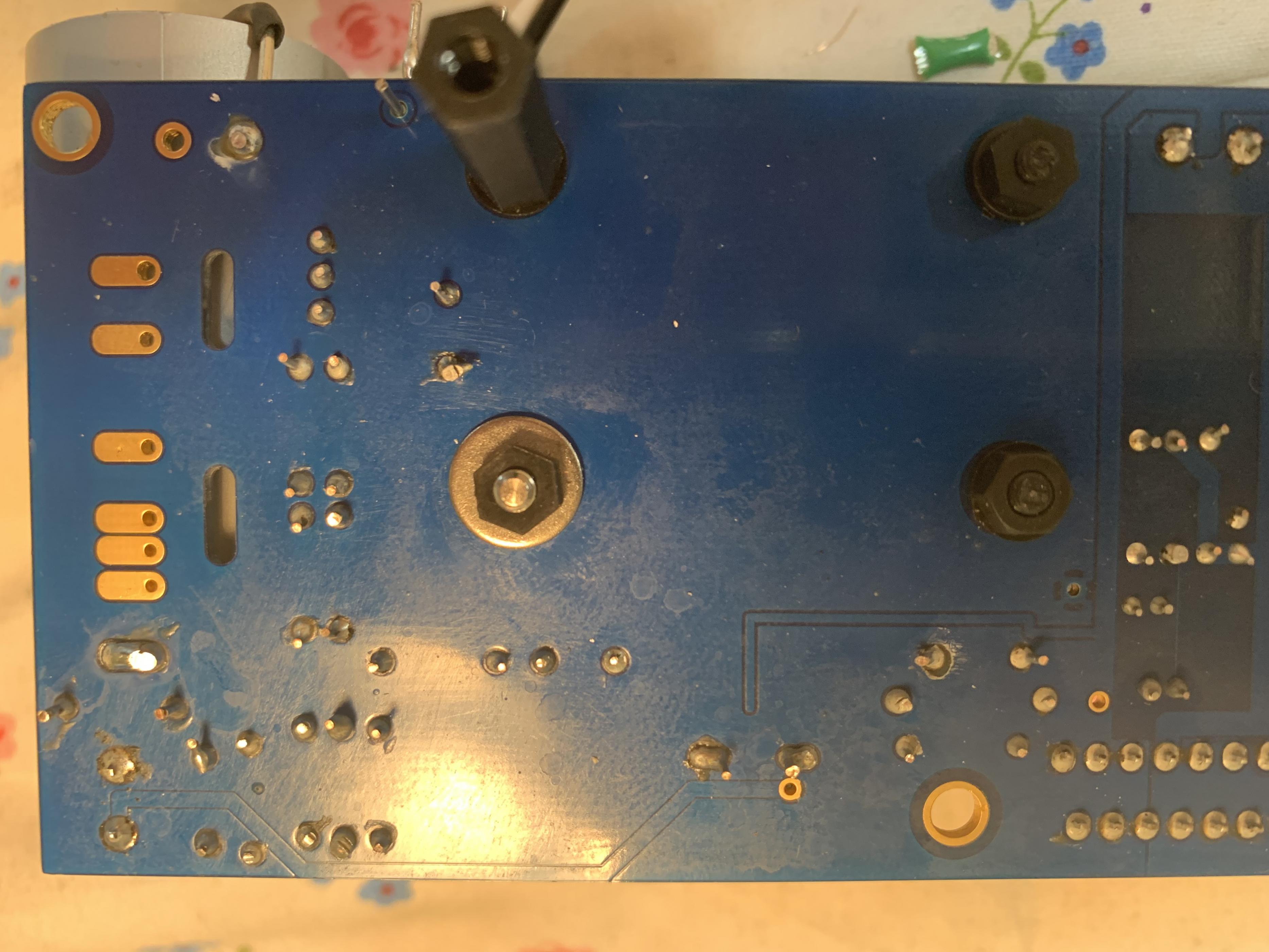

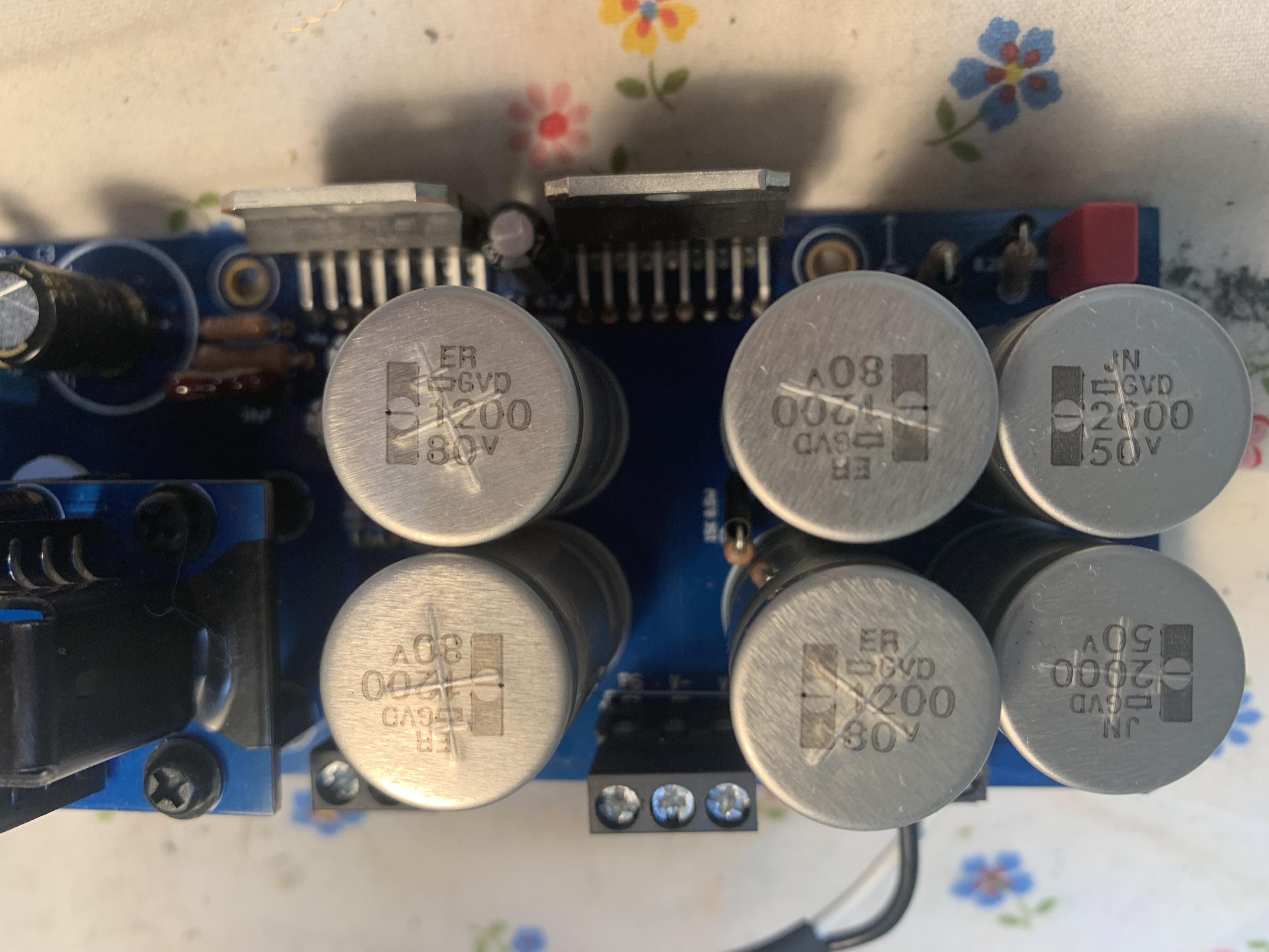

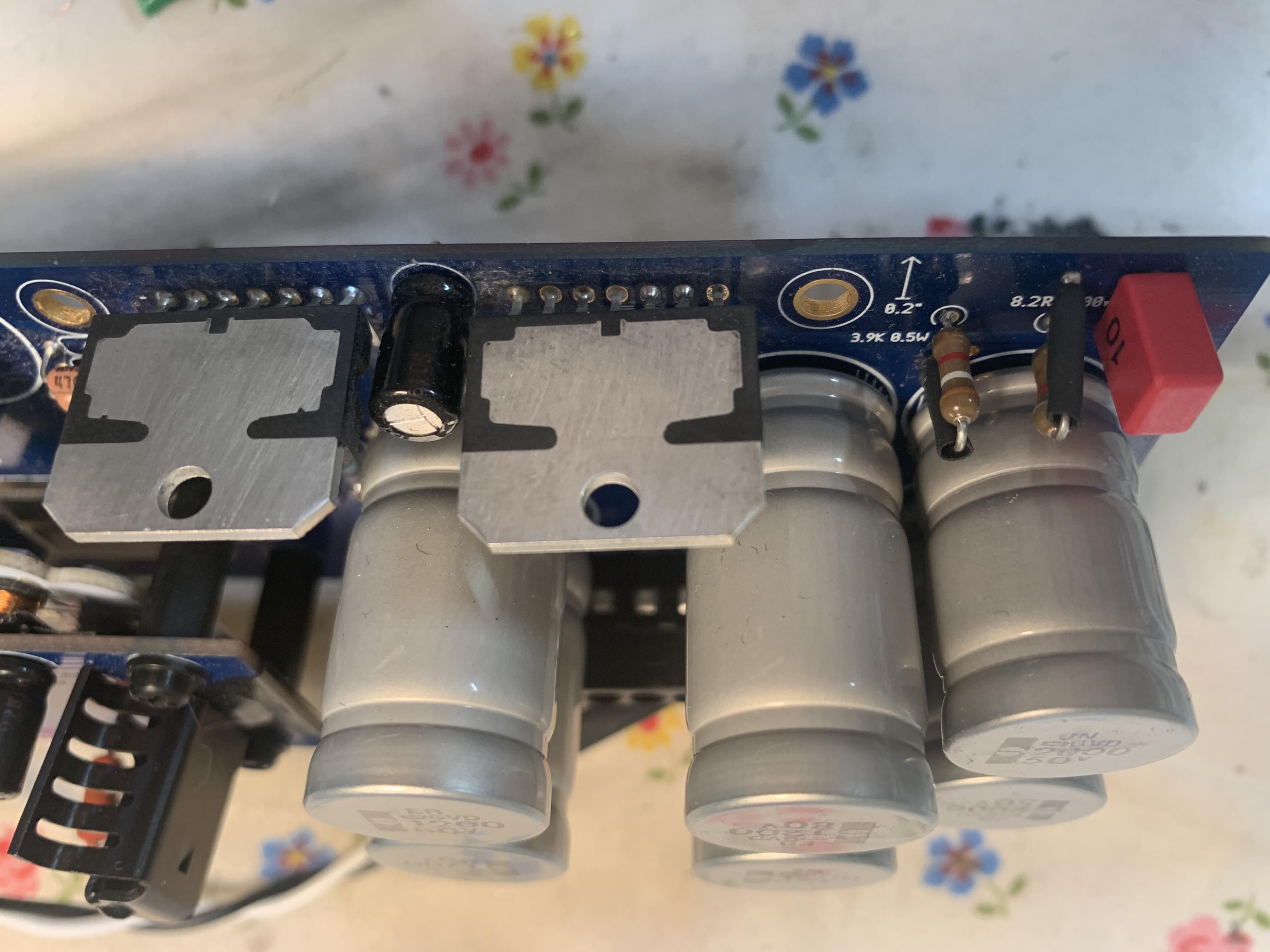

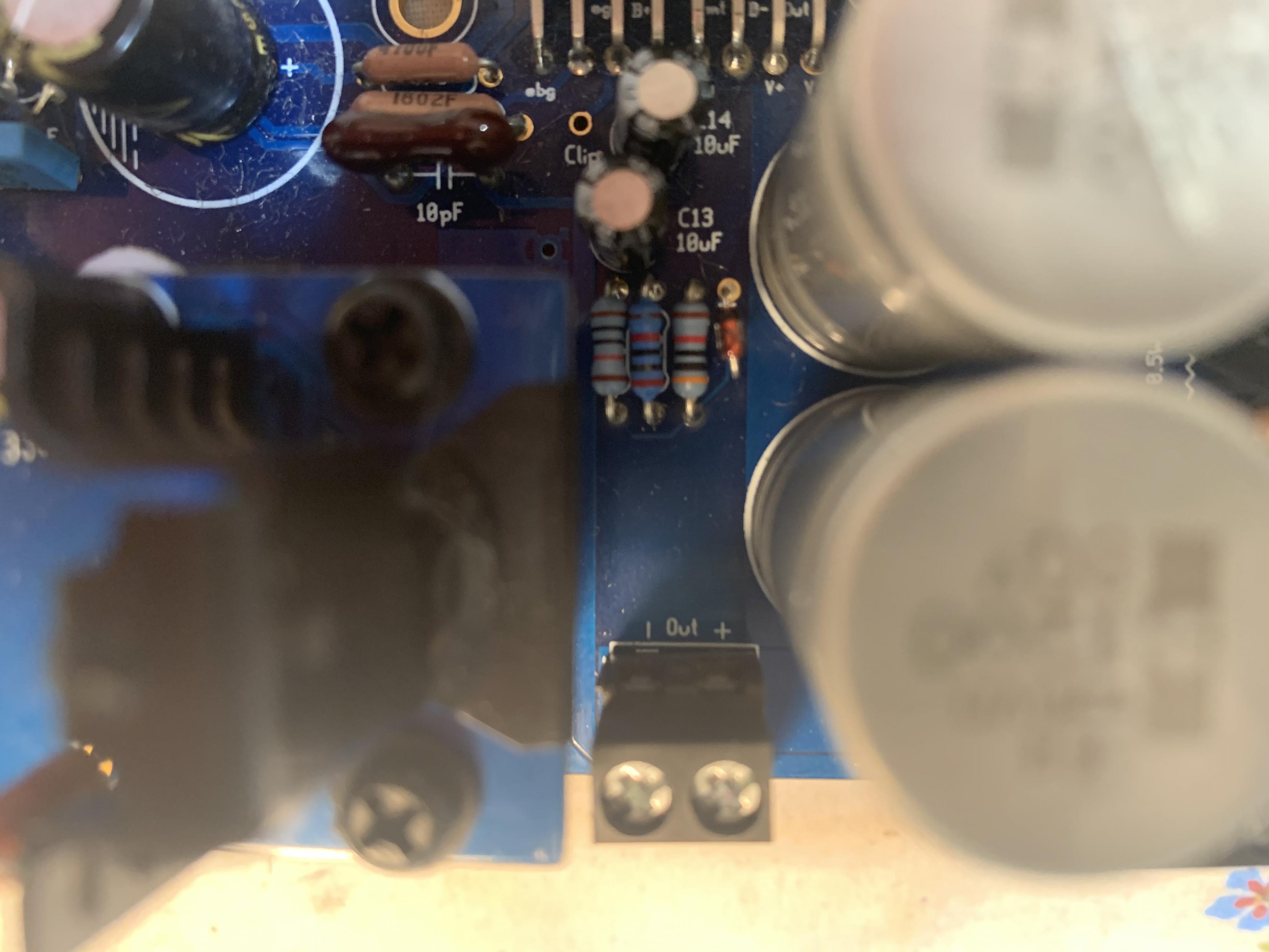

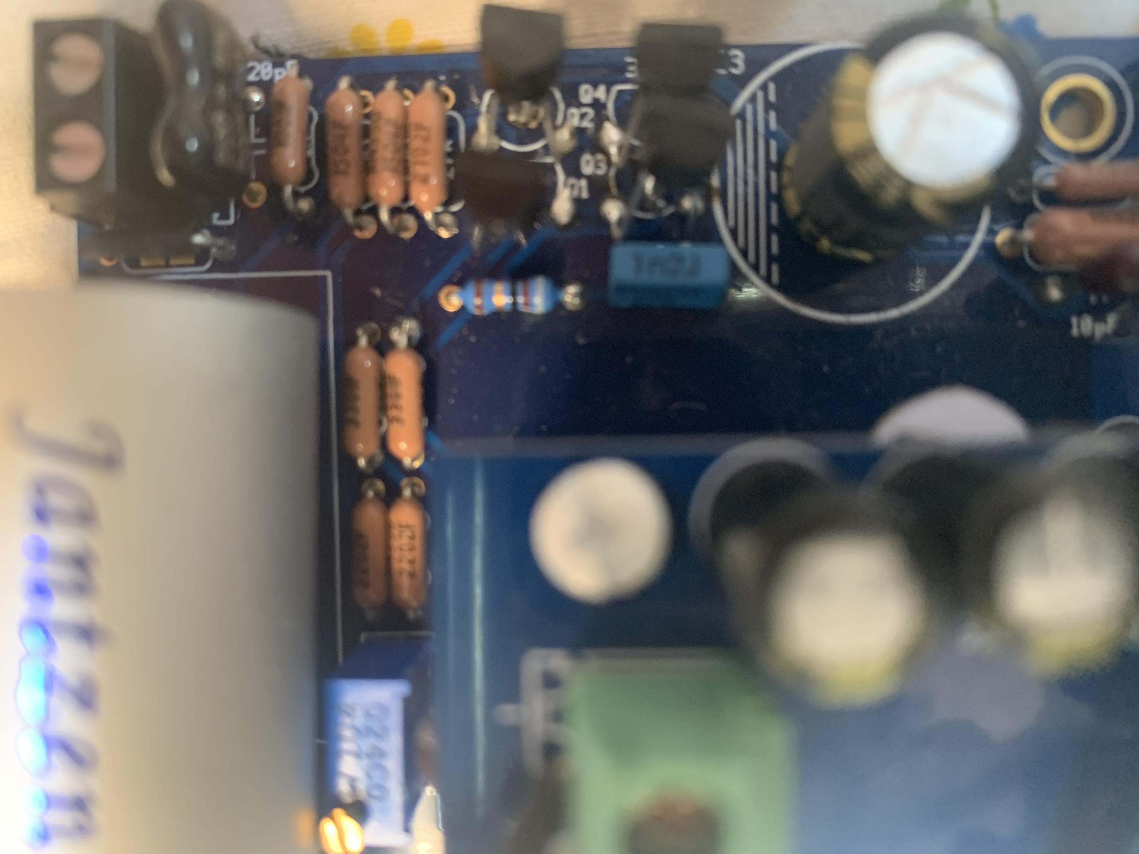

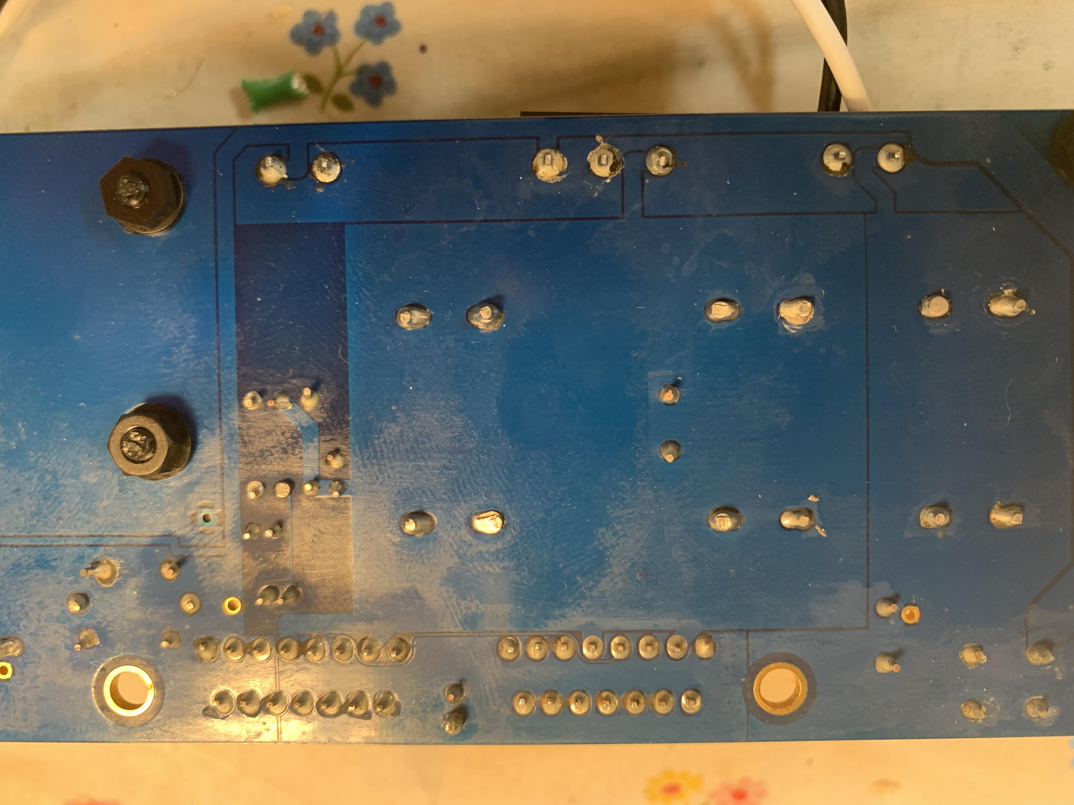

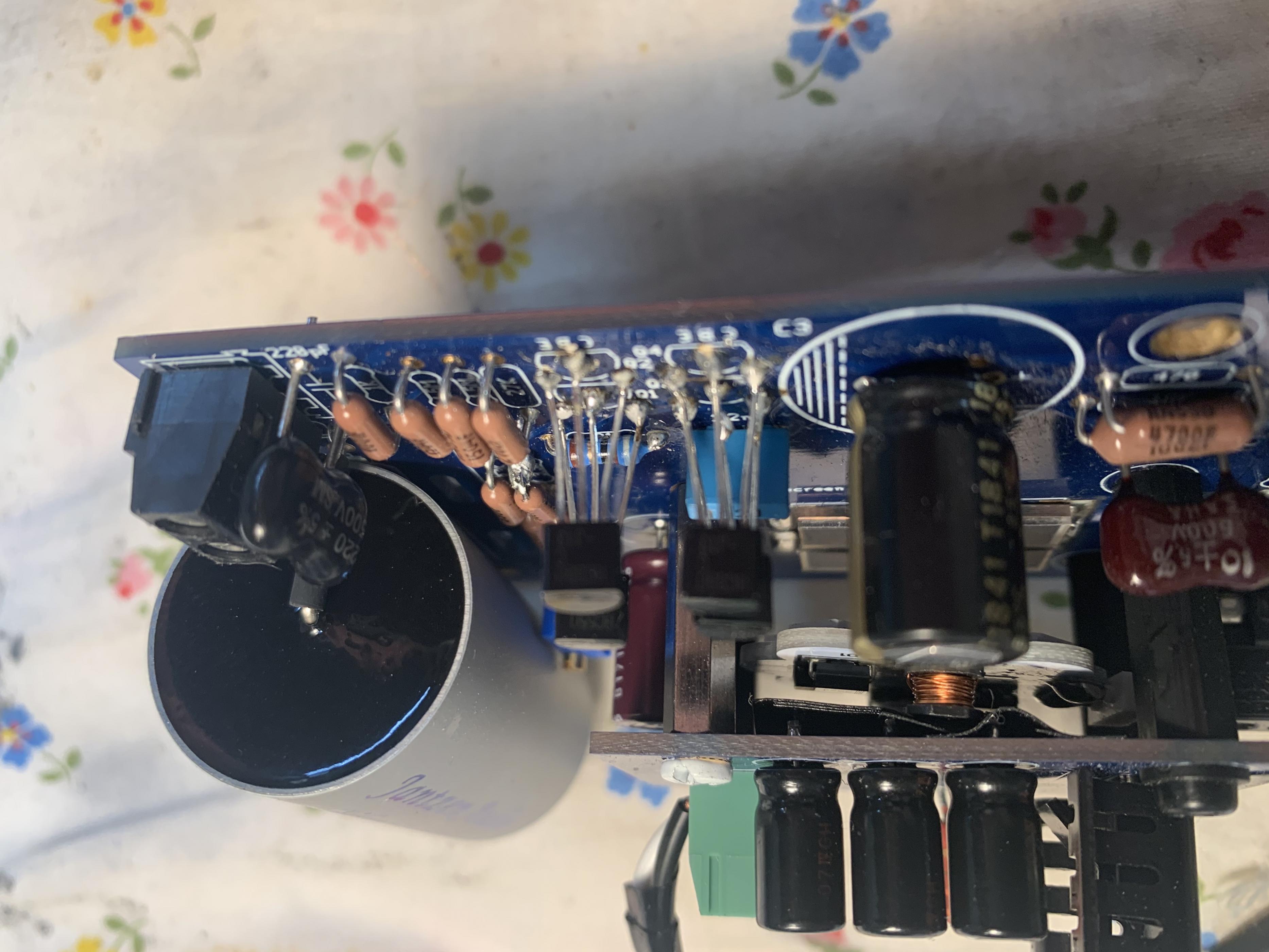

both boards have the same issue
some pics...
after staring at the boards for what seems like hours ,I can't see anything wrong or any bad solder joints . it's strange that both board act exactly the same.
Power supply is a solid 35VDC
Output terminals are at 345mv as soon as I start to turn the variac up and no adjustment from the pot.
Led comes on ok
0 V at the solar cell test points
I even removed the solar cells from one of the boards to make sure I had the polarity correct and it was ok.
Is there a way to check the solar cells while on or off the board ?
I'm really stumped here !
I really want to hear what this amp can do !
