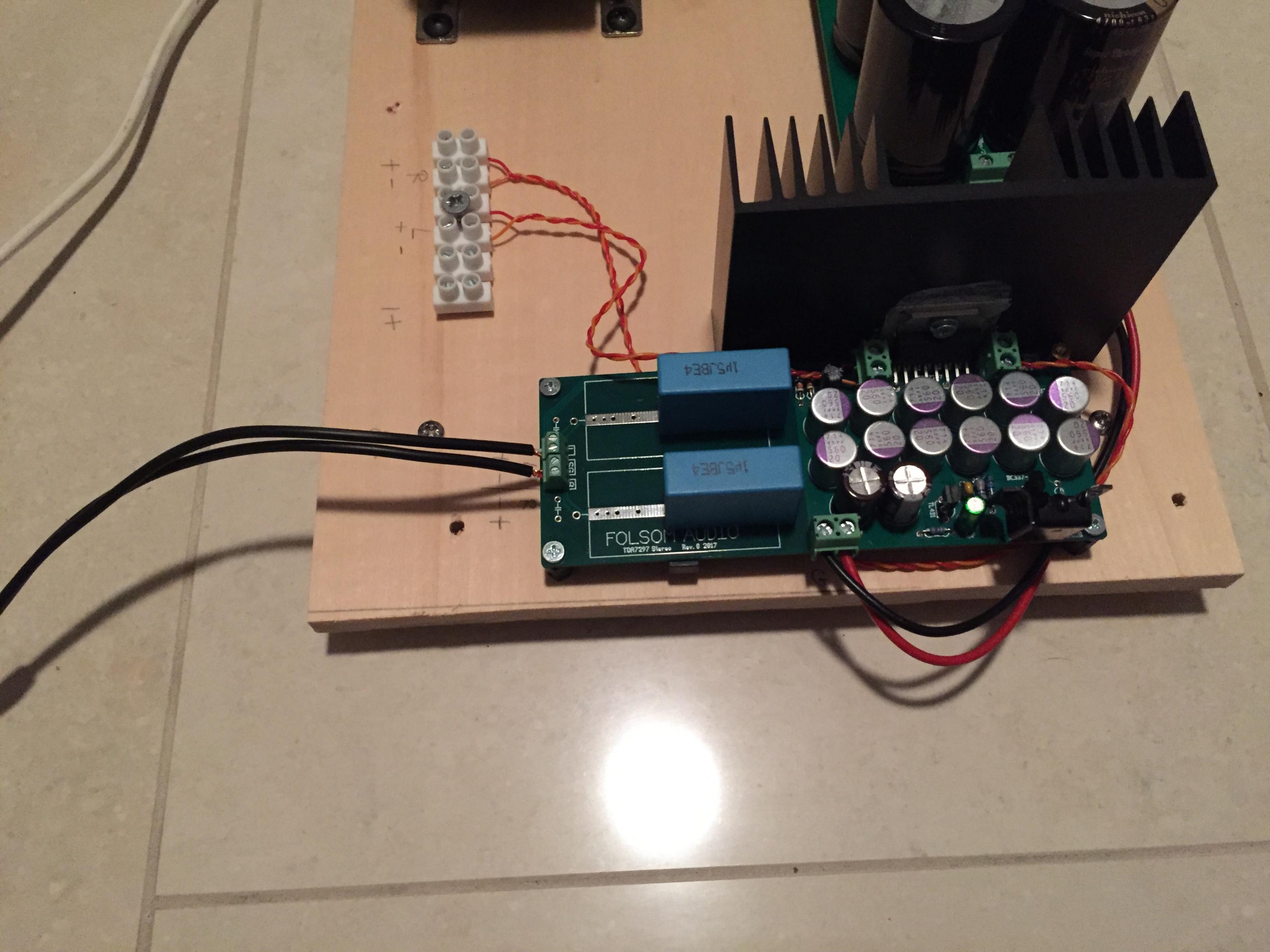

My build: good news and bad news
So this weekend I built my Folsom 7297 Amp and Antipole
The good news:
Everything came together without major issues
I haven't let any magic smoke escape
No breakers were tripped
The bad news:
Hardly any sound from either speaker using my phone as a source. Only when the volume is on maximum, you can hear music very, very softly.
I ordered the standard BOM from Mouser, I only added the discharge resistor 71-RN65D-F-10K. I simply soldered this on to the board, no switch or nothing.
Now, can anyone help me with trouble shooting? I have 18.5V AC coming into the Antipole, but I do not get a consistent DC voltage coming out of it (I assume the rectification takes place within the Antipole).
I have attached some pictures of the current status, in the trial setup.
Any help would be appreciated,
Laurens

Can I get some bottom pictures?
It is possible the epcos naked silver caps are shorting the antipole.
Your input caps are mounted at the wrong end, the blue ones, dont know about the mkp's under it. Basically on the top ones they are connected to the same trace. The very first hole thag is not the inout for wires, is the hole connected to input wires. All proceeding holes are connected to the chipamp.
Thanks Jeremy,
Yeah, now that you point it out, it is pretty obvious the input caps are mounted in the wrong holes 😱. I will start by repositioning them.
For the Antipole, I am now wondering if I actually put my DMM to DC setting when measuring the output...
Will make the changes this evening an post and update plus some pictures of the underside.
Laurens

SUCCESS!!!
Jeremy,
Many thanks for your sharp eye. After I got home I de-soldered the input caps and put them in the correct position, hooked everything up, and...
MUSIC!!!
After you pointed my foolishness out I really don't understand what I was thinking to put them where I did...
The amp has been playing in my living room for about an hour now, and I am really surprised and impressed with what 2 x 15 Watts can do.
