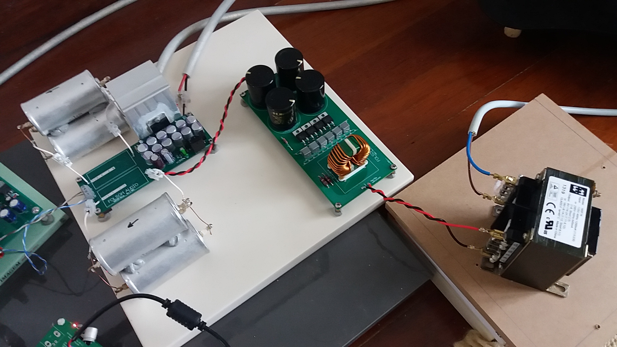

I do have a question about the volume control. My setup is:
Source: Arcam irDAC (Line output level 2.2Vrms)
Pre-amp: Creek OBH-22 passive preamplifier
Power Amp: Folsom Amp standard configuration (all parts from Mouser)
Speakers: TABAQ’s with Tangband W3-871 drivers (8 Ohms / 87 dB)
With this setup I can’t move the volume control past the 9 o’ clock mark without volume level getting too high.
Since the Folsom is only rated at 15 W/Ch, and the drivers are hardly high-efficiency, this is the opposite of what I had expected.
I am on 220V mains, but I am pretty sure I wired the transformer correctly. I have 22.2V DC coming off the Antipole. Heatsink on the chip hardly get warm to the touch.
It does not impact performance at all, but it still makes me wonder: is this normal behavior, or have I messed something up?

It only takes 1.1v to hit full volume at 32db gain, so that sounds fairly normal. Many have reported similar. I'm not completely sure why at times, my 2v CDP I have to turn it up a lot more with 87/db speakers (6ohm).
That's strange, I wouldn't expect that with your passive preamp and 87db speakers.. good thing my preamp has gain settings for 0, 6 and 12db

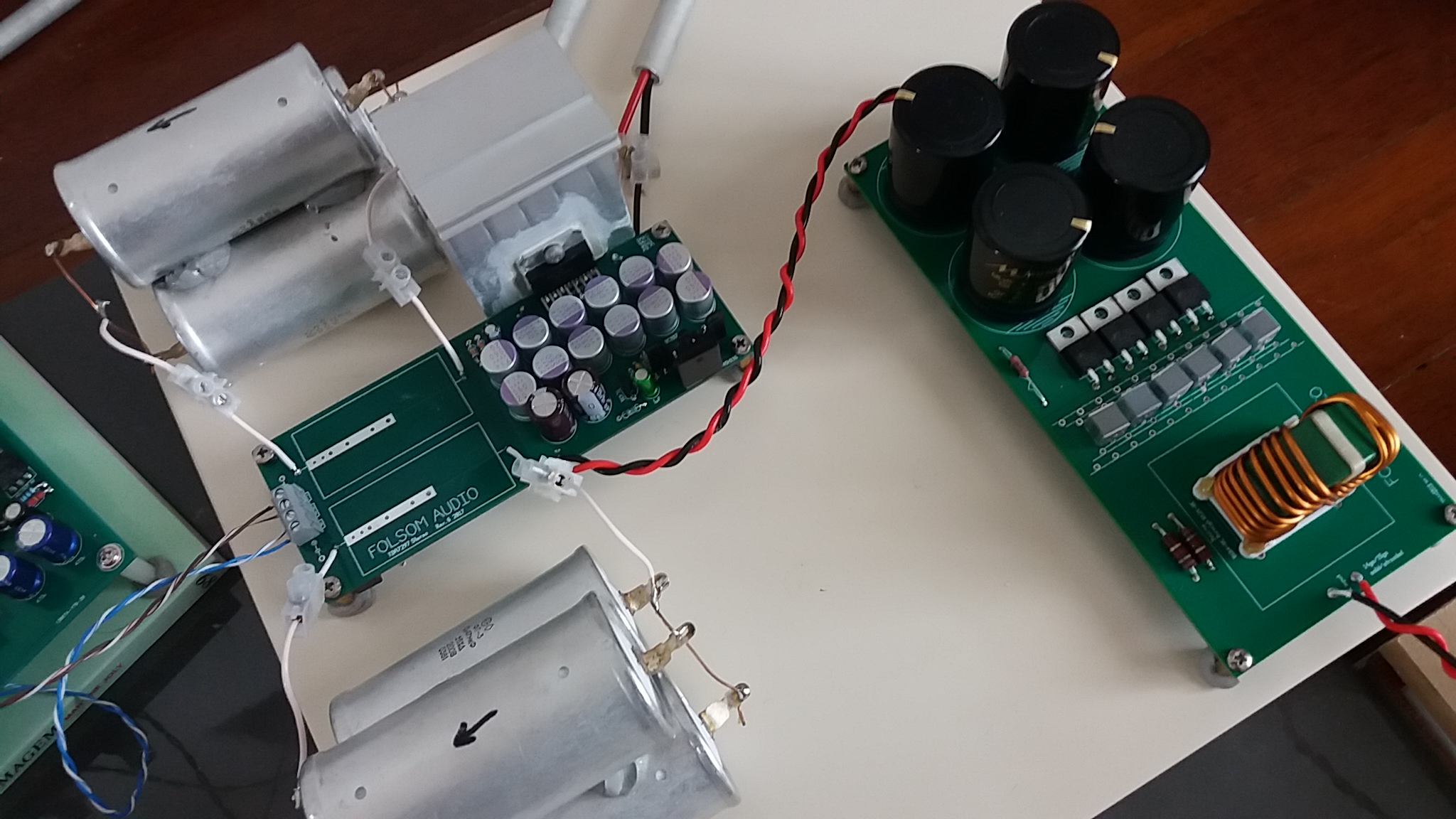

Hello i want to test only the antipole... i have the bleed resistor 10k...
How many volts should i read?
Is necessary some load dummy or i just measure the output on pcb?
Another thing about the input bypass caps. Are really necessary?
You can test the antipole with no load. Just make sure that the voltage on it is down to nothing when you connect it to amplifier.
Voltage depends on the transformer used. If you have 15-16v transformer you should get 21-24v range.
Input bypass capacitors on the bottom of the board? No, not required.
