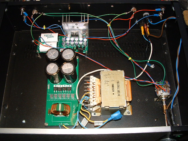

Question about the heatsink. Do you need to secure it to the enclosure or is the single screw at the tda7297 enough to support it?
I guess that depends on how much you move it? It should have the insulating washer and mica to stop continuity between the chip tab and heatsink.
Did you not have the BOM and everything that explained it all?
I have the BOM and your notes. There’s a lot about alignment but no mention of attaching the heatsink to the chassis. Normally i wouldn’t worry but it seems rather large. It’s okay though, I can see what it’s like after it’s mounted to the chip.
I drilled and tapped the HS to attach it to the bottom of the chassis with screws.

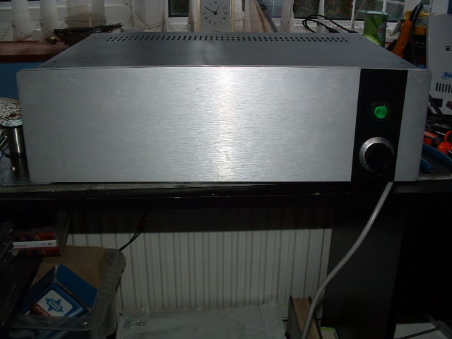

I finished this 2 hours ago I found it a easy build ,it worked without any problems (not all like that)
At max volume no sound coming from speakers I mean nothing I had to switch cd player on to satisfy myself it was on.
The sound is top quality,, makes some of the highly regarded amps on here sound flat plus expensive to make !
I took your advise and got a stepped attenuator off ebay I am converted.
Thanks for giving us this what next you got to make
regards john

Your input signal wires are running pretty close to the transformer. Could possibly pick up noise.

Hello Jeremy,
can you explain a bit technically about rfi and emi interference on the board amp and trafo?
for example i have the trafo on a wood base without a metal case.
is the trafo getting interference from the outside or is the trafo emitting interference for the boards near??
and the other 2 boards? are they receiving external interference or themselves transmit interference or both??

The transformer, if you're using the Hammond 185, doesn't let as much noise through because it has higher loss in the RF range, so the lower voltage noise just doens't make it. So it can still get noise from the AC line going into it, but it transfers less than a toroid without a shield between the primary and secondary (and maybe still better than one with a shield, I don't know for sure).
The transformer doesn't emit RFI, but it does have a field that extends from it - which is comprised of 60hz. The field is there because it's what actually transfers power from one winding to the other, as the wires are not actually touching.
The boards themselves are going to get RFI from the air, since they are not in a metal, grounded, enclosure. But they are very specifically designed to reduce the amount that makes it to the signal. For example noise that does get in from the air or power is attenuated by the capacitors that are on a low inductance set of copper pours. As in they don't have traces, they have low inductance wide areas. Furthermore the section on the amplifier board that regulated voltage also rejects a lot of noise. Explaining that is a bit more complicated, but essentially to the circuit it looks like a big capacitor that doesn't like to feed noise through to the amplifier.
Neither board transmits much of anything. The amplifier board will have the largest fields from the speaker outputs if the wires are not twisted, because higher AC power will be going through them compared to the signal input which has small fields (real nice and small if they are twisted).
It's a good idea not to mix fields, which is why the layouts I've commended do a nice job of keeping wires separate, and keeping the transformers from being next to the amp board itself.
