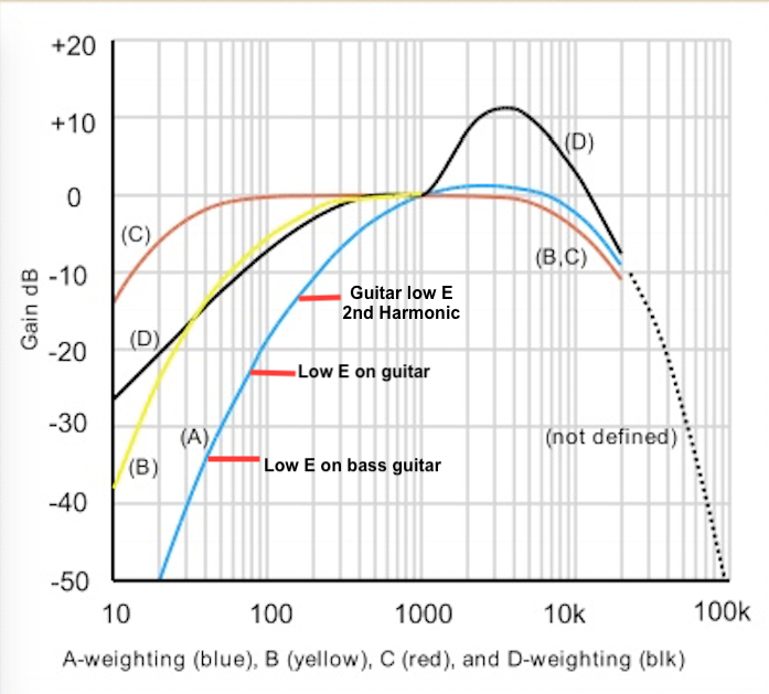

Using "A" weighting on a dB meter, a "huge rich room-filling" guitar may read little higher than a junior size guitar, as frequencies below 1000Hz are rolled off.
On "A" scale, the Low E would read around 24dB below it's actual output, the second harmonic (the main output he hear from the lower notes) more than 12dB down.
Upper harmonics above 8kHz would also read low using "A" or "C" scales :violin:

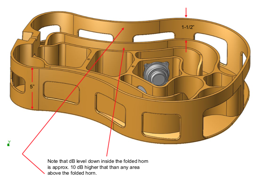

To all my new friends: Art, freddi, PPR, Tubelab, jjasniew and others: thank you so much for your input. I love hearing the truth, good or bad! Not tonight, but later I am going to post CAD pics showing the design, with dB at all areas and driver specs. Maybe I will get lucky enough to have freddi do another Hornresp for me. I need to learn how to use that software. I can do CAD until the cows come home, we all have our strengths and weaknesses. I have some really great sound coming from my wood prototype now, and great volume levels, my goal. As the great Duke Ellington said "if it sounds good, it is good". I have the soundboard, two internal speakers, two five foot long folded horns (now open on top) and (8) ports. I don't know if the open horns can count as collimated sound beams (Art recent post). This guitar proto is a sonic machine, you can feel the vibrations in your body. I equate it now with a car stereo blasting in a car. Nobody can be inside a guitar, so open the windows and the rear hatch, BOOM. I think I was killing the SPL, live and learn. More to follow next weekend. Thanks! Joe

Hello gents - pdf attached showing updated Folded Horn Acoustic Guitar specs. Please provide feedback (no pun intended). I would love to hear from everybody. I will be cutting the full scale entire body soon, as shown. Testing with hard maple partial prototype has given me lessons learned. I have adjusted based on these results, and what I hear. Thank you! Joe
Joe,
Your "folded horn acoustic guitar" has morphed into something quite different from the original concept.
I can imagine you would feel the vibrations in your body very similarly with your prototype as you would if you suspended a pair of the same speakers on a baffle inside an ordinary acoustic guitar, "playing Little Martha at close to highest level".
I don't imagine those vibrations resulting in much usable sound pressure level at a distance in front of the instrument.
What lessons did you learn testing the partial prototype?
