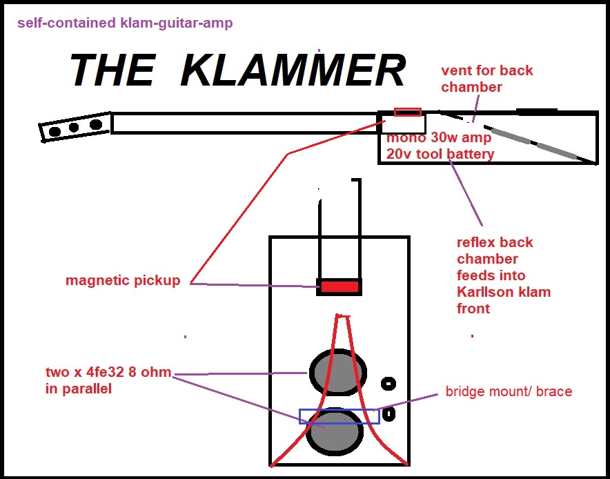

IF I had skills anda one-off, I'd try something goofy with steel strings, magnetic pickup, two Faital 4fe32 in parallel, mono TPA3116 amp with 20v tool battery (not sure how a brace/mount for the bridge might go-?) It would probably feed back to itself too easily unless the aperture were fairly rigid( ?) The neck extension into the body would tie to the back for bracing-dunno if the pickup should be floating or not.

hi Joe K.
regarding that crude sketch, I doubt if there are any guitar with built-in-amplifier using a "Karlsonized" chamber --perhaps none with the "Bo Diddley"
shape body as a self-contained acoustic electric.
Whether its a good idea is questionable-but could look cool.
Figuring out a means to brace and mount the bridge so there's no "bow" would be one thing to overcome---maybe extend a section of the neck all the
way down and to the body as to brace against the body's back and hold the lower strap button (?)

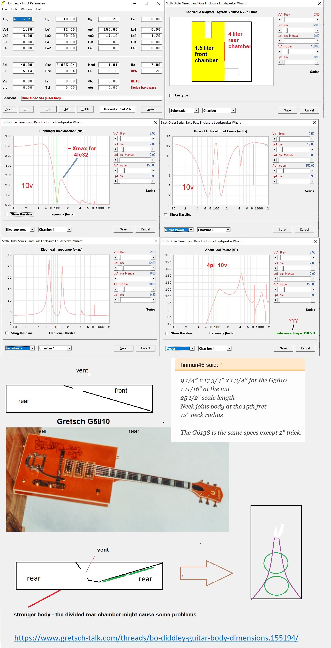

with 10 volts sine, 4fe32 is just hitting its xmax.
It would be easier for sure to do a reflex in a (semi?) hollow than a bandpass.

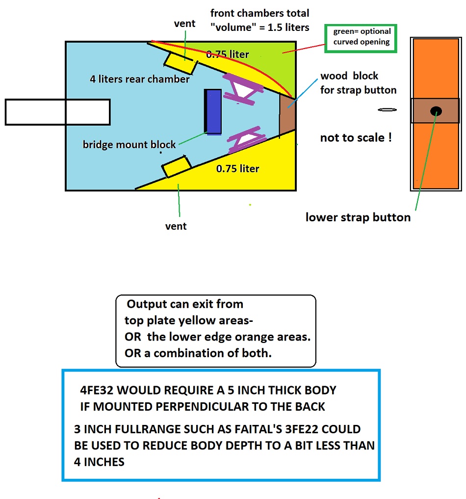

it might work as below
IMO the rectangular would look better with straight "V" vents vs curved.
having exit at thebottom of the body would help reduce reflectionswith top vents only.
with perpendicular mounting of speakers, the body would be awfully thick at nearly 5 inches for a 4 inch speaker
