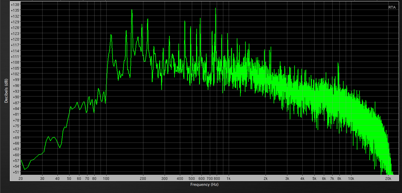

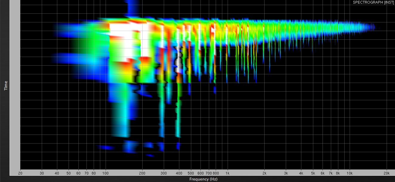

Here are a few screen captures of all six strings of an Ovation Elite, with roughly 20 year old strings strummed open, just captured using the internal mic on a Mac computer, using both RTA and Spectrograph (SMAART software).
The dB scale is not calibrated (it is reading higher than the actual SPL) but the relative response is informative.
As you can see in the spectrograph, the low range takes time to build up, and decays more slowly than the upper harmonics, and the second harmonics of the lower notes are louder than the fundamental frequencies.
The upper harmonic response does not drop steeply until past 12kHz.
With new strings, I'd expect as much as +6dB in the upper harmonics.
