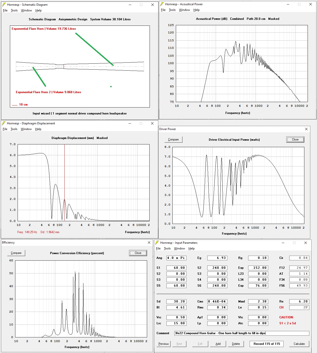

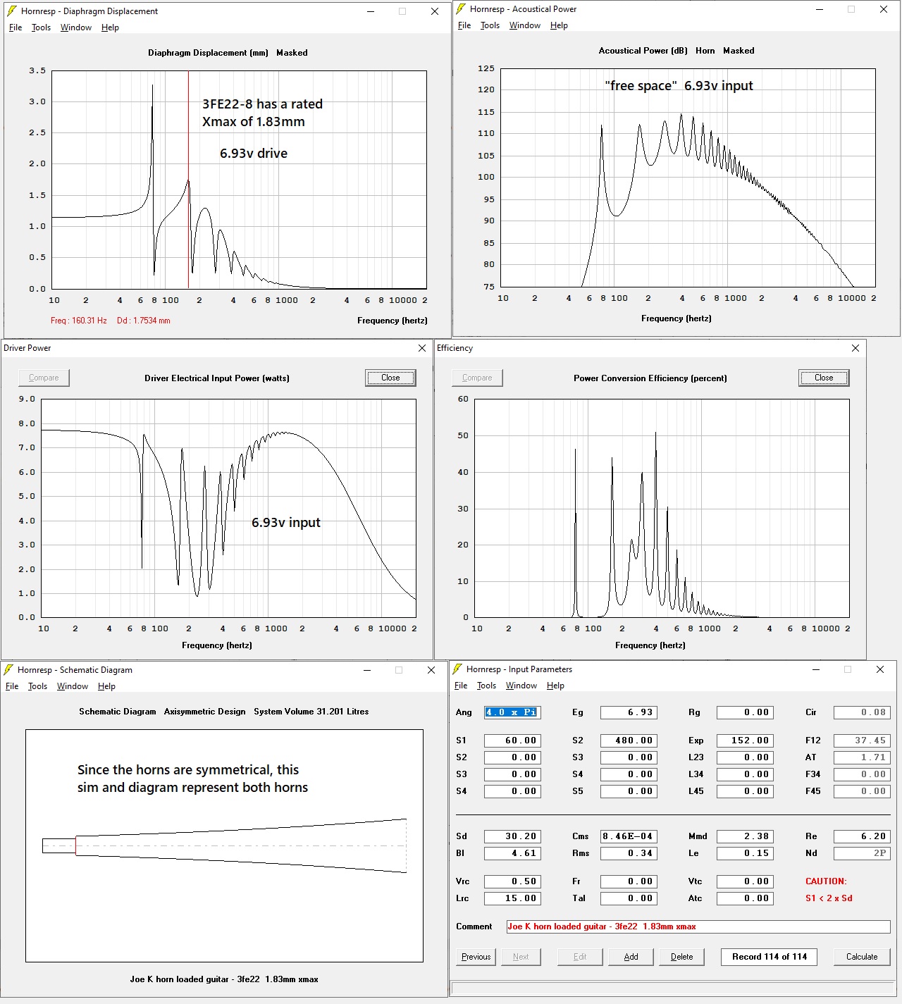

freddi - the Hornresp shows I might be able to get up to 105 dB between 100 and 1000 Hz (generally the full frequency range of an acoustic guitar). That would be a wonderful volume increase, and that is only with one horn. I have two, so amplitude will increase as they are symmetrical (constructive).
Printer2 - I see your guitar output is 40- 75 dB, makes sense for a smaller guitar, pretty cool data.
weltersys - yes having the horns in the body, and loading the body with sound/vibration is a total unknown to me, we shall see how this sounds, will be a learning experience. Feedback could be a real killer, my biggest worry. dB output will be the real test, I agree this might be dicey, but I am still going to try. Keep in mind the horns provide much of the sound, but the soundboard will also provide as usual, the combo will be "interesting" as you mention.
This is a prototype. Given the CAD and CNC equipment I am using, I can redesign the horns to be elliptical or round, so much to learn, and so much to redesign after I have test results that might be successful and more importantly, failure modes. I don't see any reason why we should build a guitar exactly the same way we have been doing for more than 100 years, lets dream and see what happens!

The dB scale is just relative. The mic is is about six inches above the soundboard. You can adjust the gain in the software from what I remember.
if you were using say, 3fe22 then its Xmax is rated 1.83mm and around 7mm limit before damage.

Well I don't know anywhere near as much as you do about Acoustics Engineering, so we are even. I will consider your approach because I trust what you say, and also because I thought it would be a good to have one of the horns stop short, and exit up to the guitar player. A very interesting idea, thanks! Any others want to comment?
Freddi,if you were using say, 3fe22 then its Xmax is rated 1.83mm and around 7mm limit before damage.

+/- 5 dB over a two octave range is not "terribly bad", but not very encouraging, as it implies that some notes will sound half as loud as others without corrective equalization.
Are you using the Tectonic Audio Labs, Inc. TEBM46C20N-4B ?
What's the range between the low E (82 Hz) and all the harmonics extending well past 12kHz look like?
Have you compared the output sensitivity of the horns to the drivers mounted in a box of similar volume?

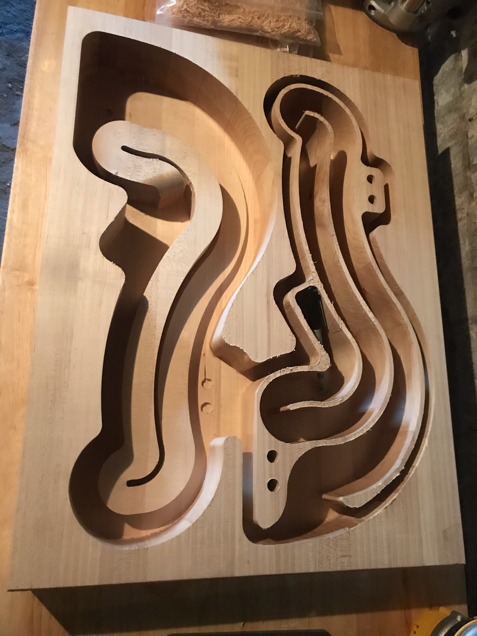

This picture is the finished wood from a CNC program ( 1,300,000 lines of code) to cut this prototype. The two pieces will be cut out and assembled to form the horn. There are two of these (symmetrical) in the guitar. Ask your horn player friends about the power of a horn. Blow a breath through a saxophone and fill a room with sound, same thing.
