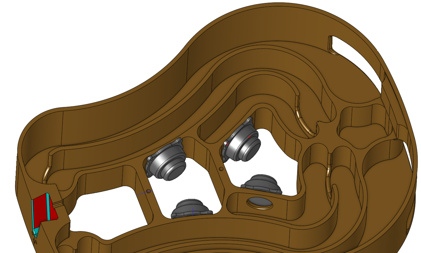

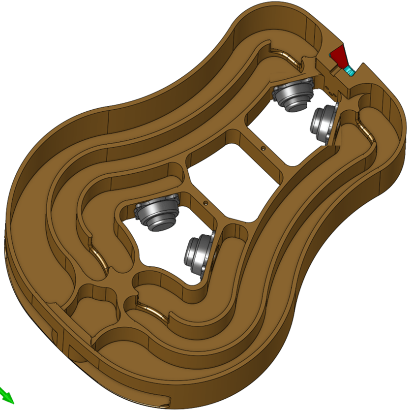

My intuition says you want to rotate the new speaker 90 deg to the right and arrange it to fire directly into the end of the horn routing, versus that right-angle setup of your original speaker position. Then you dont need the old position at all anymore. Or keep all 4 for the additional power handling you're looking for.
I mean the tapped horn driver arrangement above is just as valid as anything I'd say. FAIK it'd work great. However, if the current speaker chamber were a solid hunk of wood, could you mount a mag pickup there, just in front of the bridge? Who know what top bracing that hole would disturb, just thinking about a rock solid mount point for the pickup. I assume that's what you need to crank it without feedback.

Doubling the speakers as in the arrow placement in post #628 could give about 3dB more efficiency using the same power, +6dB output if power was doubled.
Adding speakers at the other position could fill in dips in the response at some frequencies while canceling at others.

Thanks much Art, if I use a new amp with more power and four speaker connections, then use the new positions shown in this attachment, I understand it "could fill in dips in the response at some frequencies while canceling at others". Do you think the canceling could work to my advantage, as in cancelling the 370 Hz frequency that is casing feedback problems?
Do you think I could get the +6dB output with this arrangement? I would love to get another 6dB. I like what I have very much, but of course I am getting power hungry. I mean my horns are not even close to full size horns, so more power is something I will always be chasing, as long as it does not cause feedback problems.

OK, will you put both down at the end, or one up halfway? The reason I ask is because if they're a large distance apart, there will be a frequency that cancels due to the time delay from the one at the horn end to the one in the "middle", given each is driven by the same signal.I can't wait to test four drivers, I bet that kills it even more, stay tuned!
That said, when I tested a few acoustics their FR plots looked somewhat like comb filters, with peaks at whole number multiples of some fundamental frequency. Maybe that's what makes an acoustic sound like a guitar, so - done right - you may be onto something deliberately causing that effect via driver placement staggered along the horn length. (New Patent pending!)
Done right means those FR peaks land on, or nearby, concert tuning frequencies, such that the whole thing livens up when properly tuned. But not too much, else you'd get that atomic blast on just certain notes, which of course isnt how a guitar should play and sound. I'll guess just flat to concert pitches is where the comb frequency sequence should land.
Yes Yes thank you JJ, and Art also noted this. I am going back to the old play another guitar through my spare folded horn guitar, see attachment. I do want to mount the two extra speakers as you noted at option #1A, I can do this in the production design, but for testing I will do at option # 1B.
I will also test option #2, just for fun. The speakers will be mounted above the chamber divider, which will never work in production (feedback), but will be a great test with other guitar through guitar horns. If they work, they will be mounted below the chamber divider.
Art - my #2 option would cancel, I know. I see tapped horns like yours add the front and back of driver, but are they designed to be in phase? Meaning does the front of the speaker sound meet the back of the speaker sound at 180 degrees? A 40 Hz sub soundwave is 28 feet, does it meet the back of the speaker at 14 feet to be in phase, seeing how they are both in the horn path? Maybe I have this wrong? I am just learning about tapped horns, and find them to be highly interesting. Please advise my friend.
After playing tonight, I think I don't need much more power really. I play for a while and think, do I have enough? Then I turn the power off and just play acoustically, and laugh again at the difference, incredible!
I really just want more headroom!
Tonight I tested with dB meter, 129 dB at horns!!! 122 at soundboard!! Even better than guitar through guitar earlier REW testing (which was about 120 dB max).
Earlier I noted normal acoustic guitar at 85-90 dB, I think that was low through REW, not sure why. With dB meter I am getting 90-95 dB WITHOUT folded horns, great? Pretty much the same as my Taylor and Guild, but I admit not as nice sounding as either ONLY acoustically, but turn on the horns BAM, not even close, this damn thing ROCKS!
My Bose Waveguide Radio max is 109 dB, so beats that. I am splicing, and also mounted speakers tonight, hope to have ready for testing tomorrow, but I am having so much fun playing this beast, I don't really care when I get everything else completed, let's rock!
