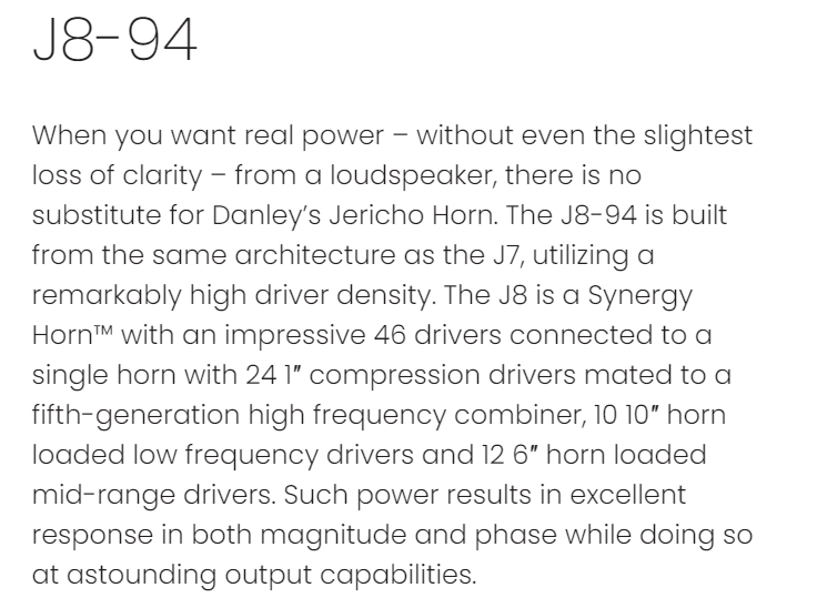

A clip below of the Danley Jericho Horn details, WOW!

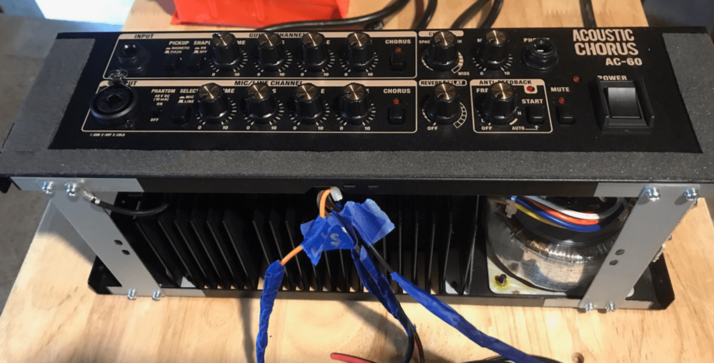

Very happy with my 30 Watt Roland, BUT of course I thought about more headroom, so I bought a 60 watt Roland, Great amp, IF I go the route of amp outside of the guitar, a good option.
I mean this thing is a beast, heat sink and all, 60 watts! Will be great right? NO!
I really think it is too much power for the horns in my guitar. It sounds "bombastic" does that make sense?
It actually made the piezo feedback, which never happened before.

OK I just found the ohms rating for the Roland amp speakers. I knew the Roland AC33 amp that I have been using with great success has 4 ohm speakers, and my Tectonics speakers are 4 ohms, all good.
I just discovered the AC60 has 8 ohm speakers. I don't want to use this with two speakers only, so I will try four speakers in parallel to see if that works. My piezo and magnetic pickups both have preamps, so not sure how that affects the power and sound, no specs on those. Plus the AC60 was making my peizo feedback, need to see if that happens again.
Four speakers in parallel will be 1/4 the impedance of one.
The AC60 may not work well lower than 8 ohms, two four ohm speakers in series are an 8 ohm load.
Yes, thank you Art, should be in series, not parallel, appreciate your help.
I would do my two 4 ohm speakers in series to get an 8 ohm load, that would match the 8 ohm amp/one speaker of the AC60.
Then the same for my other two speakers.
Four speakers total. Can't do this with only two speakers for the AC60. Will try this weekend.
But of course the AC33 with two speakers each at 4 ohms matches that amp speaker setup, hence the great sound.
