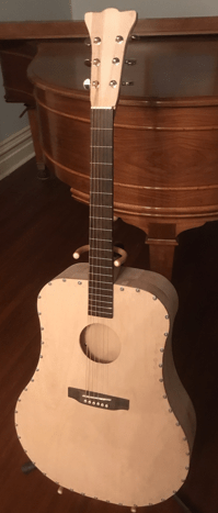

I found the problem: the nut pocket on the new neck is slightly different than the nut pocket on the old neck. These were CNC features so dead nuts there, but the second neck was squared up on the mill before cutting (improvement) so there must be a little difference there somehow. Plus maybe the nut got filed down a little earlier, not 100% sure how it happened, but I measure the nut to the fingerboard, and it is definitely too low, exactly the kind of problem that will make a guitar sound terrible. I have nut stock and will just make a new taller nut, not very diffiult to do, so I am safe, what a relief!
I was able to play the guitar for the first time, and I found it very easy to hold, even though it is larger, plus the weight did not bother me at all, good news, stay tuned!

It works, the damn guitar works!!!
I was worried about the acoustic guitar intonation, had a bad neck before (fixed) then a bad nut before (fixed).
Now the neck is dead straight, nut height is a little high, which I like, less distortion on frets, generally harder to play, but not for me.

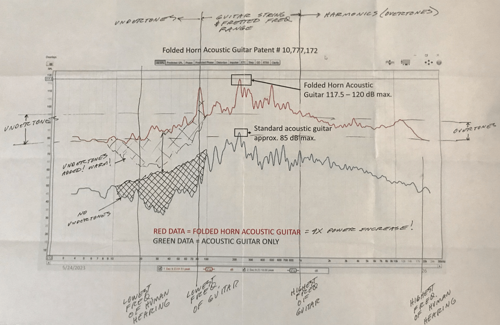

After a few years, I finally have it right. 4X the acoustic power, really rocks!
The intonation is great, open to twelfth fret, perfect!
I was very worried about feedback, not a problem at all, what a relief!
That said, it is like an acoustic guitar with electric guitar power. If you play a hard open chord and let it ring, it will feedback (power) but only if you let it!
4X times the power lets you play easy, and get a big sound, no need to beat the hell out of the guitar.
The Holy Grail of Acoustic Guitar is not tone, that has been mastered many many decades ago, it is power (volume).
I would like to add effects. I have the Tonewood amp. I will add for an even better experience!
This guitar (acoustic only) is 5 dB less that a standard acoustic guitar, due to less volume in the chamber, always knew this would happen.
With the speakers and horns kicked in, WOW, blows it out of the water, can hit 120 dB.
I have improvement ideas for sure. but the goal id to sell the IP, Gibson? I will try!

I ran into a friend that is an audio engineer and he asked about my project. When I told him the horns, speakers and amp really rock, he said how is your acoustic guitar intonation. I said thankfully it is finally perfect after some struggle. He said great, that is all you need, you have your product.
My response was that the guitar acoustically is good, but not as good an a Martin or Taylor...and that bothers me.
He said who cares? If your guitar was an acoustic guitar only, then it would be a problem, but you have the folded horns, amp and speakers, that is totally different. He said I will give you some digital small footprint equipment that will let you model any tone you want from your acoustic guitar with correct intonation, THEN send it though the amp speakers and horns. It will sound like anything you want it to. Program in a classic Martin sound, program in an electric guitar sound if you want, anything, the list of different tones is amazing. Plus of course some good EQ, up the lows if needed...
It is similar equipment that Line 6 uses (owned by Yamaha) in their modeling guitars. Anybody familiar with this company and their guitars? How do the different tones sound?
I always had Yamaha on my list of potential buyers, but I did not know they owned Line 6. Maybe they would be the perfect company to buy my IP. Hey, it is worth a try!
I have much work to do on the tone end, and in REW to measure and compare. Please USPTO, hurry up with my patent!

So your chamber divider is what, 1/2" thick? Try something thinner, which will give the acoustic chamber more depth and hence, volume. Dont be afraid of metal; Travis and Ovation used it. Plus if it's glued and screwed all around the periphery of all that horn routing; it'll probably be quite stiff even if thin. A sheet of carbon fiber? Masonite? Plexi, or modern day equivalent?
You might want to experiment with different sound hole diamaters as Art suggested; perhaps that gives the tone even if it's not as loud. As your friend says, so what - it's supposed to be an electrified acoustic. They have silent guitars (I have one) so in some cases, the quiet mode is useful.

I have some new ideas to make the upper chamber larger, I am not going to settle with what I have now. Great with acoustic/electric setup, but still needs that boost for acoustic power and warmth. After all people will not just plug it in and play, they will likely play acoustically first, and first impressions are a big deal.
Right now my upper chamber is approx. 65% in size (volume) of a standard dreadnought guitar. I can get to 85% with this idea, and maybe 97%. Much to test this weekend, stay tuned!

Art - you schooled me about harmonics/overtones at the start of this thread, thank you. I knew about them, but did not appreciate their importance until you told me, and I measured them in REW.
I would really like to hear your opinion regarding undertones. Some online say they don't exist, others say they are there but can't be heard. Andy Powers from Taylor seems to like them, from what I read. Plus this is in the 30-80 Hz range, below the lowest frequency of a guitar, hence undertones!
Personally I know they exist, I can hear them and I can measure them, at least with these horns, not sure about other situations. This is the "through the roof" lows I can hear when I cover my horns, just with music from my iPhone playing (although that includes a bass guitar). I can most certainly hear them when I played my Guild through these beautiful five feet long horns/waveguides. I swear it is some of the best acoustic guitar I ever heard, even with my playing.
Forgive my crude sketching on this REW data, but I think it shows it very clearly, and I hear it!
Now the undertones on a standard acoustic guitar probably can not be heard well. The lowest is at 30 dB, I bet my ears can not hear that.
When the speakers are on and the horns are rocking, the lowest undertone is at 80 dB, easy to hear, even compared to the higher dB of all other frequencies.
Also note the undertones are in the same dB range as the harmonics/overtones, although I know the highs are easier to hear at the same level. I find this to be highly interesting. What do you think? Let me have it! Joe
