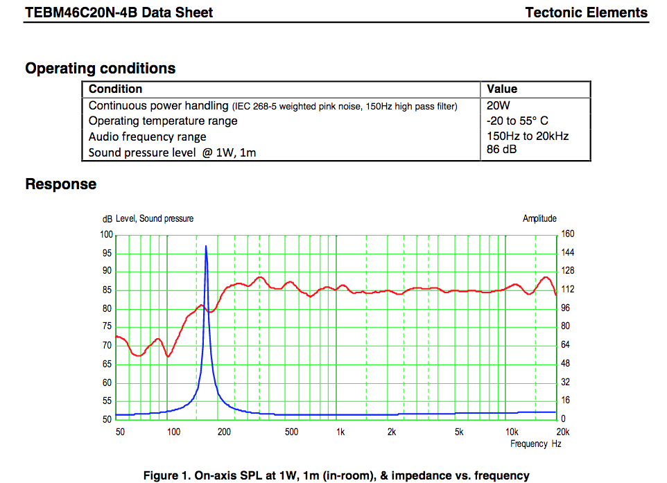

As a basic reality check, compare the output of the driver you use driven with 2volts input (1W/1m):
You could expect the horn to provide peaks as much as +6dB over the front loaded driver, and a reduction of -6dB or more in the upper range if you do a similar test.
Best of luck figuring out what is wrong with your test procedures.

What do you know, I just looked up the Tectonic driver at lunch today, recognized that FR right away.
