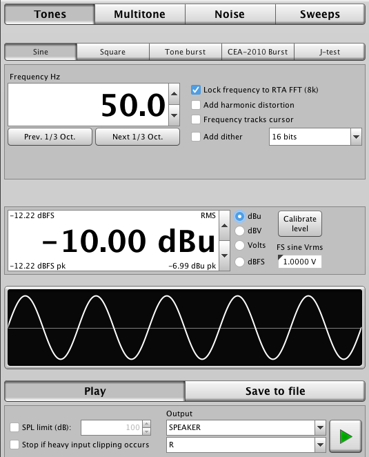

You can wire both amp inputs parallel with a "Y" cord if the inputs are not already parallel.
To verify the amp output is reasonably flat, start with the master wide open, pre-amp gain off.
Attach the leads of an AC volt meter to one of the amp outputs + and -.
The speakers need not be connected at this point, and may be annoyingly loud if they are, around 105 dB at one meter.
Using the REW tone generator, put a 50Hz sine wave in at -10dBu (245mV), adjust the amp input gain up until the amp output read 2volts AC (1 watt into a nominal 4 ohm load).
Use the "Next 1/3 Oct." button to advance through frequencies up to 20kHz, if the voltage does not vary, the amp output is "flat", if it does vary, use the tone controls to adjust as close to flat as possible.
Verify both channels are the same.
After verifying the amp is flat, do the sweep tests at the same level for a one watt (per speaker) test.
Also note the difference between 1 watt and 10 watts is 10 dB.

Wow, thank you so much Art! That is the kind of detail that really helps me. Hopefully I can pull this off soon, a learning curve for me. Having this kind of direction really motivates me. Now I just hope the results are impressive, but with good sound by ear and comparisons, I am a bit encouraged.
