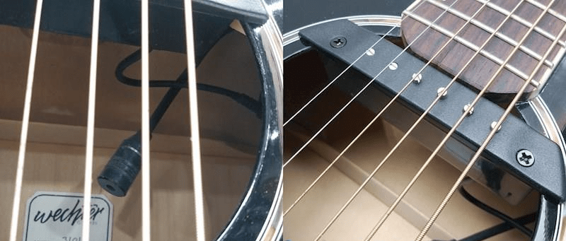

Speaking of patents, I bet this guy "Wechter" has one on this;
The label does say "patented". It looks like you have eq on the whole, plus individual eq on the mic - along with a blend control. Plus I'd assume you can swing it around in there on its gooseneck, which is perhaps where the patent comes in. Others like Fishman also have these mics, but simply mounted to the underside of the preamp control panel case that, when mounted, ends up inside the guitar; also with a "blend" control to proportion against a piezo saddle pickup. I have one, but havent yet chosen which guitar I want to molest to install it.
So. With a feedback suppressor, a little mic you can move around to suit, eq here and there, blend control maybe you can find a sweet spot where it both sounds good, goes loud and doesnt feedback. But I wouldnt count on it...
If you've achieved that with the speaker as a physical part of the guitar itself, well, that's pretty remarkable. All guitars sound different and that's OK, as long as they sound good. If you think yours sounds good against quality acoustics and electrics with an ordinary amplifier, march on with it. Personally, I like the version with the horn mouths on either side of the neck. Hopefully you can get that one to sound as good as the bottom exiting version.
I agree that is a nice little type of mic, and it has its place with an amp for sure. I still don't think it would sound great thru an amp as you note JJ, plus still prone to feedback. Nice mic thru PA is great, but a hassle.
