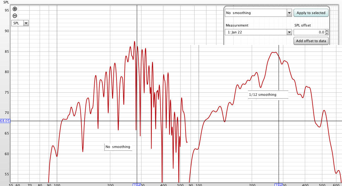

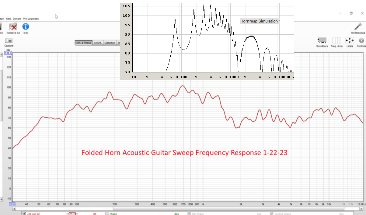

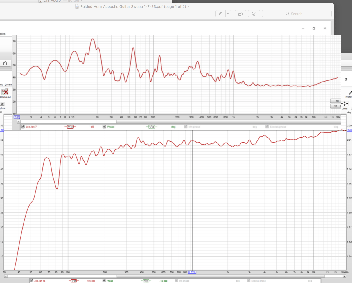

Your “Joe Jan 15” test shows a response rising from 44dB at 65 Hz to 49dB at 400Hz, +/-2dB out to past 3kHz, then rising response to 53 dB at 18kHz.
The response looks unbelievably good, as in too good to believe it’s true, given the prior responses and comments you have posted stating that the low end is huge and the high end drops off.
Background noise and low drive level could have been the problem in the “Joe Jan 7” test, but no way can it drop from 55 dB to 0dB today.
If the input to the drivers was around 2volts (one watt per 4 ohm driver) you should be seeing around 50dB more level at one meter if the test system is calibrated correctly, something like this:
What voltage level were you using in the above tests?
Are the horns or the soundboard side facing the mic?

Thanks much Art, I just though of something. I have the mic 1 meter away from the horn/waveguide opening (mouth). So facing the horns, not the soundboard. The horns are 5 feet long, so the mic is actually 8 feet away from the driver. Is this correct? Maybe I will try putting it directly at the mouth. The dB level is low, so was wondering.
I was also pleasantly surprised about how flat the response was, about +/- 5 dB. Not sure how different a sweep is compared to playing a guitar thru the horns. Also I did say my bass was going way up when the horns were covered, great sound, but my REW measurement still had them lower than the mids. Then when the horns were sealed, my highs seemed to get stronger. So I had a strong mid (guitar range pretty much), with less on the highs and lows, but not AS less as a standard guitar measurement.
So this sweep shows strong mids, with lows somewhat below that, not surprising. What is surprising is how the highs/harmonics don't trail off, interesting.
Following the scientific method means I need to get my results to repeat, and show more evidence, I will do that. I might find good results again, or maybe I will find a flaw in my methods.
I will also test with the horns uncovered, just because I am curious. I will test with the mic at different distances, and different locations, in a different room. Plus I might even stick the mic inside the horn.
The other change was I used both channels this time, with a dual 1/4" patch cord to USB on the laptop. I am pretty sure last time I just used one channel, that obviously changed results (I need to keep better records). Plus the room was quite, furnace completely off, late at night, zero traffic noise during recording, no laptop fan going during recording. After that the guitar jamming was strong again, encouraging.
Plus I did more small hole drilling. I also bought a XLR to USB cord. I have about 50 cords, but of course not that one. I am experimenting with the Shure mic right into by laptop with DAW software, bypass the four track recorder. Need to listen to results though headphones, the laptop speakers are completely lame. Plus I am not so sure the laptop mic is worthy.
Boy was I surprised when I saw the +/- 5 dB, I thought the same thing Art, thats pretty good, did I do something wrong? If I can keep repeating this, great. If I can get this same relatively flat response at a higher dB with other mic options, also great. Stay tuned, more next weekend, traveling again.
Oh yeah I also started the sweep at 30 Hz instead of 0 Hz, so hence the change at the bottom. I will check out the voltage. Thanks! Joe

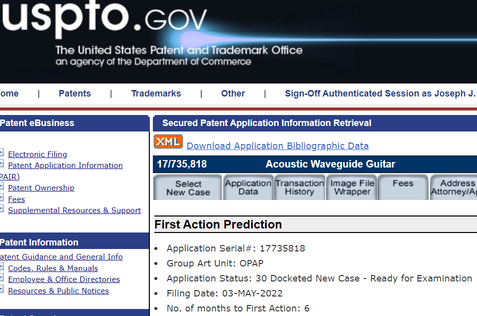

Thank you sir! Please stick with this thread, the more input, the better. Info attached, please share with others. Patent can be found on Goggle Patents.
I have another patent being reviewed by the USPTO right now, it includes improvements. Lets make the acoustic guitar rock! Joe

Even with the sweep starting at 30 Hz, hard to separate signal from noise with SPL at a whisper level of 45dB.
Considering you haven't checked the drive level voltage, can assume that you have not calibrated the system.
The acoustic point of origin is 5 feet (around 4.4 ms) behind the horn mouths, but the output must be measured outside the near field to be representative of what you hear. The output will vary considerably with frequency depending on the orientation of the measurement mic or your ears to the horn mouths.
You will probably find 10kHz around -20dB at just 45 degrees off axis, even less in front or above the guitar, expect that horizontal and vertical will be quite different also.
The curvature inside the horn mouths and their separation distance is going to make for some unusual polar patterns!

Agree that the SPL is too low Art, not sure what is going on there, suspect.
I did calibrate the mic, and the amp was measuring flat at about 5.5V
Drive level voltage and system calibration? Uh-oh. Did I miss something, might this be a problem, please advise!
I did measure on axis at 1m from the horn mouth.
Hoping I will find the problem and get higher SPL but still flat, or at least a good FR, we shall see! Joe

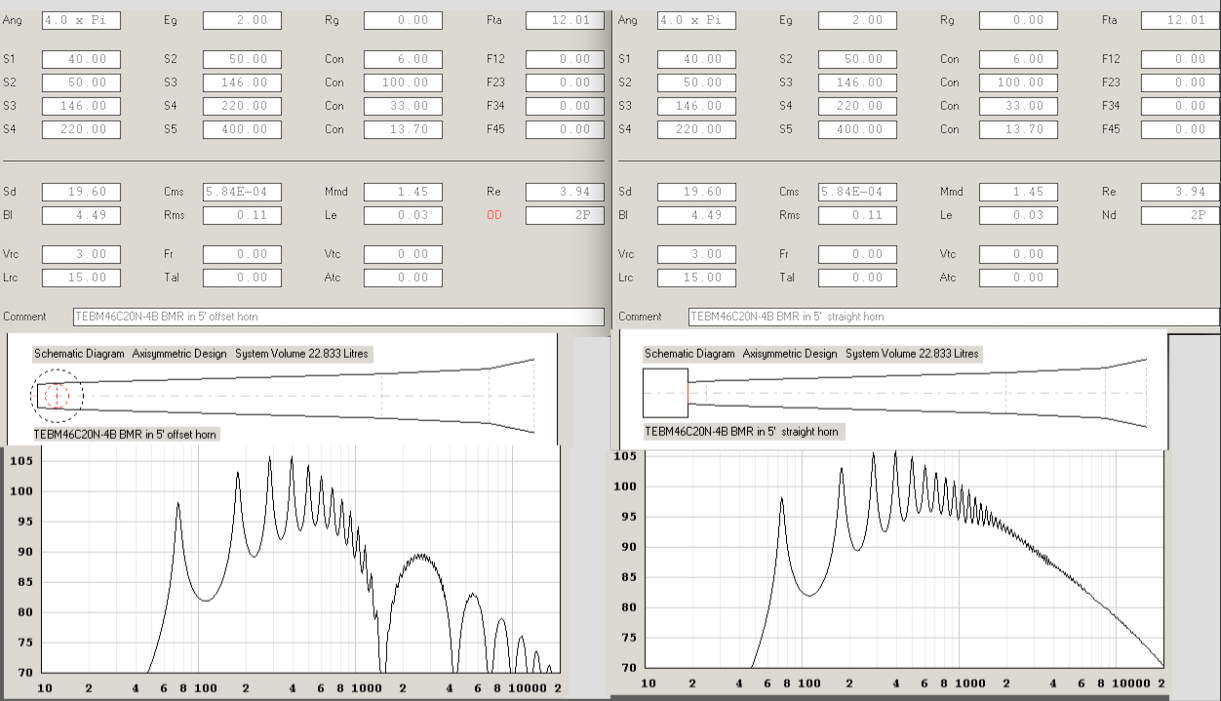

Your 1/15/23 test of the offset horn shows virtually no peaks or nulls, and the rising response out to 18kHz just dosen't seem likely.
It's possible the BMR (balanced mode radiators) drivers avoid some of the problems of standard drivers of this size, but we won't know until you sort out your drive levels and determine that your system is calibrated.

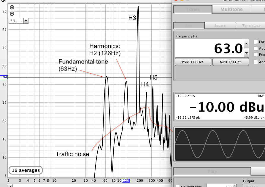

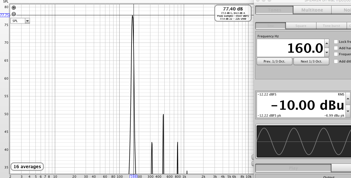

REW can show you the distortion in a sweep, but using a single input signal sine wave tone you can see the fundamental and harmonics clearly, if they are above the noise floor.
Here are examples of harmonic distortion using my computer built in mic about .5 meter from it's right speaker.
At the 160Hz sine wave tone fundamental, the speaker produces 78dB, the second harmonic (320 Hz, H2) reads 42dB, -36dB below the fundamental, under 2% distortion. H3 is 50dB, -28dB below the fundamental, about 4% distortion. Not bad at normal listening levels. Things don't look so good at a lower frequency.
At 63Hz, the speaker fundamental is barely audible at only 32dB, H2 is -1dB, 89% distortion, H3 is 51dB, way over 100% distortion, and H4,5,6,7 are above the variable traffic noise floor. That said, if the heat pump happened to turn on, all but H3 would be below the noise floor.

Thanks Art, I thought external noise was a "maybe" but you show it is not, I believe it! If I have time tonight I will try again, if not then tomorrow night for sure. I will find the problem, I hope!

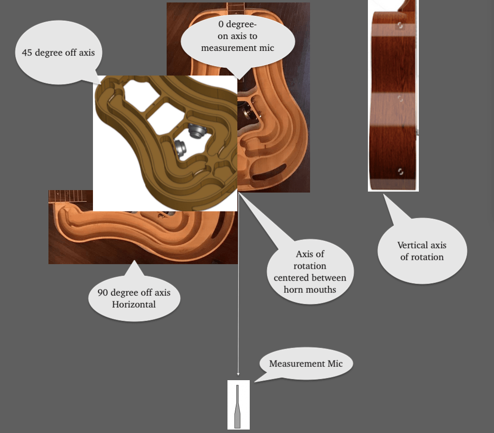

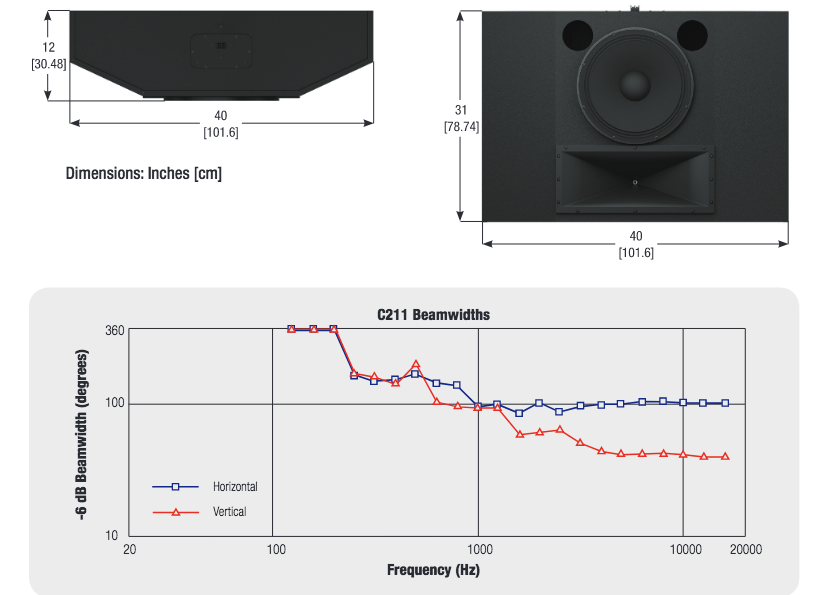

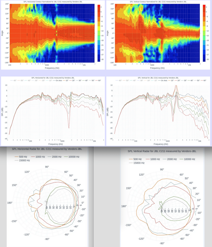

Here is one way to see the beamwidth of a speaker:Thanks for the info about low frequency wraps 360 degrees, and the highs beam. I like to "picture" the sound waves in my head, I get frustrated with things I can't see.
These pictures show three more ways of visualizing the same polar response information, the center horizontal and vertical being the way you will see it in REW.

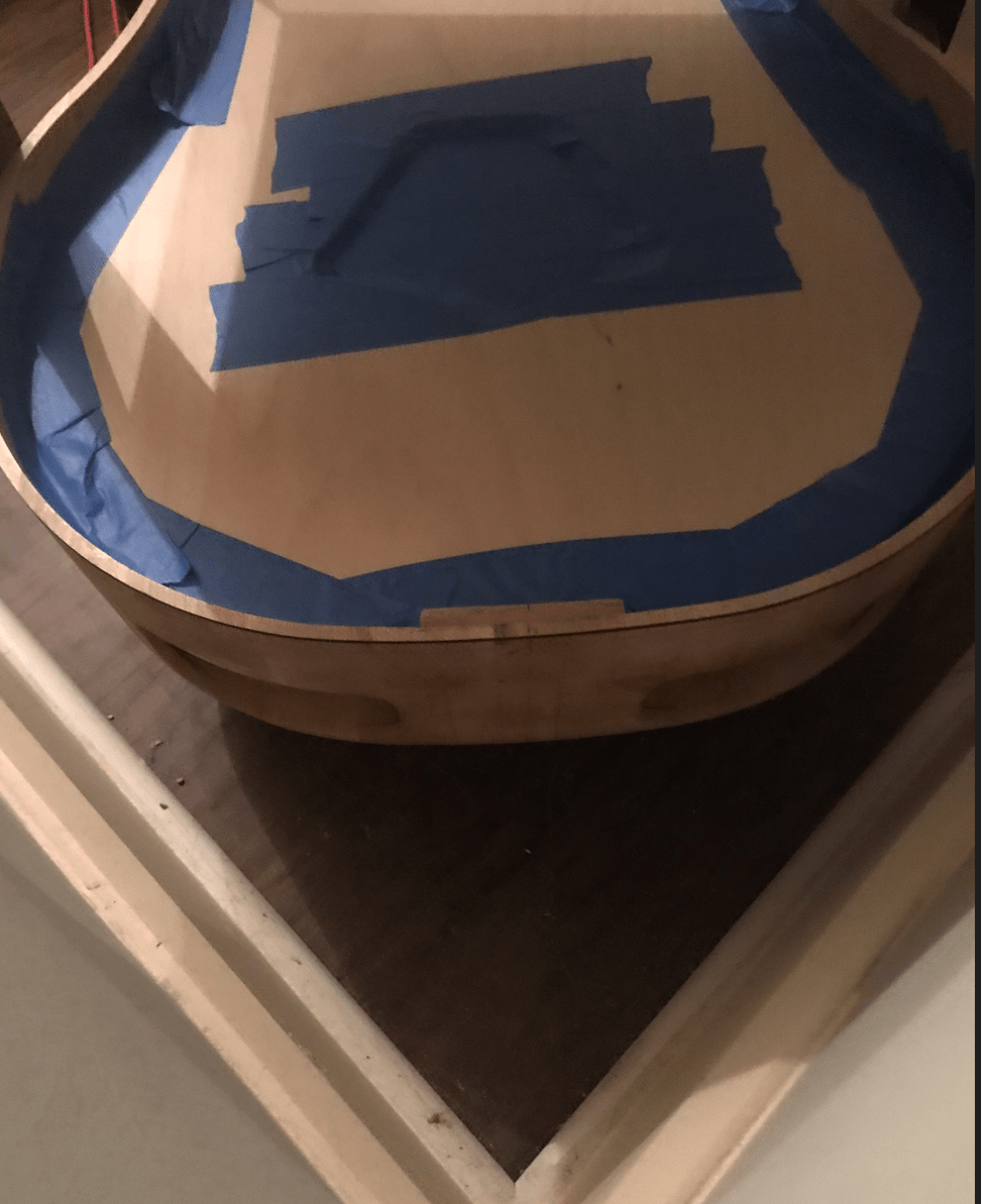

If the tape covering your driver's compression chamber is not backed with wood, it may be acting like a passive radiator, contributing a Helmholtz resonance.
The low frequency of your horns is omnidirectional, when it's sound pressure level becomes loud enough to vibrate the guitar body enough to vibrate the strings, electro-mechanical feedback occurs. You are calling this form of feedback "sustain", it will be way more of a problem when the soundboard is inches away from the horn.
Art

The tape is over the first piece of wood above the driver compression chamber, then another piece of wood everywhere except that area, hence the tape. Older chamber divider with hole cut out, bad idea! This is the test guitar. The build guitar has a 1/2" solid piece of Baltic Birch, I could swap that out for testing. The third guitar has not been hand worked to have the driver holes and horn pathways cut out in the four areas. I am wondering how I can improve that, I have some "corners" in those areas that could probably improve. Maybe the polar response visualization above would show that?
The soundboard installed will be worse, eh? Yeah I know, worry about that a bit (nervous excitement). 🤔 I am trying to make time tonight to glue the bridge on the soundboard, must be precise location compared to the neck and soundboard install location. Sweeping tonight for sure- Dust My Broom! Joe

Post #466 shows you how to position your horns for polar tests, just need to do them at about 10 degree increments to get more than a rough idea.Thanks much Art, really great info. I should find a way to test that in my horn configuration, to visualize even better!🔊
The corners near the mouth will affect the polar response, the inner corners will mostly affect frequency response.The third guitar has not been hand worked to have the driver holes and horn pathways cut out in the four areas. I am wondering how I can improve that, I have some "corners" in those areas that could probably improve. Maybe the polar response visualization above would show that?
Indoor boundaries will also affect response, you need to be very precise in repeating set up conditions to make comparisons.
OK Art, I found the problem, see attached page 2. Highest SPL was 68 dB, where was this error message before? Behind another window?
The last two measurements obviously had this error, fixed it, now back to normal as before. So the last two FR pdf's were indeed suspect.
The good news is, I am getting about 100 dB max from the sweep, the bad news of course, is not as flat as before. I was at +/- 5 dB, now I am at +/- 10 dB on the mids, and +/- 10 dB on the highs, but a major drop off, so not total range.
These drivers are rated at 100 Hz to 20,000 Hz, so I understand the low dB below 100 Hz, but why does my guitar measure 80-90 dB below 100 Hz, so much higher? I like it, and can hear the great bass, please advise!
The mids look good, strong and very similar to my guitar output.
My guitar output highs are strong at about 85 dB, but this FR is about 75 dB, and the drop off from about 1,300 Hz to 2,000 is significant, not so great, what gives?
What do you think of this Frequency Response? I think this is the real deal, but I will test again, to verify the setup is legit. Let me have it! Thank you as always Art , I await with bated breath! 🤣 Joe
Joe,
Can't help you find all the error messages 😉
As usual, your 1/22/23 test does not indicate any measurement conditions, but assuming the test was on axis, away from boundaries, the good news/bad news is your sweep looks similar to the response predicted in Hornresp.
We can see your horn's major nulls at 1.9kHz and 4.9kHz due to the offset driver orientation, pointing at the horn sidewall rather than the throat.
The peak and dip frequencies don't line up exactly, since the inputs used are not identical to your actual horn dimensions.
If you provided the actual cross sectional area along the horn path and volume of the compression chamber, a simulation could be a closer match to what you built. That said, the BMR drivers used have some properties that won't match the rigid piston model, which could explain some general differences, like a bit less low frequency than predicted.
You are using 1/12 octave smoothing, if you use less (1/24 or 1/48) or no smoothing, the horns sharp dips and peaks in response will look more like the simulation.
In other words, worse, like this example of the same response with no smoothing compared to 1/12:
The data sheet posted in #451 shows the drivers you use rated at 150 Hz to 20,000 Hz, with response -18 dB at 100Hz. I was surprised that the driver simulated as well as it did.
Since the horn's overall level drops so severely above 2kHz, your general impression of boosted bass when you play guitar through it tracks what the response appears to be.
You could try testing your JBL speakers response in the same location with the same amp and drive level to validate your test.
Art
Art
