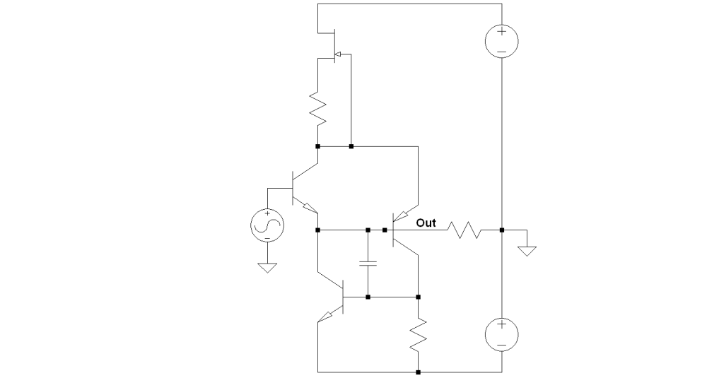

SE buffer by Steven (the best SE buffer known to a mankind this side of universe, if you ask me)
Can you please add some values to this circuit. I can't get it to simulate any good.

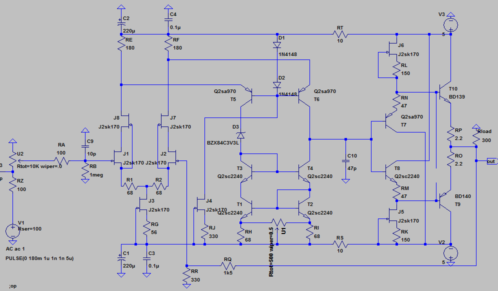

A bit too complex to start with, but maybe this is what I eventually end up with.
I tried some tweaks again. I cascoded the input stage à la Borbely. It adds some flavor to the sound, that's for sure. It's brighter than neutral now, and a brighter sound is at first glance always perceived as being more detailed.
I added a Zener between the T3 and T5 collectors to get an even voltage across the folded cascodes. I can't hear any difference, it doesn't simulate any different and it looks the same in RMAA.
I removed the lag comp cap and added source resistors. I'm not sure I can hear any difference with the exception of more noise when listening through IEMs, but I like the idea of dropping this cap after Jonathans reply http://www.diyaudio.com/forums/showthread.php?postid=1739818#post1739818. I still get an almost perfect pulse response without it (in sim).
Configure J-fet CCS (use BF244B/C or similar and resistor below) for ~10-15 mA, resistor at the bottom is ~100R, but you will see one Vbe offset (~650mV) at VAS output (current mirror output) 'cos buffer output is at 0VDC. Also, use something like 100pF or more for compensation.
For "Borbely" cascades don't use 2SK170, use low input capacitance J-fet like BF244/5, 2SK246 with higher Vgs, you have to give poor 2SK170 some voltage to work with.
Thank you, I'm going to play with this.
For "Borbely" cascades don't use 2SK170, use low input capacitance J-fet like BF244/5, 2SK246 with higher Vgs, you have to give poor 2SK170 some voltage to work with. [/B]
Oops!, sorry, I do use SK246 in the real circuit, I just forgot to change it in the schematic above and now I cant edit that post.
Nelson, at which Vds are the 2sk170's working when cascoded with 2sk246 in the real circuit?
Personally, I found the sound better with bjt's as cascoding devices, but that seems to be only me. It is more complicated as well.
Rüdiger
1.8V, if you mean voltage between drain and source.
Rüdiger [/B]
Me too, but the reason I use SK246 is the lack of space in my little amp. Also, I've been looking at Erno Borbelys desings, and I thought what's good for him is good for me.
I've also tried a CFP input stage with SK170/SA970, but it seemed unstable, and the sound wasn't what I was hoping for.
Lumba Ogir said:
I see some problems, but no advantages with Steven`s circuit. Also, it requires a strongly deteriorating compensation capacitor, which I cannot voluntarily accept.
See http://www.diyaudio.com/forums/showthread.php?postid=775787#post775787
Regarding compensating capacitor, there isn't any in Steven circuit, so I've just put one to establish safe operation without oscillation.
Lumba Ogir said:
Could you explain why, please?
I believe that without them this circuit will have lower H2 (lower THD as well), something you don't expect with balancing resistors and local feedback. I don't understand the mechanism or theory behind, but it seems to happened (again, I could be wrong here). Added noise is another issue, but not so important here.
