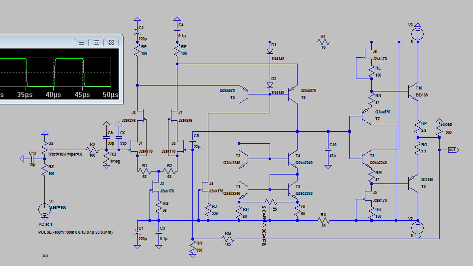

Yes, you're right. D3 isn't doing any good. I guess trying to get the same dissipation from the folded cascode transistors has a more intelectual than practical appeal. Regarding RB, I just did what "all" the otheres are doing. Using a 470k - 1M resistor in that position seem to be the standard procedure for JFET input amps. Could you please explain how to choose the right resistor. I've heard that it should be at least 10 times the pot resistance not to affect the input impedance too much.Lumba Ogir said:Nelson,
very nice, but I would remove D3, it`s not needed for anything (extremely nonlinear and noisy) and lower the value of R8 below 100kOhm.
By adding source resistors, the OLG is reduced and because of that the THD is increased by a couple of dBs. I just thought it was appealing to have the amp stable without a lag comp cap.The increased noise can be heard when listening through IEMs, but I find it's still low enough not to be annoying.aparatusonitus said:
I believe that without them this circuit will have lower H2 (lower THD as well), something you don't expect with balancing resistors and local feedback. I don't understand the mechanism or theory behind, but it seems to happened (again, I could be wrong here). Added noise is another issue, but not so important here.
I spent ages looking through past posts for an R8 that was >=100k.
I see you meant RB = 1M0 to be reduced <=100k

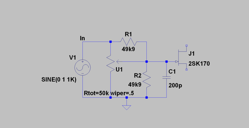

nelsonvandal said:In sim I can see the amp is peaking when the volume is lowered. This can be cured by using a pot with less resistance, which I don't have. Is there another way to fix this problem. Could this be why the amp is a little "edgy"?
You may try this...and you can use cheap Lorlin linear pot for testing purpose.😉 Also, I would try something like 4k99/1~2k for feedback devider to avoid HF peaking.

Nelson, show as 1k square with high voltage input as you can get prior to clipping, then zoom hard on +/- leading edges to see any peaking/ringing. You may add a small capacitor (less then 1n) in parallel to load to check behavior of circuit with reactive load.
It looks perfect in LTSpice, and I have to oscilloscope to test it in real life.aparatusonitus said:Nelson, show as 1k square with high voltage input as you can get prior to clipping, then zoom hard on +/- leading edges to see any peaking/ringing. You may add a small capacitor (less then 1n) in parallel to load to check behavior of circuit with reactive load.

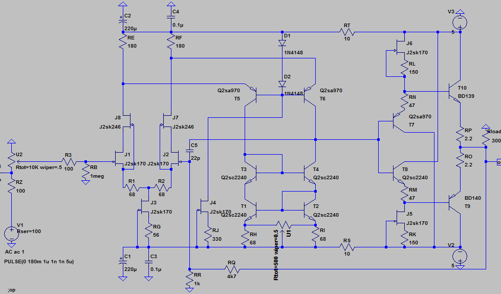

Well, actually it seems I can get rid of all capacitors except C5. I just took C10 for granted since most folded cascode/DB amps use it. I thought it was needed for stability. If I remove it in LTSpice, I can remove C6/9 if I increase the feedback resistors to 1k/4k7. I'm too tired to do it tonight. Hopefully tomorrow.Lumba Ogir said:Nelson,

Csource is just to simulate the cap in my portable player (it's actually 47u). I would never use an input cap unless absolutely necessary.
In the beginning of this project I was advised to use small caps in C6 and C13 positions and resistor RZ to keep RF out. Do you think they're pointless and should be removed?
Rz & C13 have only reached -3dB at 160MHz.
You could easily lower this to 1.6MHz or even 300kHz. But this is an operational fix for operational interference.

I don't like all the add ons between the input gate and the 100r anti-oscillation resistor.
Move them outboard or remove completely.

By add ons, do you mean the 1M resistor and the 2x33pF capacitors?AndrewT said:Rz & C13 have only reached -3dB at 160MHz.

yes those components.
Is there a technical reason why they might interfere with the input stage operation? other than "I don't like them".

C5 is needed. You could empirically try to remove C6/9, the intrinsic capacitances may be sufficient. A diode-coupled Darlington small-signal transistor would be more linear than D1/2.
