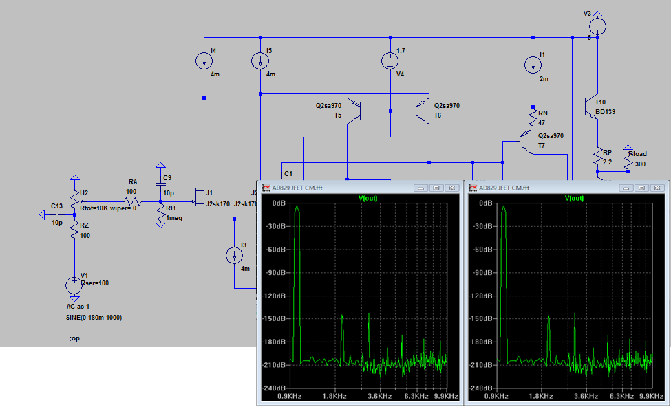

I'm not clever enough for this. I think I'll have to live without CM's. I've simulated the "Diamante" but never got any good results, probably because of my lack of knowledge.jcarr said:Nelson, Mihai is right. The design of the upper current mirror in your schematic <http://www.diyaudio.com/forums/attachment.php?s=&postid=1739711&stamp=1234201872> is problematic. You may want to redesign this current mirror so that it has double outputs and a single input, feed the input with a current source of the desired value, and feed each of the folded cascodes with one of the current mirror outputs.
Thank you for your suggestions. I didn't know that. I'll move that capacitor.
Also, the present location of C7 may be a problem in real life, because it will allow RF energy injected from the output to short-cut directly to the input stage, without going through any low-pass filter. Better to insert C7 between the gate of J2 and the collector-collector junction of T6/T4 (so it forms a local NFB loop). A revision to the value of C10 may be appropriate if you do this.
regards and hth, jonathan carr

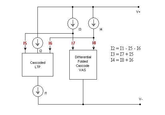

Don't get discouraged so easily, my good fellow! Please find attached a conceptual schematic.
?? You already have been using a CM in your schematics, to sum the differential signals into a push-pull signal that drives the output stage. T1 through T4, then RH and RI will be extremely disappointed to find out that you don't recognize them (^o^)!
The original location could have something to do with your impressions of a somewhat piercing sound.
jcarr said:The original location could have something to do with your impressions of a somewhat piercing sound.

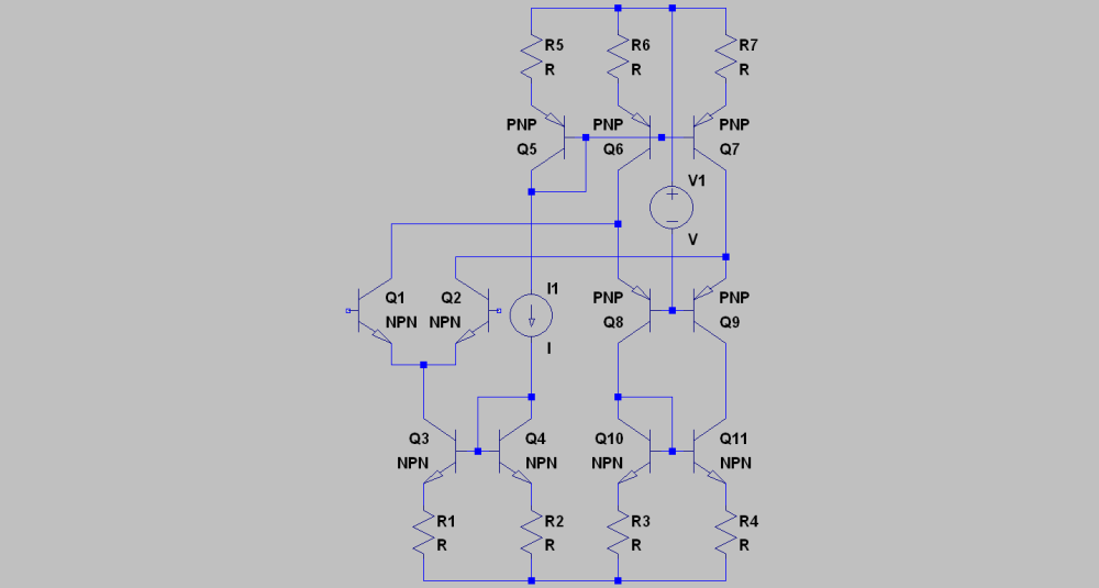

I've been searching high and low to find out a few things about the circuit, I even read the previous jcarr's posts about it but I still don't understand it. Can someone please help clear up a few questions I have with the circuit? 🙁
I'm trying to learn to calculate the DC bias for the circuit (not using simulations)
The circuit below does not use any current mirrors but a pair of resistors instead on the drains of the input FETs.
1) How do you define how many currents are running through the folded cascode transistors?
2) What is the relationship between the folded cascode currents and the LED voltage that bias it?
3) How much voltage drop do I need for the LED? Should I use any arbitrary voltage as long as it's enough to forward bias the folded cascode transistors?
4) Long tail pair current = Folded cascode transistor current + Input Pair Current
But because the resistor paired is shared between the drains of the input FETs and the Emitters of the Folded Cascode PNPs I just got lost there O_O!

thanks for the diagram.
However, I've already calculated those before. It still does not tell me what I should do with the voltage reference nor it clearly defines the current running through the cascode. Sorry if I'm not smart enough to understand this. I'm still quite confused.

TzeYang said:thanks for the diagram.
In my sims, increasing the voltage reference increases the current through the cascodes. This is quite logical as the increase in VBE increases the V drop across the resistors. Do I need higher currents in the f.cascodes in order for them to sound good?
This is one of the reasons in using active loading instead of resistors for defining folded cascode current.

TzeYang said:
yeah but active loading adds more parts. Some even reportedly said the mirrors sounds yucky. Especially after reading posts from Aksa and so on.
Who mention to use mirror?
http://www.diyaudio.com/forums/showthread.php?s=&threadid=111756
Hmmm, you're right.
But the way I look at it, your scheme looks like a "double current mirror". Does not seem any much difference than a current mirror to me. Why does something that is quite similar sound so different instead?

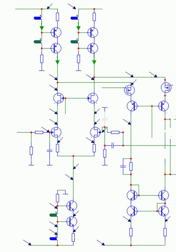

Here's how I did one of my foldes cascode designs.
The empty bases/gates have separate PS voltages.
Sigurd
Sigurd

Thank you for your kind replies.
I'm aware that I already use a CM, but a CM in that position seems inevitable.
You have given me some work to dig in to, and I don't think simualtions or measurments will do any good, because all active current sources simulate exactly the same. I have to trust my ears.
Even if I use perfect virtual current and voltage sources, I get exactly the same result as when I use the-not-so-good CM, as you can see in the picture below. The pulse response is also exactly the same.
I don't think I can blame the location of the feedback capacitor for the piercing sound. I use it the same way in my other amps (two of them are exactly the same but without CM), and they sound smoother and darker, but from now on I'm going to use the capacitor as per your suggestion. It makes sense.
More suggestions, not only regarding CM, are welcome. Sigurd uses a resistor/capacitor between the collectors of T3/T5 and Mihai is using a transistor in that postition. What's the theory behind this?
It's funny how different this amp behaves from "AD797". Adding active current sources to the '797 makes no difference at all in LTSpice.
nelsonvandal said:The pulse response is also exactly the same.
Try this for signal source and let us know what you see when you zoom in at the top/bottom of the leading edge PULSE(-1 1 0 1u 1u 500u 1m). If amplifier clips because of to high voltage, reduce first two ones to something like -.75 .75
nelsonvandal said:Sigurd uses a resistor/capacitor between the collectors of T3/T5 and Mihai is using a transistor in that postition. What's the theory behind this?
If you measure voltage over FC transistors in your circuit, you will see very big difference, dissipation on the left FC Tr is higher than in the right FC Tr. That is because in Michael circuit PNP transistor is put in current mirror input with its base tied to gnd in an attempt to equalised voltage over both FC Trs.
nelsonvandal said:More suggestions, not only regarding CM, are welcome.
For really low distortion you have to put triple emitter follower after VAS (as I have), simple diamond buffer won't do. That way you are reducing loading on VAS and gain output stage current capability by an order of magnitude.😉
