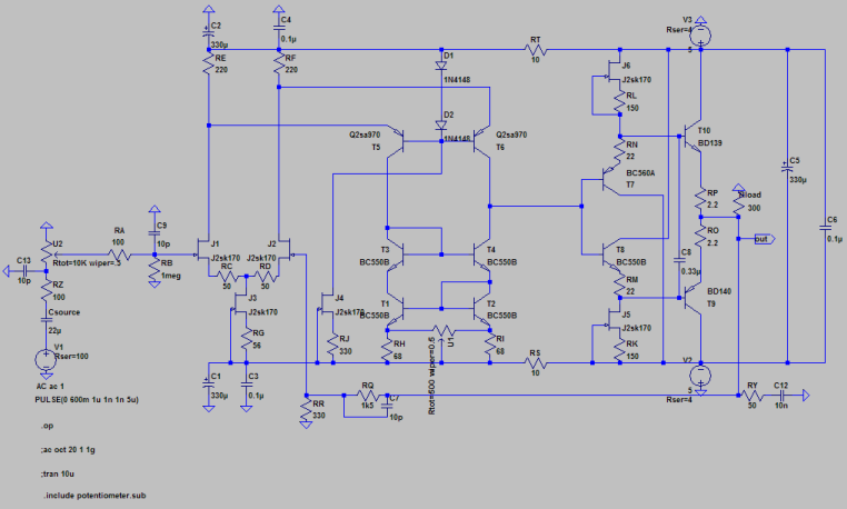

This design will be very sensitive with temperature, and much worse, OLG will be highly temperature dependent.
Nelson, try to make first a simple CCS as per your design and watch what is going with output current when temperature will change when your finger touch the jfet
This is a folded cascode design ... the LTP current MUST be very stable.
Hey guys.
I have a question regarding this circuit.
How do you calculate how much current is running on the folded cascode VAS stage?
Let's say we have 4mA of long tail current pair through the input stage. And then we have 160ohm of source resistors on the JFET sources. So we'll theoretically have the 4mA split into two into 2mA and 2mA each flowing through the resistors.
Since there's a split after the resistor, one to the collector of the cascode and another to the input stage, how does the bias diodes of the folded cascode stage interact with the long tail pair CCS and the source resistors so we can tune the total amount of current flowing across the vas stage?
Thanks.

TzeYang said:Hey guys.
Thanks.
Please read this:
http://www.diyaudio.com/forums/showthread.php?postid=119592#post119592
Jonathan CARR is a folded cascode guru.

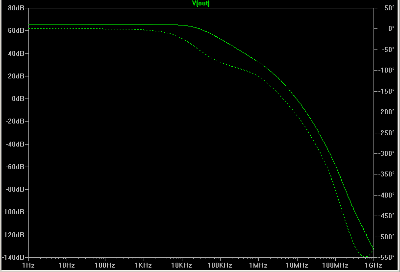

I got the pot, very handy, thank you very much. I also found an AD797 model and other candy there as well. Great!aparatusonitus said:There is a model for pot in LTSwCAD...
Could you show as a open loop response/phase margine?
I'm sorry to say I'm not clever enough to simulate OLG. Could I just choose some crazy high value for the feedback resistor?

I know JFET's are very temperature sensitive, but I didn't know it was crucial to have a stable CCS for the LTP in a folded cascode amp. Is it just as important to have a stable CCS for the cascode? What CCS would you suggest?roender said:This design will be very sensitive with temperature, and much worse, OLG will be highly temperature dependent.

So this is the modified circuit with RF filter on the input, Zoebel network on the output and resistors to isolate the rail-to-rail caps(not shown in the schematic, I was thinking something like 0.2 Ohm or so). Everthing is still star grounded. There's still some room to improve the LTP CCS so please make suggestions for it.
You have to click the links this time, I'm afraid. I hope they are visible in Malaysia as well.
http://www.esnips.com/doc/86de8630-59be-4887-99ba-5a6392256f5c/RF-filtered-folded-cascode
http://www.esnips.com/doc/43fc0893-410c-4efb-8f50-6e226f4a314f/RF-filtered-folded-cascode-lay
http://www.esnips.com/doc/9eda9084-1ae6-4bfb-89ab-7b44b32b0e2b/RF-filtered-folded-cascode-top
http://www.esnips.com/doc/68c49a34-5d49-4aa7-8741-198bb6627bd9/RF-filtered-folded-cascode-bottom

To simulate OL, you can try your idea.
Another way is to use a huge cap (Gigafarads for ex) in parallel to the RR resistor (330 Ohms).

Roender,
you have a good point. Being a portable amp, it will be exposed to some non usual temperature swings. To me a portable amp is one that is carried around on the bus, on the train, on the beach, on the skiing vacation etc etc.
Thinking of this, what performance loss would you excpect due to the thermal issues?
Sigurd
Sigurd

nelsonvandal said:I'm sorry to say I'm not clever enough to simulate OLG.
In LTSwCAD open File->examples->Educational->LoopGain2.asc, copy squared Vi and Ii (voltage and current source) and place them in your headamp circuit in the same manner, meaning you have to brake the feedback loop and place Vi and Ii between headamp output and load/feedback resistor. Vi and Ii will became Vi1 and Ii1 after paste, so just rename them to Vi and Ii again. Then place in your sch this spice directive
.step param prb list -1 1 ; set prb=0 to turn off probe
.ac dec 30 .1 100Meg
and this comment
-1/(1-1/(2*(I(Vi)@1*V(x)@2-V(x)@1*I(Vi)@2)+V(x)@1+I(Vi)@2))
Then all others spice directive mark as comment, copy -1/(1-1/(2*(I(Vi)@1*V(x)@2-V(x)@1*I(Vi)@2)+V(x)@1+I(Vi)@2)) expression, ran the AC analysis, in "select visible waveforms" card ALT+double click to enter expression, Ctrl+M, paste -1/(1-1/(2*(I(Vi)@1*V(x)@2-V(x)@1*I(Vi)@2)+V(x)@1+I(Vi)@2)) expression, press OK, now you should be able to see your open loop/phase response. Now, place your cursor over green -1/(1-1/(2*(I(Vi)@1*V(x)@2-V(x)@1*I(Vi)@2)+V(x)@1+I(Vi)@2)), right click, in attached cursor choose 1st, press OK, move with mouse (press left and hold) vertical line until horizontal one reach 0dB. Now you can see at LoopGain card your Freq., Magnitude, phase and Group Delay. Forgot to say, you input should be grounded while performing this!
... or you can just post your asc file here and I will do it.
