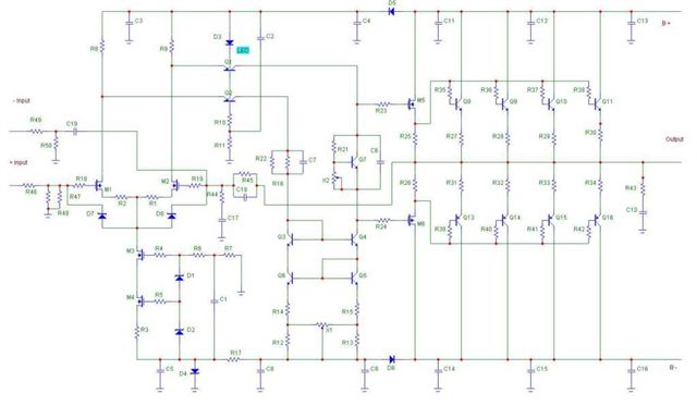

So I guess Diamante is a very clever amp with it's current sources on the LTP and improved Wilson current mirror, trimable bias and DC-offset.
lineup said:
I have chosen ~0.6 Volt drop across those 300 Ohm resistors
Because 0.5 mA x 1221 Ohm = 0.6 Volt.
The BC560C, U7, will give some temp compensation.
Regards, Lineup
AndrewT said:Hi Lineup,
is the LTP tail current =4mA?
My attached detail of my JFET input AD797:
http://www.diyaudio.com/forums/attachment.php?s=&postid=1528754&stamp=1212581188
( From 2006, when there wasn't at all as much hype about this great Op-Amp )
Each of the U1, U2, U3 and U4 runs at 1 mA.
For simpicity 😀
The sum, 4 mA is provided across the two 300 Ohm resistors.
600 mV across 300 Ohm = 2 mA
Regards, Lineup
I only get ~130 uA through U3 and U4 when simulating with theese values. But then I don't use a CCS to sink current from the cascodes like in AD797.lineup said:
For simpicity 😀
Regards, Lineup

Do you have a link? Are there any schematic with the parts specified? Even these gurus use resistors on the LTP, just one LED and resistors for biasing the cascode, and there are degenerating resistors on the LTP (even though it's mosfets and not jfets). That's good news, since I want as low part count as possible and a stable circuit with some margins.
then you have not done like my schematic.
It is pure mathematics.
The voltage at U3 and U4 bases is:
= 0.5 mA x 1221 Ohm + the voltage drop across U7 (BC560C also)
= 0.6 + ~0.65 gives ~ 1,25 Volt
Drop across both 300 Ohms resistors will be 1.25 - Vbe of U3/U4
which will be same voltage as across R1, 1221 Ohm
Which is 0.6 Volt.
0.6 / 300 Ohm = 2 mA.
As the input transistors works at 1 mA,
the left over is 1 mA, for each of U3 and U4.
By adusting this resistor R1, it is possible to fine-tune the current through U3/U4. (this is why the odd value of 1221 Ohm)
nelsonvandal,
the folded cascode arrangement does not place the JFETs into a more linear working region, does not decrease the highly destructive Miller capacitances, thus does not extend the dynamic bandwidth, does not provide a more favourable load nor isolation and does not improve power supply ripple rejection.
It does not achieve much of value.
No source resistors most importantly means strongly increased interelectrode capacitances compared to typical conditions like 2mA/side and Rs 100Ohm.

I'd like to discuss the folded cascode in a more technical way. Roender gave links to some excellent earlier threads.
Does, for example, a folded cascode not fix the voltage over the cascoded device? Then the term 'cascode' may indeed be misleading.
