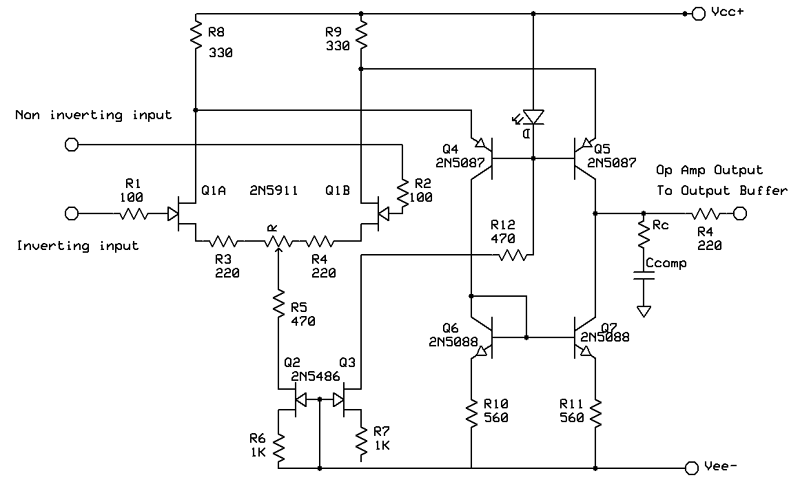

Maybe I should ditch this project. There aren't many folded cascodes to clone or "be inspired" by, and I'm not really clever enough to understand and calculate what's needed. When simulating the Diamante, I find the same problems, and except for that I have only seen one more schematic for a folded cascode. That amp use a 5.6 V zener as voltage source, and that drop is also greater than the drop in the diff stage resistor and Vbe. Still they simulate extremely well.
There are so many topologies to choose from, but the folded cascode seems so good, and the monolithic opamps using it are amongst the best.
Dont give up so soon, a folded cascode discrete like this can really sound great. Theres no need for so much complexity in your diamond buffer, just stick to a basic one, the diffrence is gonna be very small if any. Look for jxc in these threads, he has this topology well sorted out, and could help you.
A tip i could give you here is about the compensation. C3, if im seeing correctly, connected directly to the ltp feedback node and of a smaller value say 3p. This is phase lead, will increase your phase margin, affects the slewrate less and gives the amp a warmer sound. You should see a decrease in the higher order harmonics which is responsible for the warmer sound. This way you could also ditch the cap across the feedback resistor. C3 connected the way it is will indeed drop distortion figures but that is no garantee that it will sound any better and maybe worse.
Dont make thd your boss, anything aound -80db and lower is already very good.
Ps no need for degeneration with Jfets, it will increase noise substantially.

You may also want to Spice a supersym topology folded cascode with inv and non-inv output stages which can be bridged. The DC servo needs both +/- feedback, but can sum into one of the cascode current sources to null out DC, instead of summing to the input which seems to my ears to dull the dynamics
Thank you for the schematic. It simulates excellent, and the increased bias should be healthier for JFETs, as I'm told. Still the voltage drop over the LTP resistors is 1 V while the LED has a 1.7 V drop. I can't see why the drop should be equal though. In this circuit the voltage swing is reduced, but if I use two silicon diodes the voltage swing is close to within 1 V from rails.jam said:Nelsonvandel,

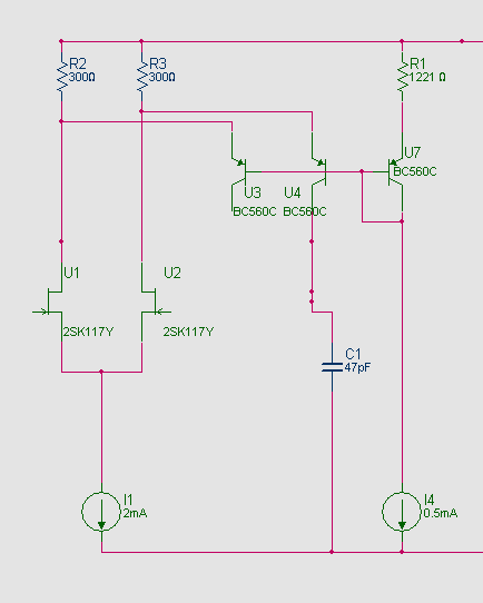

In december 2006, one and a half year ago,
I did a series of 'Clones' and Simulation designs of AD797.
The ultimate version was this:
High Voltage ( 100 V JFETs ) JFET input, AD797 Clone
http://www.diyaudio.com/forums/showthread.php?postid=1087124#post1087124
Look at my Attachment capture from circuit.
This is from a very good working version of my AD797 Clone.
It is a JFET input version, that was tested before I did my +-40 VDC version with high voltage JFETs.
Uses 2SK117, almost identical data to 2SK170, except from that 2SK117 can take 50 Volt.
I have chosen ~0.6 Volt drop across those 300 Ohm resistors
Because 0.5 mA x 1221 Ohm = 0.6 Volt.
The BC560C, U7, will give some temp compensation.
Regards, Lineup
