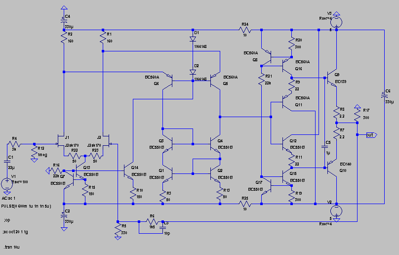

I've taken your advice regarding higher current, and simulated this. It still simulates very good, and I think I'll go for this for L/R channels.
There's 4 mA to the input diff and 2 mA to each of the cascodes. When using two diodes instead of a LED for biasing the cascode the voltage swings to within 1 V from rails. Now I have to decide if I'm going to breadboard it or order a PCB.
Changing just a couple of resistors and capacitors, I can use bipolars instead of JFETs.

A nice design. Good work!
I would add some more decoupling caps, though. Say 100n PP caps on the rails on 2 positions on the PCB.
DC offset might need some attention. One way to keep when temp changes, is to glue the two input JFETs together. Or use shrink wrap or a copper tube.

nelsonvandal said:I've taken your advice regarding higher current, and simulated this. It still simulates very good, and I think I'll go for this for L/R channels.

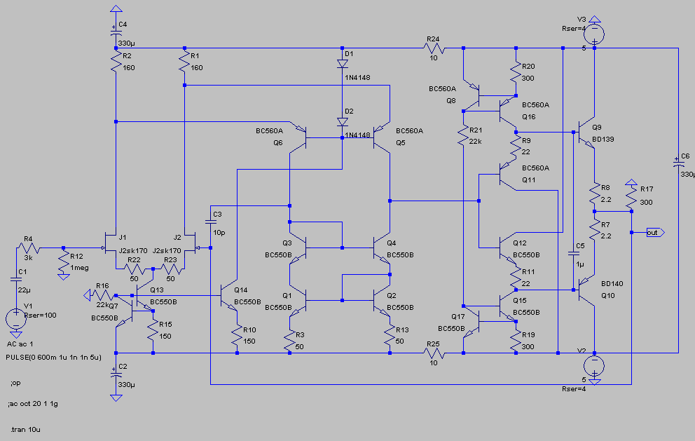

Lineup's suggestions for further experimentation sound very sensible.
How about a cascoded FET CCS? a BF245C wrapped around a BF244A and no resistors required, just two cheap components.
AndrewT said:Lineup's suggestions for further experimentation sound very sensible.

For a Headphone amplifier, however, we often do not need much Voltage gain (16/32 Ohms phones).
And so we can skip cascoding (keeping a simple & good circuit).
And do just as good Hi-Fi Quality output.

I've used JFETs as CCS before (mainly 2N5484 and 5486), and I agree that they are brilliant as you don't have to connect them to ground, but you do need a resistor because of the large spread of IDSS. I find bipolars more reliable when simulating, but I'll probably use JFETs in real life. The problem here in Sweden, is that they don't come cheap, and are hard to find. 2SK170 is really the cheapest alternative here. They are 4.85 SEK each when bying 25 units and BF245 is 5.52 SEK.
I have lot's of BC327/337, and I have used them as output devices in several diamond buffers. I find the BD's warmer with a weightier bass and smoother treble. But the TO92 package is more attractive in a portable amp, and I was thinking of BC639/640, but I've never heard them or seen anyone else use them. I guess they're a lot like the BD's.
Maybe I should give MJE15030/31 a try. There aren't so many alternatives here. I buy most of my stuff from ELFA, because it's only a couple of km's from where I live, and it's expensive to order from abroad.
The amp is intended for battery use and with an active ground channel, so I don't know if chasing even lower PSRR is worth it.

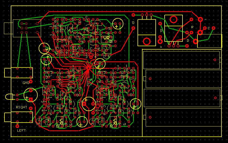

I took your advice and added trimpots for DC-offset. The amp will look something like this. I wish I was handy with Eagle or a PCB-layout program that can produce gerber files. Do you have any recommendations? Preferably easier to handle than Eagle.
It's not debugged yet.

After some fiddling with SprintLayout, this is the best I can do. It's not easy to place 3 channels inside a square area. As you understand, it has an active ground channel. Not shown in the schematics is the TLE2426 used as virtual ground. I forgot to place C8 in the ground channel, so it has to be stuffed in as a "bug".
It's intended for throughhole transistors and tombstoned or SMD (805) components.
I know it looks like a rats nest, but do you see any obvious errors? Did I get the JFETs right, or should they be turned 180 degrees?
Do I benefit from using a ground plane and connect it to "shield"? When using star ground, is there any reason to use a ground breaking resistor?
I think it's a bit weird to have 3 rail-to-rail caps in parallel at a distance from each other, should I use small resistors to "isolate" them/the channels from each other?

Good to see that you are progressing! Is that your first layout? Can't be. Good work!
I think you have forgotten an input filter that will remove any
high freq stuff. I see you have a 3k in series with the input SK170 - do you use that resistor and the input capacitance of the LTP as an LP-filter?
If not, I would add a cap after the 3k resistor to get an RF filter.
The -3dB frreq for the HP filter looks high - what is the -3dB freq for the HP filter?
Not sure what headphones you will be using, but did you consider a Zoebel network at the output?
Good that you put in a pot for adjusting DC-offset!
I would make that a very, very good pot.
I would add the volume pot into the simulation file, and check for any issues with the pot. I always use a 10k pot.
What value do you plan to use?
Using a GND plane is a good idea. You can even have it on both sides of the PCB.
I would use a small resistor to isolate each ch from eachother as you say.
BTW,
do you have a complete schematic which includes the PS?
Sigurd
nelsonvandal said:After some fiddling with SprintLayout, this is the best I can do. It's not easy to place 3 channels inside a square area. As you understand, it has an active ground channel. Not shown in the schematics is the TLE2426 used as virtual ground. I forgot to place C8 in the ground channel, so it has to be stuffed in as a "bug".
Thank you very much for your constructive suggestions. I don't have any in-depth knowledge as you probably already know. I started to DIY because I wasn't happy with the amps I bought. There are absolutely no portable discrete headphone amps out there (and if there was they would be darn expensive), so I have to make it myself.Sigurd Ruschkow said:Good to see that you are progressing! Is that your first layout? Can't be. Good work!

Yes, this is actually my first layout. The other amps I've built have been breadboarded or built on PCB's made by others. I don't like Eagle (and it's too expenesive), so I've never bothered to learn it and lay out PCB's, but now I've found SprintLayout.
I was hoping the input capacitance of the JFET's would do the job as input filter, but maybe I should add some small capacitors there. I think there's room left. Otherwise I could easily parallel the RB resistors. When using Hammond 1455J1201, there's plenty of room on the bottomside of the board.
- 3dB is at 5MHz. Do you think I should use a larger cap? What - 3dB frequency would be appropriate?
I use Sennheiser HD650, 300 Ohm. I've had some trouble before when connecting phones (or even a straight cord), and I've cured it with ferrite beads. I've experimented with Zoebel networks, and it also did the job. I think I can add a Zoebel. Do you think it's for the better, and what values should I use?
I'm planning on using a 10 k Alps RK09 pot. I'll add it to LTSpice. The reason there's a power switch is that ELFA doesn't stock this pot with built in switch.
The batteries are the PSU. It's intended to be portable. I'm using a TLE2426 as railsplitter and an active ground channel instead of large caps sinking current from the phones. I'm just going to use a 24 V AC-DC wallwart. I have one with an added LM317T adjustable from 16 - 20 V.
I would add a small filter directly at the inputs. 50 Ohm in series and 100pF to GND will be a nice filter against RF and that directly on the
phono jacks.
If there is space, I would add a Zoebel filter on the outputs. The exact values I cannot give you as that depends on the load, but you can start with 50 Ohms and 10n.
With a 10k pot and your 3k series resistance, I think you will note that maybe 3k is rather high. I use 50 or 100 Ohms but then I also use a cap to create the RF filter.
Your HP filter is OK - I misread the values. That cap will affect sonics, IMO, and you might want to use the best cap you can fit.
2.2u or even 0,22n will be fine, and you can then choose a better cap compared to using a huge 22u cap. Polystyrene or polypropylene are the types I would use.
You might want to consider matching the JFETs for IDss. It is easy to do but you do need a bunch of them to find matches.
It looks like the VR resistors do the same job as the pot, ie adjusting DC offset. Do you really need the VR resistors?
BTW,
ferrite beads is not something that I would use in the signal path.
Do post some photos of your assembled PCB.
Sigurd
phono jacks.
BTW,
Sigurd
I've never thought of how the pot affects the circuit before. Thanks for pointing it out. I've noticed how amplifiers sound different at different volume positions, in another way than just loudness. Now I know why.
I've added Zoebels to the board, 805 SMD parts.
So you're saying that I should use one RF-filter just after the jack, before the pot, and one just before the transistor input? Did I get you right? There's room for it, I think.
I misunderstood your question about HP-filter. I was thinking LP. You mean the 22 uF cap on the input. I have it there to simulate my DAP. I use 22 uF BlackGate HiQ's instead of the original tantalums. I'm not using any input caps in this amp.
VR1/VR2 are the offset pot. Threre's no model for a pot in LTSpice.
I am going to match the JFET's. Since I'm planning on using them as current sources, I'm going to need many. As current sources, I adjust the current with resistors.
I'll post pictures of the amp later on. I'm not used to order boards, so I hope I get it right. I've only done it once before, but that board were layed out by by Nico Ras, and with gerbers and drill files all ready to roll.
I've learnt a lot today🙂

nelsonvandal said:VR1/VR2 are the offset pot. Threre's no model for a pot in LTSpice.
There is a model for pot in LTSwCAD, but first you have to register to http://groups.yahoo.com/ (LTSpice group) then look here for pot symbol and subcircuit model.
http://tech.groups.yahoo.com/group/LTspice/files/ Lib/Potentiometer/
Could you show as a open loop response/phase margine?
a larger pot value will affect the circuit even more, so I am glad to read that you use a 10k pot and not a 100k pot.
In my oppinion, a small filter at the input is enough if you have a well-shielded box and no long wires from the connectors to the PCB.
Ah, good to read that you skipped the huge input cap. Do check how much DC comes from the source as you wil amplify the DC offset from the source with your amp's gain, and even though you will adjust your amp with a short circuited input (standard way of doing it) to be zero V, you might get DC at the output of your amp when the real source is concted to your input.
If you have a VR-pot which is to null DC offset, may I ask why there is a pot on the input stage, too?
Sigurd
PS I think you will learn a lot getting a PCB in your hand from the PCB manufacturer with the input files from the layout program you use. It will be fun!
Sigurd
