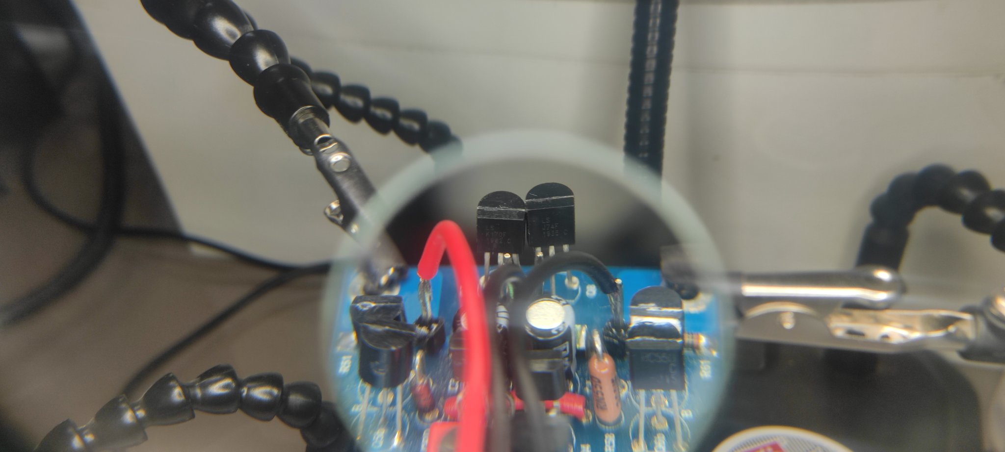

I built one board but ran into issue. I had the one of the current mirror pfet orientation incorrect (Q5a/b). When testing this, the output buffer transistors got really hot. Voltage on output was -11V.
Once I corrected the direction of pfet, I quickly checked by turning on the circuit for few seconds and I still see -10V on the output. I am scared to keep the circuit running since it may damage some other component. Any guidance on how to proceed? Is it safe to run the circuit for debugging?
Ok, I have found the issue.
Q8 is supposed to be K170 but I see it is J74. Basically, the quad K170 I bought from diyaudio store had sent one of the transistors in Quad K170 as J74. For a moment, I thought I might have soldered from nnpp set but that set still has k170 and j74. So, I will build the other board and check and will contact the store and check about replacement.
Moral - read and confirm the components before soldering.
Here is the pic
Most likely some other transistors are damaged.
You need to remove them all and test one by one.
Either will a transistor tester, or many information on the internet.
And you should be using lab supplies with current limit set to ~30mA.
Patrick

Hello Patrick
I replaced the pfet J74 that was accidentally soldered at Q8 with nfet J170 and I got the output offset to 50mV. Later, I realized that both jfet's in output stage needs to be matched and hence I changed the other nfet (Q7) as well from the matched pair of nfet's. After this change, I get offset close to 2mV. So I think the board is working fine now. I will keep the power supply on for some time and check if offset drifts.
On the other board, the first power up yielded output offset of around 2.5mV and I assume is fine as well.
Once I check the output offset 10-15mins after applying power supply and making sure it is fine, I will connect it to DAC and check. Thanks to you and Fran for this circuit, group buy and support.

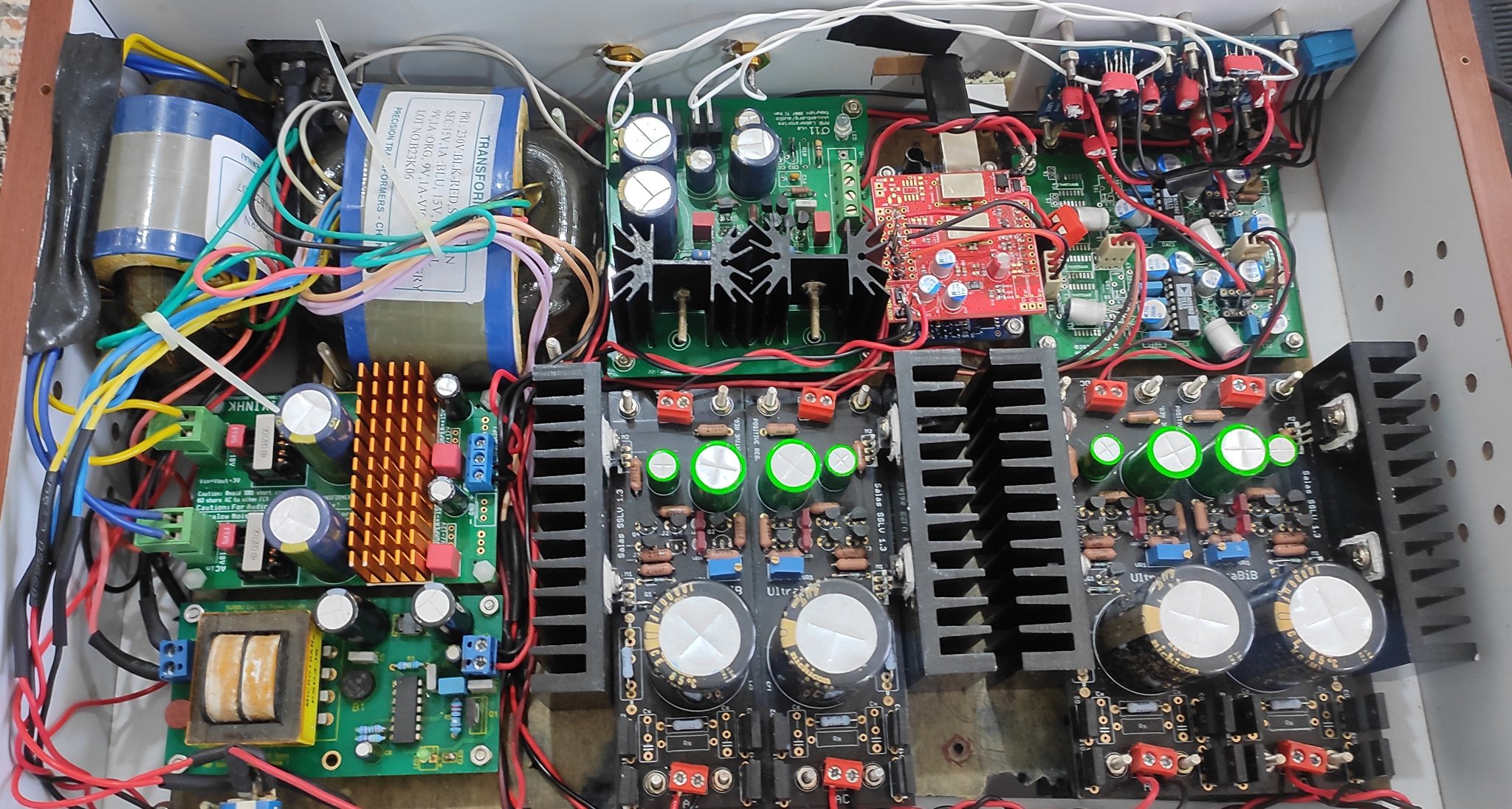

I wanted to document my FC CEN IV build here so that it will be helpful for others. I built my boards for AD1862 DAC and had multiple churns to get it working.
1. After initial build and getting the output bias close to 0mV, I tried playing from the DAC but there was no sound. I was wondering if the DAC board had an issue but the DAC worked earlier with opamp output stage. So, I started debugging the IV boards.
2. As part of debugging, I found out that Rt3 and Rt4 should be present else the circuit will not work. I was thinking these resistors are needed for adjusting bias through MOSFET and since I got matched MOSFET's and resistors from Fran, I thought I can skip Rt3/Rt4. Once I realized they are needed, I soldered them on and then I noticed offset moving lot more than before. I feel this is a good way to build this circuit. First build the boards without Rt3/Rt4 and ensure the offset is low (you will ensure other part of circuit is fine and not risk the MOSFET's). Then you can add Rt3/4 and continue. Let me know what you think about this.
3. Once I was done with this, I did not thermally couple the current mirrors and input/output pairs. This caused the offset to wander a lot more than I expected. Once I thermally coupled them with slight dab of heatsink paste and heat shrink wrap, it became more stable. So it is important not to skip this step.
4. Once I had offset close to 10mV, I tried playing through it and I noticed that the offset is stable without any inputs but when I connected it to laptop through the USB board, it starts wandering. I later realized may be this is normal since this is IV converter and this is expected? Please let me know if my understanding is correct.
5. After all this, I connected it to test speakers and heard music. I was very happy to have completed this build. I will let it settle for sometime before I check it in my main system.
Please let me know your thoughts on some of the above points.
Balaji
Reactions: twitchie and jimk04
