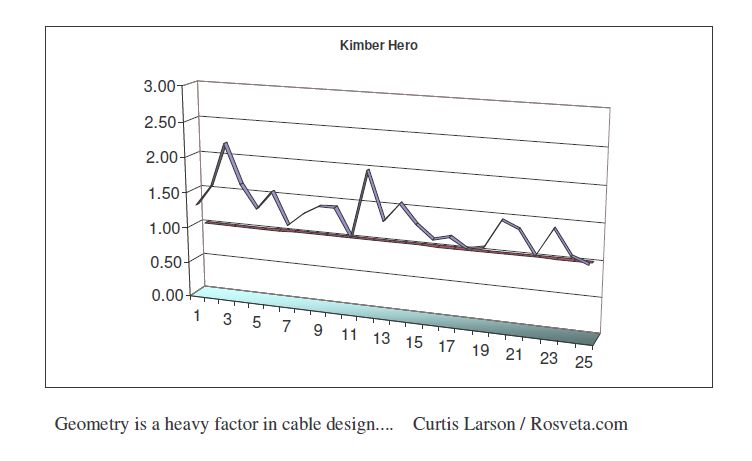

"Ugh" is understandable when graphs are shown to "prove" a point but carry no dimensions whatsoever so they actually mean nothing.
A small sample:

Exactly. Worthless waste of bandwidth.
Well yeah, that's understandable, and shows me something I may not have known or noticed...."Ugh"makes no reference to anything specific, and is just a sarcastic and unhelpful utterance. I mean, if there's nothing constructive to say, even if it's in disagreement, it's really chicken ****."Ugh" is understandable when graphs are shown to "prove" a point but carry no dimensions whatsoever so they actually mean nothing.
A small sample:
Yep, bunch of useless calculations with zero applicability to the frequencies we call, sound. Looking carefully at the "proof" via a Smith chart...noting the small print, "starting" at 100Khz...and ending at 1.8 Mhz.

Where to start? Ugh is the most succinct summation to the whole steaming mess.
not meant to prove anything - just showing the differences in cable designs"Ugh" is understandable when graphs are shown to "prove" a point but carry no dimensions whatsoever so they actually mean nothing.
A small sample:
which can help guide us in designing better cables ---

But not using units makes those so called "graphs" just a set of squiggly lines with no meaning.
What does this graph represent
Golliwands per thoroflics?
Satbemeles per chichicorns?
As clear as saying "bread costs 239 ...."
* HOW MUCH bread?
Grams/pounds/bushels/Tons/slices/loaves/............
* what currency is being used?
Dollars/Rupees/Yen/Renminbi/Bitcoin/seashells/.......
* HOW MUCH bread?

Read Lady Fidelity free - quick answer: RF Parameters graphed used for comparisonBut not using units makes those so called "graphs" just a set of squiggly lines with no meaning.
* HOW MUCH bread?
with other cable designs. LIKE:
The Micro-Twin has:
1.) 2.56 more Capacitance
2.) ~1/6 the Inductance,
3.) ~1/10 the DC resistance,
4.) L/C ratio is ~1/15,
5.) less Xc: 1/2.57
6.) less Xl: 1/6,
7.) a greater Xl/Xc ratio by 2.37 times,
8.) less Total Impedance Z: 1/2.56,
9.) SWR is less by 1/4.2,
10.) Cable Zo is 1/4,
11.) Calculated Frequency Resonance is 1.54 times higher,
12.) L/C ratio compared to the Resonant Frequency is 24 times greater.
13, 14, 15 and 16 same as the 1 kHz ratios.
17.) Cable Q is 4 times greater
18.) Q of Total impedance and Cables Zo is 1.54 greater
19.) Q and ratio of Resonant Frequency is 2.23 greater
20.) Resonant Frequency and Cable Zo is 6 times more
21.) Resonant Frequency and Xc is 4 times more
22.) Qa 377 / [L/C] is less: 1/1.54
23.) Z Wave 377 L/C is less by 1/4
24.) Zo/rdc (SWR) is 2.69 times more
25.) Q-line is 1.24 more.
As compared to KIMBER'S HERO CABLE lower
reading-measurement- calculations in the graph.
There are many ways of measuring and through different ways
we are able to see differences - many tools exist to make measurements
the ability to use these different measurements take experience...
Cj

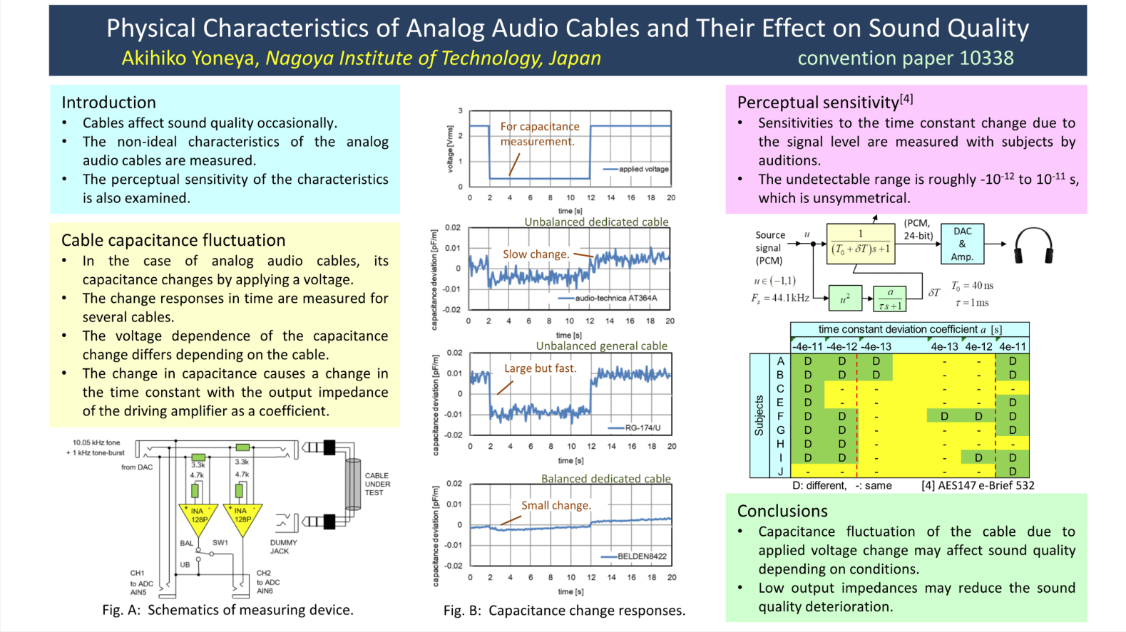

One of the issues with cables is that some cable threads have already described experimental research results on what works best for different audio cable applications. There are also some AES papers on line level and headphone cables. What is perplexing is why people keep starting over from scratch with foil cables. Also perplexing that other people fail to measure factors that can affect cable performance.
AES:
https://www.aes.org/e-lib/browse.cfm?elib=20755
https://www.aes.org/e-lib/browse.cfm?elib=20555
If anyone wants to get really advanced maybe consider modeling and or measurements in the following non-audio papers:
https://www.semanticscholar.org/paper/ADVANCED-MEASUREMENT-OF-AC-RESISTANCE-ON-REDUCED-Schröder-Kaumanns/760e69b023d325b4f3610c2545055d58c4a4a987
https://www.researchgate.net/public...tion_of_water_tree_degradation_in_XLPE_cables
Then there are the posts of @Hans Polak towards the later part of the thread at (regarding lumped compensation of zip cord):
https://www.diyaudio.com/community/threads/zip-cord-for-speaker-test.371099/

I tend to agree with Jim here. The graphs are meaningless without units on the axis.not meant to prove anything - just showing the differences in cable designs

Yes they are at first glance meaningless... these graphs have no direct statndard relationship to common tests,I tend to agree with Jim here. The graphs are meaningless without units on the axis.
How any measurement reflects what is heard is also in question. Showing different measurements and claiming one specific metric is better for determination of cable "goodness" requires actual backup data, tests..
While I am a proponent of bringing the speaker cable impedance into the realm of 25 ohms or so (RF impedance) to control voice coil impedance variations vs velocity and acceleration, it is based only on my understandings as a "seasoned EE" of what is happening in the full system from the wires to the magnetic flux in the VC gap.

but as stated to Jim they represent RF Formulas graphed by using the cables tested: R L C Zo and such.
'RF' Calculations
The characteristic L-C-R and several 'RF' calculations
were used to generate the following comparison charts.
Columns are:
1 C - Farad
2 L - Henry
3 L/C Ratio
4 R - Ohms
5 Xc
6 XL
7 XL/XC 1kHz Ratio
8 Z-Total [Xc, Xl, Rdc]
9 SWR-50 [Zo/ 50 Ohm Reference]
10 Zo-Cable [Zo of C and L]
11 Frequency Resonance [Fr] [of C & L]
12 Fr / L-C ratio @ Xc 20 kHz
13 Xc 20 kHz
14 Xl 20 kHz
15 Zt 20 kHz
16 XL/XC Ratio 20 kHz
17 QZt / Rdc [Q = Zt / Rdc]
18 QZt / Zo [QZt = Zt / Zo (of cable)]
19 Q/Fr [QZt / Fr; resonant frequency of the cable]
20 Fr / Zo [Frequency Resonance / Zo]
21 Fr / Xc-1 kHz [Frequency Resonance / Xc]
22 Qa 377 LC [Air Impedance ~377 * SQR (L*C)]
23 Z Wave 377 L/C [Air Impedance ~377 * SQR (L/C)]
24 Zo / Rdc (swr) [Zo / Rdc]
25 Q - Line [.085 * SQR Fr]
By using these odd graphs we can see major differences in the tested cables.
How to apply anything from these graphs was my challenge.
Thanks,
Cj
