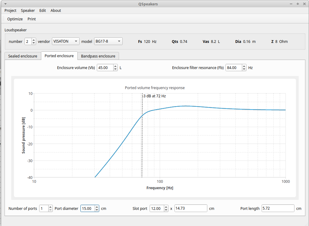

I've been planning to build a powered speaker project to be used as a small P.A. system or personal monitor at our music jams. To keep things simple and avoid having to futz with crossover design (which is quite hard to get right), I wanted a couple of full-range speakers for it. Speaker drive units with reasonably smooth frequency response, decent efficiency, at a reasonable price.
Guess what drivers I picked? Yup, two Visaton BG17s. 🙂

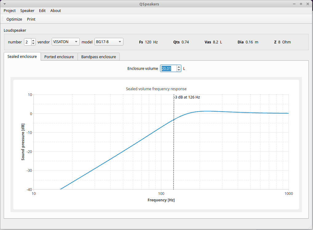

I haven't tried to measure the Thiele-Small parameters of the two Visaton BG17-8s I have, but just for kicks, I stuck the factory datasheet values into Qspeakers, a simple speaker box simulation software for Linux.
Somewhat to my surprise, given the rather high Qtc, fiddling around with a ported enclosure sim produced quite interesting results. For a pair of BG-17s, a 45-liter box with a big port tuned to about 84 Hz looks pretty good in the simulation (pic attached). Bass response looks pretty smooth, and the software thinks the speaker will get down to 72 Hz (-3 dB). The port has to be large diameter to get a reasonable port length, though; I don't know if that will turn out to be fussy to tune to the right frequency.
Qspeakers doesn't simulate speaker cone excursion at low frequencies, and this is another thing I'll have to keep an eye on if I do build the ported enclosure.
A 20-litre sealed box for the same pair of speakers is very simple, a lot smaller, and simulated frequency response isn't bad - but, of course, the bass response is a lot more limited, with a simulated lower f3dB at about 125 Hz. That might prove to be quite adequate for my purposes, actually.
If real-world bass response with actual drivers proves to be anywhere close to either simulation, I will be a happy camper. 🙂
The other interesting thing is that if I take a 2'x4' sheet of 3/4" plywood, and cut it up into four equal width strips (about 11 7/8" wide each), and add top and bottom panels, I end up with an internal volume that's in the right ballpark for the vented 45-litre enclosure. I think I have a 2'x4' sheet of 3/4" plywood lying around somewhere, too.
A wedge-shaped enclosure would be really nice, but do I want the additional design and build complexity? I have to think about that one.
