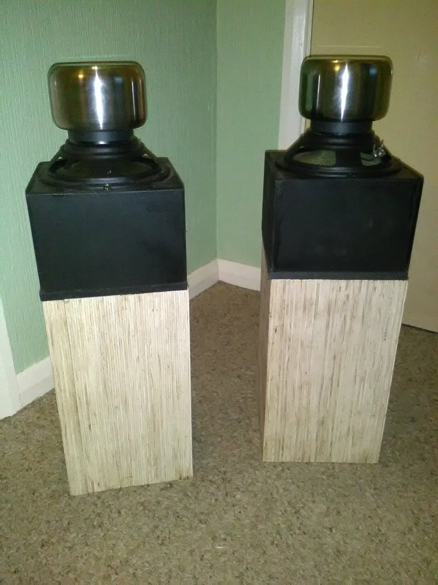

It's actually a really small enclosure, for a 40mm driver (that's "mounted magnet out" for an omnidirectional dispersion), the curve was simply done on a bandsaw, if I wanted to make a bigger one, I'd probably just cut a few curved bits of wood and glue them together. I've just received a pair of Visason BG17s and trying to decide on the best encloser, we seem to be going off the topic of foil cables, perhaps there's enough interest in this driver for a separate thread?That is an interesting enclosure!
I'm curious - how did you carve the curve into that large solid block of wood?
-Gnobuddy

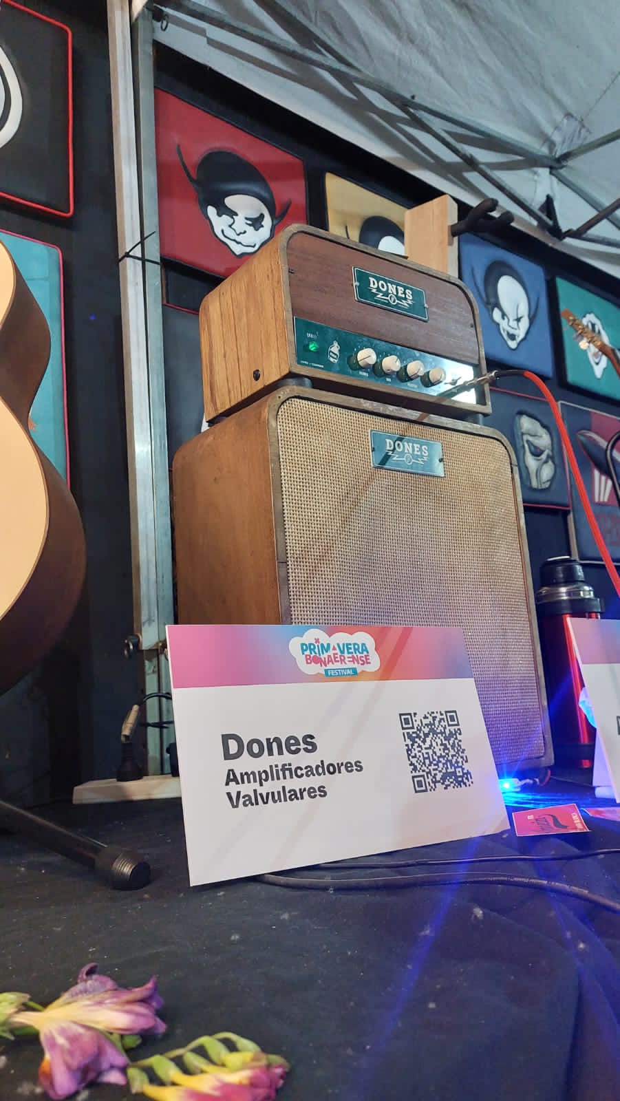

When I said my friend bends wood for his speaker and amp cabinets, I meant he BENDS them 😱 , I was amazed.And it still impresses me every time I look at the curved walls of my acoustic guitars. 🙂
One of them has a cutaway body, so the body walls have to curve quite tightly in that region. Amazing.
As far as I know, guitar walls are made with special "bendy plywood". Instead of alternating veneers oriented cross-grain to each other, all veneers have the grain in the same direction. That makes it possible to bend this type of wood, but only in one direction.
Long ago, I built balsa model aircraft, and you can curve a thin sheet of cross-grain balsa like that, particularly if you soak it in diluted ammonia first (Windex works).
For the loudspeaker enclosure, I would be tempted to use some other material, not wood. Maybe heavy cardboard, curved to shape and then given a coat of epoxy resin?
I know, DIY loudspeaker purists will be upset. But a curve like that is a very strong shape, and it's supported at both ends where it joins the sidewalls.
-Gnobuddy
Last Saturday I was in an Entrepreneur Fair with him, and he had an open unfinished cabinet to show construction, I forgot to take a picture, but here are the finished ones:
Mind you, it´s 12/15 mm plywood! 😱
looking at it again, it might be solid wood instead of plywood 😱
Doubly amazing 🙂
Beautiful, and I agree, amazing!... he BENDS them 😱 , I was amazed.
-Gnobuddy

Bend layers of 6mm plywood & bond together.When I said my friend bends wood for his speaker and amp cabinets, I meant he BENDS them 😱 , I was amazed.
The further from the neutral axis, the greater the change in length.
Limiting the thickness makes it do-able.
the pioneers of bent or formed plywood for furniture were Aalto, Eames and Saarinen. nice stuff
