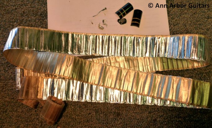

Back in the day I used to draw for my father, an electrical engineer, who designed for buildings. We once had a guy try to sell us on an under carpet cable system for open concept offices. The conductors were side by side. Trouble was it was designed to be used under carpet tile (which our architects never specified) and was really only good for straight runs of desks. I still have a short sample piece of it in a box in the basement.

There are several manufacturers of flat ribbon conductor speaker cables on the market. Alpha Core Goertz was very popular for a while. There are others if you search. I made a pair of silver foil Goertz style speaker cables about 20 years ago and used them without any issues with my Spectron Musician III class d amp and Gallo Nucleus speakers. I still have them somewhere. With the price of silver where it is now, they are probably worth many times what I paid. For those who say there are no advantages with silver cables, let me say that capital appreciation is real, lol...
Maybe one could just unwind a capacitor and use the foil for the project. 😝
One certainly could but it's not very cost efficient. Copper caps tend to be expensive and the foil thin. Foil inductors are the obvious cheap source.
Even cheaper is to just buy the foil - Mundorf sells 10 meter rolls for $10-$25, depending on width. Takes some of the sting out if they're a fail, and would look good on the Christmas Tree.One certainly could but it's not very cost efficient. Copper caps tend to be expensive and the foil thin. Foil inductors are the obvious cheap source.
