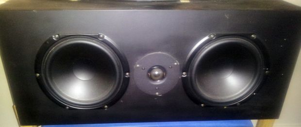

I got eight of these for a steal a year or so ago. Six have never been unpacked -two are in my center channel. Been watching for an FC design to use with them but they are 40 oz. so it would have to be pretty sturdy. You can't go wrong with the Vifa TC9 though. They have their own magic.
