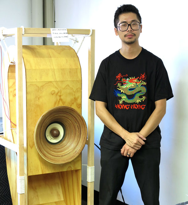

Don't think this has been posted yet - found it on a Burning Amp report. Appears to be suspended with rope.
I am familiar with this and have been contemplating a FC version. It is in the Zen Acousta thread by Kohu. Looks like a picture of Kohu next to his creation. IIRC, this thing is a Lowther Field Coil powered unit with no stuffing and very smooth internal walls. Very cool looking though.
