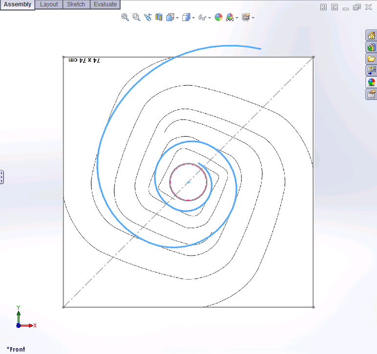

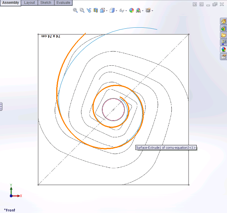

Quick update on the spiral cornu progress. I used the existing design as an underlay and did a first pass at the spiral using arc sections (see pic1, blue highlight). Then I mapped the clothoid (hyperbolic) over top of it. It turns out to be pretty close once you use the right part of the clothoid curve (see pic2, orange highlight). The cool part about the equation is that the wall curvature is now totally smooth. Seems close enough to me - what do you think?
