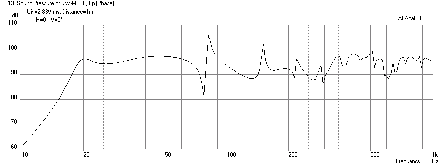

Goldwood GW-412D Monster FC Sub MLTL

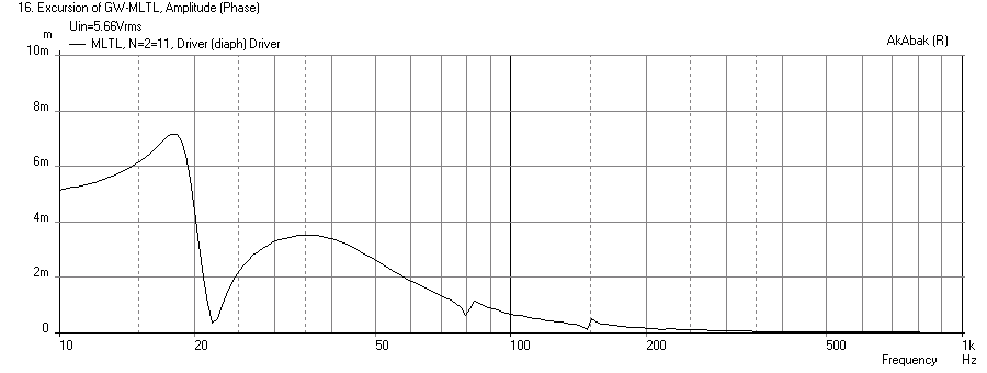

I just ran an AkAbak sim for the Goldwood monster foam core sub as a MLTL.
Design: 14 in wide baffle x 16 in deep cabinet x 96 in tall, with a 14 in wide x 4 in tall x 11 in deep "shelf vent" at the bottom. Use COPIOUS bracing with additional foam strips in both directions to reduce foam wall flex. In AkAbak, I optimized the driver location which appeared to give the best response with good efficiency when driver is mounted at 53 inches from the top (3.58 ft from floor - about seated ear level). The simulation doesn't yet account for stuffing so there are peaks that really shouldn't be there with proper damping. I would recommend starting with using stuffing at about 0.5 lb/ft^3 of pillow stuffing or polyfill in the top 64 inches of the speaker cabinet. Adjust to taste. I have also calculated speaker cone displacement at 4 watts - you will not want to exceed 4 watts if you have musical content below 20 Hz. Most amps crap out below 20 Hz anyway and you have a built in high pass based on low-end of amp. But the speaker max displacement is 3.5 mm so you should be under this if you stay below 4 watts at 20 Hz. Above 20 Hz, you can put more juice to it.
The frequency response chart is attached below and shows indeed 96 dB of SPL at 20 Hz driven by 1 watt at 1 meter with speaker back placed against the wall to minimize baffle step losses. And at 4 watts (5.66 volts) the speaker should produce 103 dB at 1 meter! Whamp, whamp, whamp, whamp, whamp !!! 😀
Let me know if this design sounds OK, and if you need more info.

The calculation above is for one of the voice coils in the DVC driver. With both coils firing and driven by a stereo amp, add 3 dB to the calcs above! 106 dB at 20 Hz with 4 watts per channel!!!! Yahhh baby! 😀
