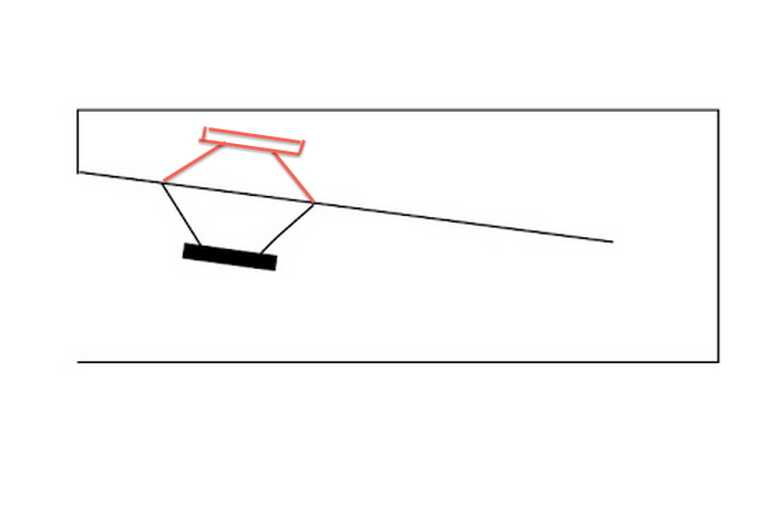

Thanks X, I can get what I need through work. Forgive me for not noticing the tapped horn stuff. I would like to do a clamshell [isobaric?] style as I have 4 small woofers and room for only 2 cabinets. I will have to look through the threads to see if this is something you can do.
When you say clamshell do you mean drivers are inside between two chambers with vent on one side? A 4th order bandpass sub cabinet?
See the pic. If you place another driver on the opposite side of where the driver is shown in a normal tapped horn and face it together it's called clamshelling. It's a type of isobaric loading. It allows for the downsizing of the cabinet by approximately 1/2. I wonder if it would work.
I really wonder if that will work
Me too but let's not forget the two products are different. the pink stuff is unfaced Type IV EPS made by Owens Corning. This is a faced iso board so I dare say the two are going to behave differently.
