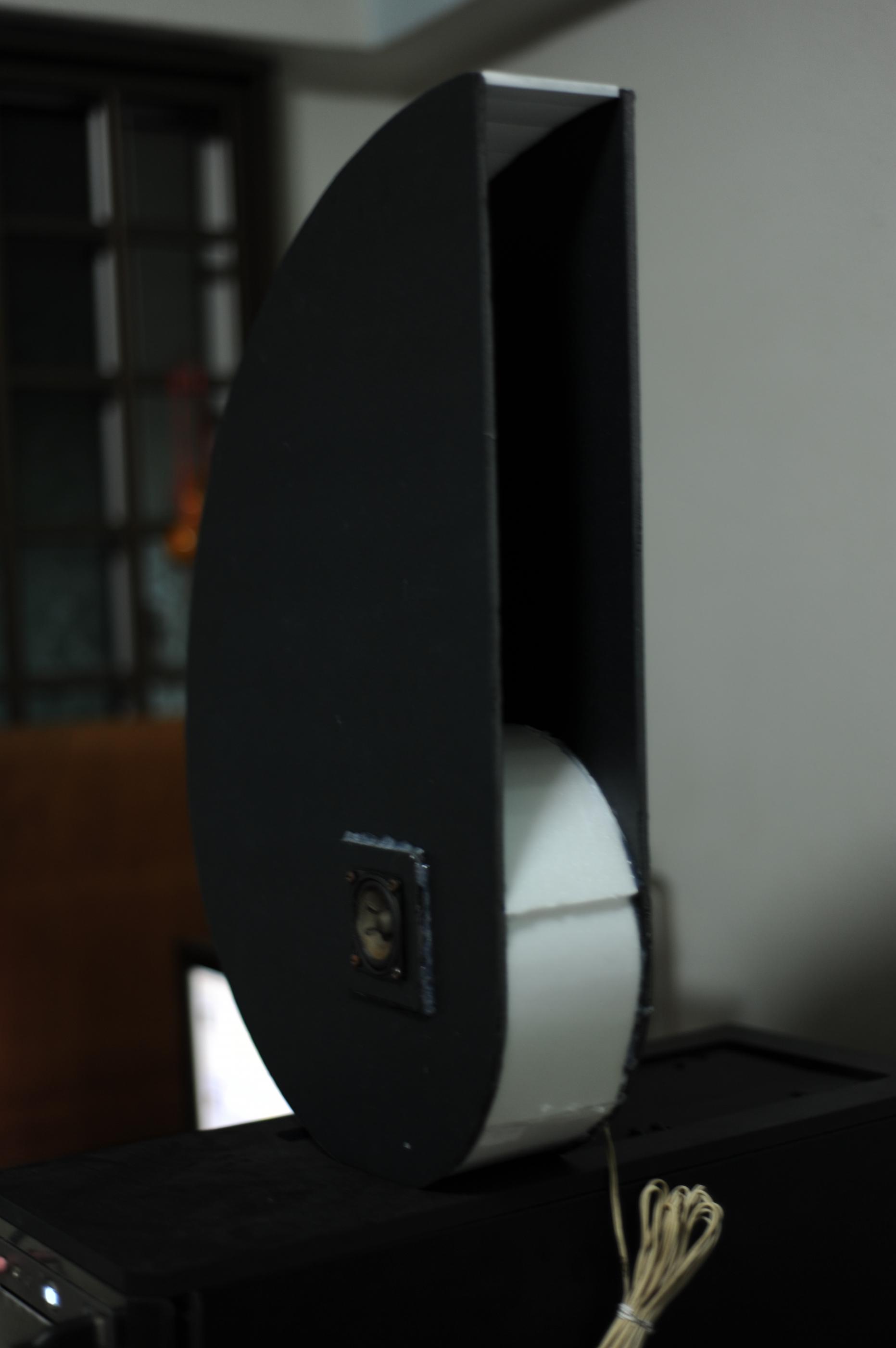

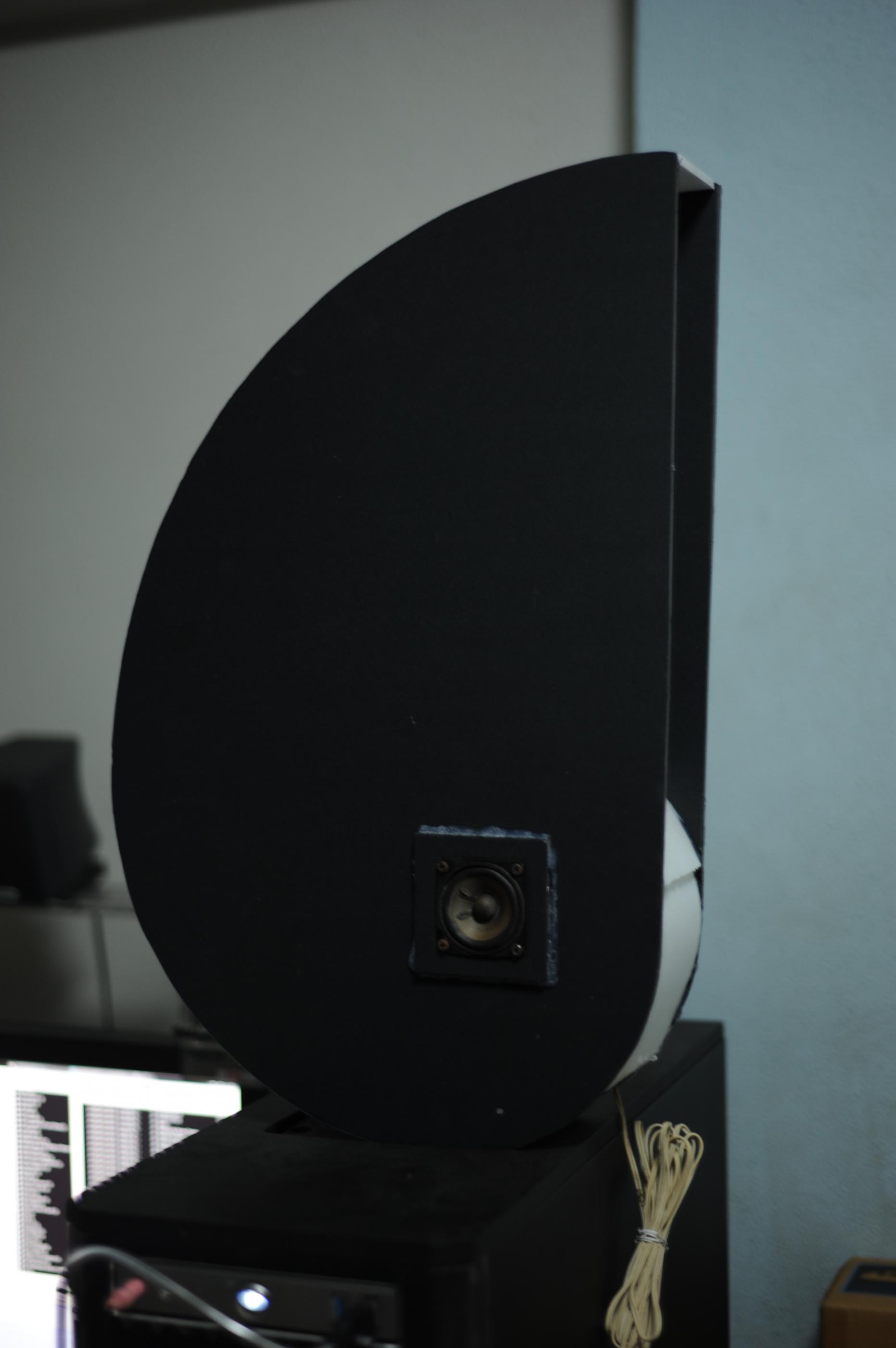

I'm a 43 year old basshead for life (2-15's in an 01 f150 supercrew), but I do appreciate tonal quality over volume quantity. That's the reason why I changed my T-TQWT from firing into the corner to firing 180* into the opposite direction in January 2012. The tonal balance is so much better. I troll this thread to get ideas on how I want to upgrade the main, center, and surround speakers to keep up with the sub.
I think I remember you running this from a headphone amp. If so it's the former. You can check but seeing how much cone movement you have with it begins to distort.
To be frank, there isn't much cone movement when it distorts, but it's very obvious that it's struggling when there are too much things going on.
Will see if I can hook it up to my Megaworks 550, 70W should be a plenty.
Yea, 70W RMS of power is pretty damn good, there are no distortion what-so-ever, even when the driver is supposed to be rated at 4W(I'm probably overloading them)
Only downside is, there is NO bass, the internal DSP of the Megaworks 550 actually filters the bass frequencies over to the sub...
and that my construction is not sturdy enough to actually hold the power being output by the driver, entire foam enclosure is rattling like a lose radiator grill.
the FiiO E11 outputs 180mW @ 32ohms, which means with my load at 4ohms, it should be supplying a max of 1.44W
pardon the crappy photos, lazy to put in the batteries for the flashgun.

The Fibonacci looks really nice. I can only imagine that the rattle is from your rather loose screw mounts for your driver. I have not had a problem with rattling on mine even at close to max volume from a 45 W amp. Did you glue some wood on the backside for screws to grip? Some foam gasket material between the driver and the foam board facer may also reduce the rattle. One other thing, did you put any bracing on the large areas in the horn - particularly near the mouth? I try not to have any span larger thaan 3 or 4 in without at least a brace made out of foam core stock about 2 in in length x height of the space you are trying to brace. That may reduce vibration of your large areas when the frequencies hit the natural resonance of the "drum" mode of the foam core panel. You may have enough room to reach in through the mouth and hot melt glue a brace or two - it should help.
I must confess, the bracing slipped my mind.
I do remember spamming a hell lot of glue round the screws and driver to make sure it's tight as a nut.
The rattling is actually coming from the mouth of the horn, particularly the external edge of the curve.
Nah, I'm not going to bother putting a brace in, this prototype is going to be scrapped and I'm going to make a new pair once the festivities is over - I'll be jobless by then(my company couldn't afford to keep me as production is low) - and have plenty of time on my hands to carefully craft things out.
Will take your advice into practice, i'm thinking of narrowing the width of the horn so i can make it longer, glowglass's spiral on the cornu thread gave me some inspiration to work on.
Well, this is my first attempt at a foam core enclosure, it's meant to be a practice attempt on how to build one, it's quite a rushed job, and the boards are quite shoddily put together I must say. I never thought to keep this one.
Hope you understand where I'm coming from.
ravener, too bad to hear about the bass. It may be the horn length is not enough before it gets to the mouth and basically causes cancellation? Or it is more likely that there is leakage and too little bracing and the bass is being lost to resonating the panels?
