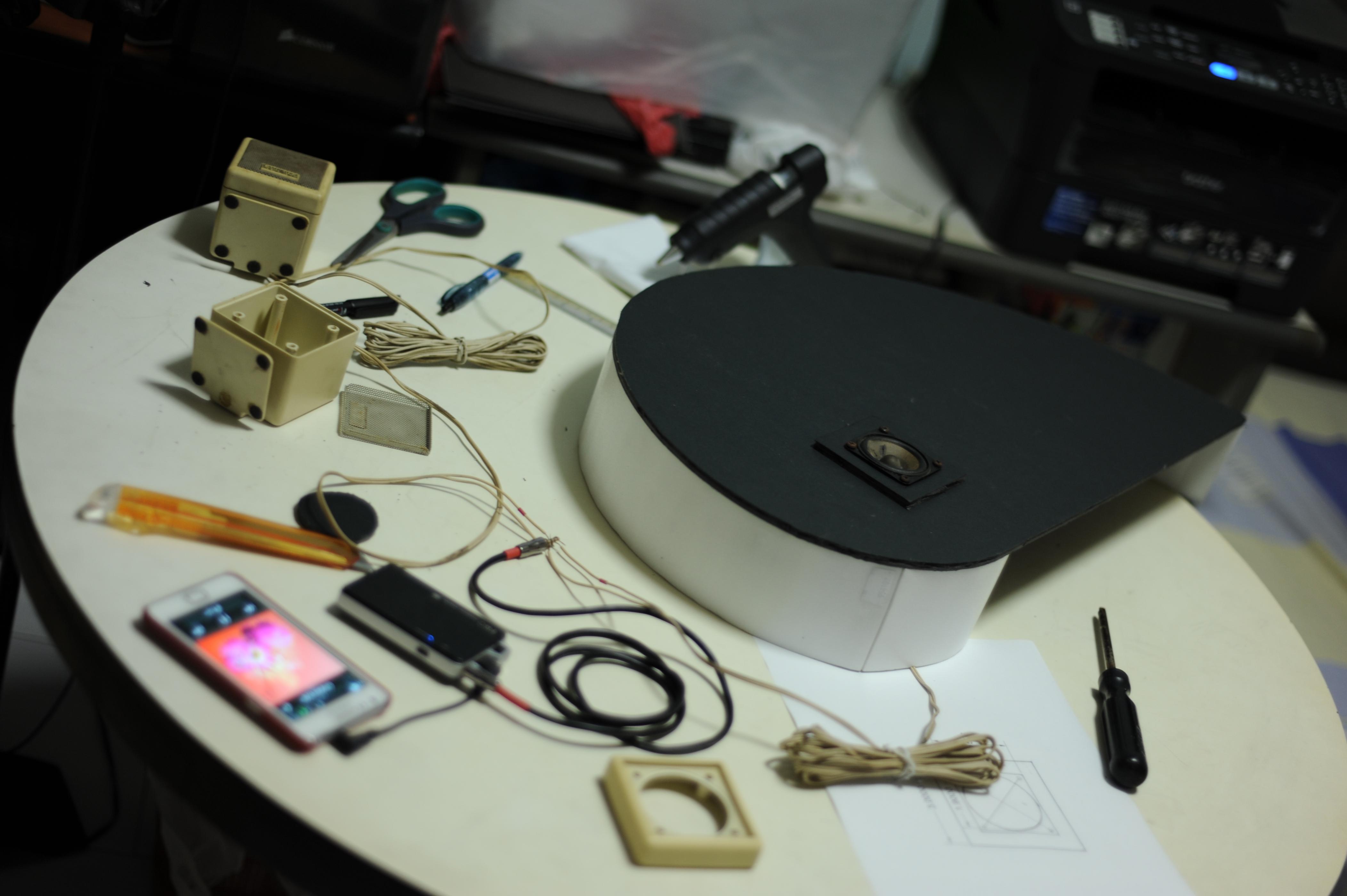

A little update:
Have yet to seal up the enclosure yet, trying to figure out the mounting for the drivers as I do not have any spare screws lying around, therefore using back the original screws, which have about 1cm of threadless area for the original baffle.
probably gonna glue the screws tight (not going to keep the first prototype, planning to scrap it once I've figured out how to properly do everything and make a new pair).
Testing it out laid on a flat table, with the original beside, I can hear an obvious difference; the spiral enclosure has definitely a bigger soundstage(sounds like I'm in a concert hall). Source is my Galaxy S2 (FLAC) with a Fiio E11 headphone amp.
Now to seal up the thing and enjoy it monologue-ly, for the time being 😀

Ravener,
Nice progress, wait until you seal it up, it will be a huge difference - much better sounding as all those air leaks rob any horn-bass you are getting. I am surprised that the fiio headphone amp can power those drivers.
I think it will work well. What did you say the path length was for the horn?

Path length is rather short, roughly 0.431749m (16.998") based on the outer curve of the horn.
That will get you down to only about 200 Hz but the horn will serve more to amplify the back wave. That is the problem with Fibonacci, it gets really big in size to get any appreciable path length.
heh, no harm trying it out.
though it's a little bit of a work out for a first project...
I'm not so worried about bass though, I have an old 8W Sonic Gear SP321(1st Order Reflex cab iirc) to fill in if i ever feel like it, it's not punchy, but it will do for now.

Have sealed up the enclosure, does make a difference in the sound signature as compared to the original satellite; it definitely sounded more open and spacious.
But, as the driver is only 2"(actually, i measured 1.9"), it can't move enough air to make the bass pronounced. I can clearly hear the presence of a deep bass if i were to put my ears at the horn mouth, and bass can still be heard about 20cm away, any further than that, there's no bass.
Wonder how it would be if i just remove the 2" driver, and chuck in a 3 incher in its place...
edit: I probably need to scale it down further, I have a hunch that the enclosure just have too much air for the driver to move about, therefore weakening it's bass response...
