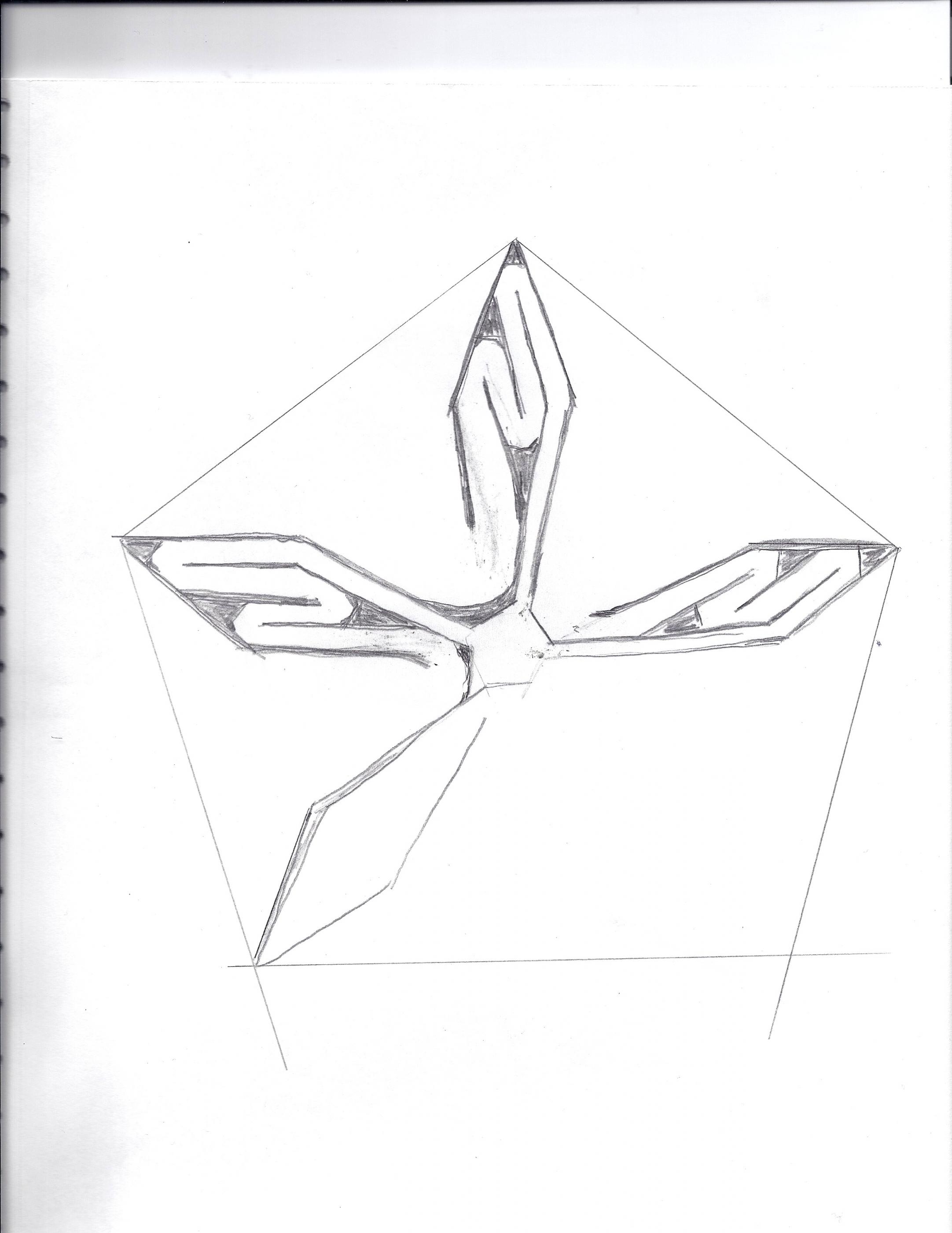

Next idea is along the lines of daisy but as a Pentagon. Quick sketch is easy, real drawing, well, we'll see.

OK, more to scale, I found this may or may not work. For the expansion needed, the 'petals' have to be wider like in this diagram so I'm not sure how the mouth flare is going to work. The actual change in the angles with be rounded not sharp as drawn but that seems to change rather quickly right at the mouth. As far as size goes, it's scalable like the other designs but I notice this has a much larger chamber and shorter horn lentghs. They seem to be about half of what the spiral offers. Right now the throat atarts at 1" and exits into the mouth horn at around 2.5" (pentagon - 32" flat to tip.)
Thoughts?

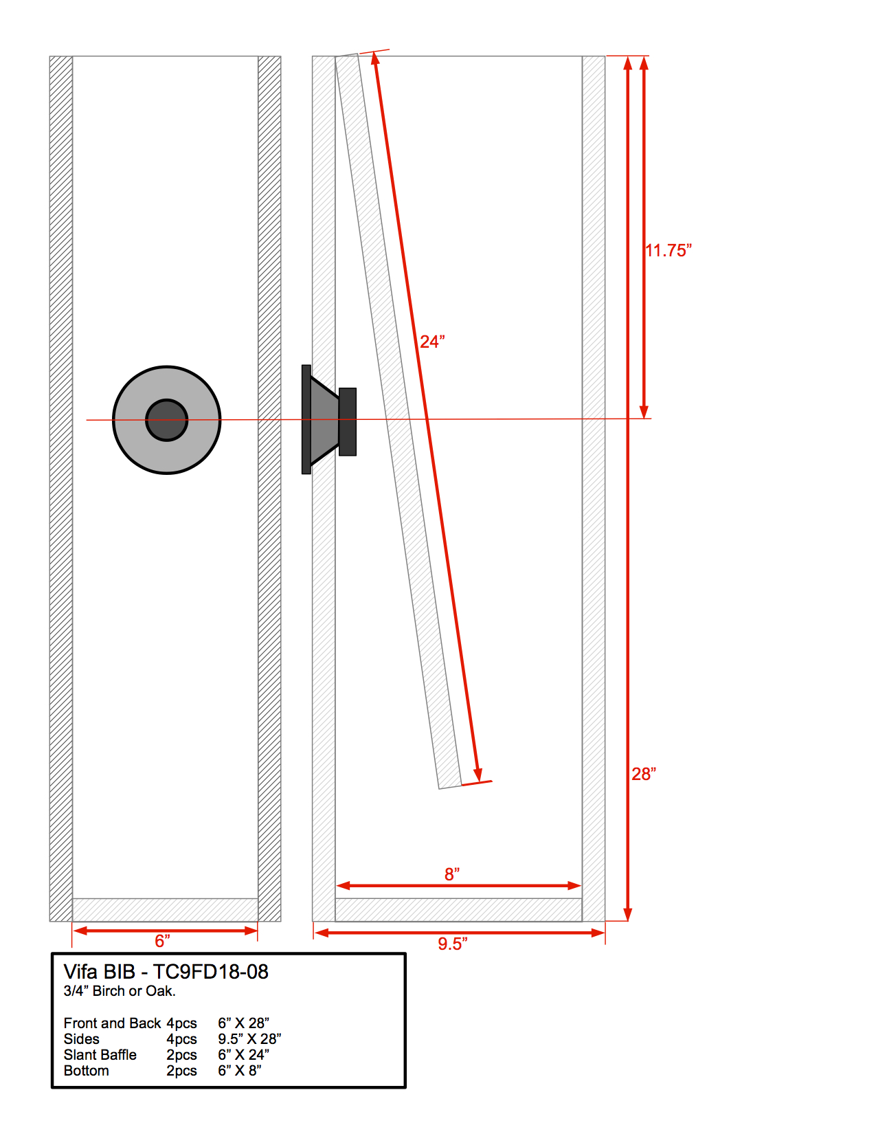

I was initially inspired by Jhutka's TC9FD BIB

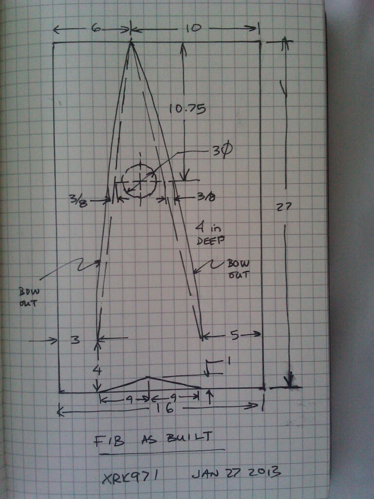

but wanted to make it flat for a wall mount as I have no floor space.
I came up with the flattened design based on the volume and length dimensions produced by GM's BIB calculator (which gives same dimensions as Jhutka's design above). I basically preserved cross sectional area by squashing the BIB to 3 in deep. I had to make an inverted V divider to have enough room for driver. Plan as built is below (note typo - 3 in deep not 4 in). I made the V curved as a change from original BIB design to buy more clearance for driver and hoping to make horn expansion exponential instead of conical. Very easy to do with foam.

Those look great, :cheers: so you opted for some pretty thick plywood there. It must give it a substantial feeling and less resonance on the baffle. Are those Vifa's being driven by the tube amp in the picture? What depth are you using on the channels?
X
Thanks xrk, I like the thick baffle for driver mounting, foam works well for the back and spiral. Thick baffle still seems to retain that magic sound on acoustic and vocal. Speakers are about 6.5' apart on center. The back has a piece of Sonic Barrier 3/4" foam 8"x 8" centered behind the driver with a ply strip 18"W x3"H x1/2"D (Gorilla Glued) and a saw tooth hanger. That makes the the speaker 3/4" out from the wall. Moderate stuffing in the channels, heavier stuffing at the exits. Sounds great as a stand alone system, integrates well with sub (PE SUB-1200) on demanding music (this room is big with high ceiling). The amp is Elekit TU 879S with JAN 12AT7WC & stock 6L6GC.
20"x20" with 2 1/2" depth channels
