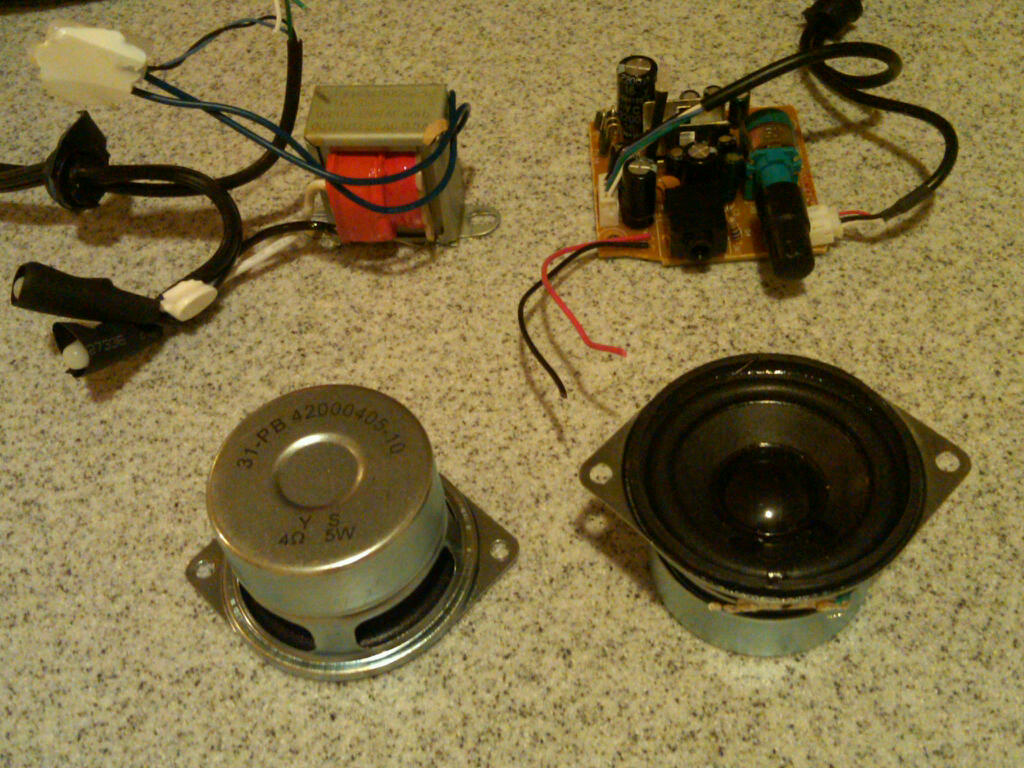

Here are the salvaged baby drivers that I will put in the 'Son of Cornucopya' until I find a good 2 inch driver. Does anyone know who makes these? The "Y S" designation sounds like an Asian brand of some sort. I may even use the little amp that comes with it (maybe stuff it inside the speaker cavity in the middle of the horn?) Should be plenty loud for office desktop speakers...😀

What about the W4-1757SB? I know this looks very non-traditional, but the flat panel look may be kind of cool in the Cornucopya cabinet, if painted white to blend in with walls. The performance is actually pretty good if you look at the curves - it has that nice hot high end that would work well to balance out the copious deep bass.
http://www.parts-express.com/pdf/264-881s.pdf
