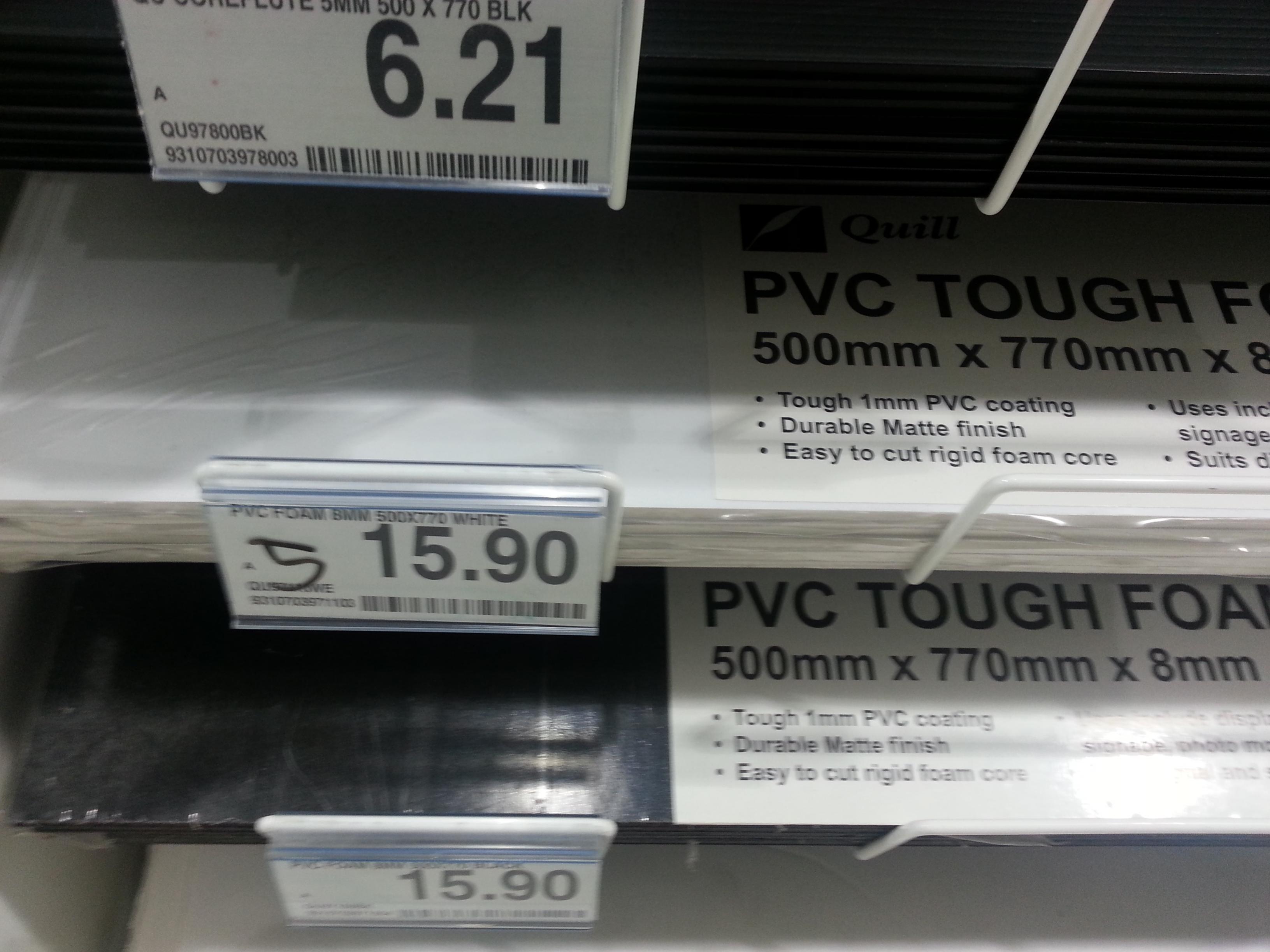

Saw this at officeworks today. Pvc instead of paper.
I wonder how that would work?
