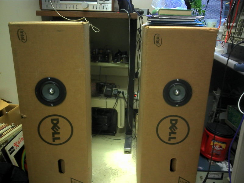

Nice surprise at work today: a parcel! The tang bands arrived. They seem so tiny! I'm worried... So I mounted them quickly into a couple of empty server boxes but they don't sound good. Guess I must be patient to hear them in a proper enclosure.
The vifas are even smaller! :O
What do you expect they are, afterall, Dell Boxes 🙂
Don't forget that you want to get at last 100 hrs on them before paying much attention to what they sound like.
dave
Like Dave said. They need time to break in. I would play them in those boxes while you build the real ones. That way, the drivers will be broken in when the time comes.

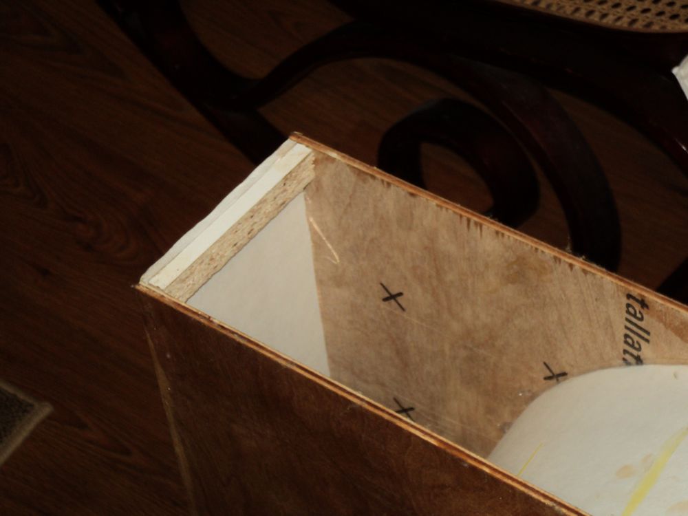

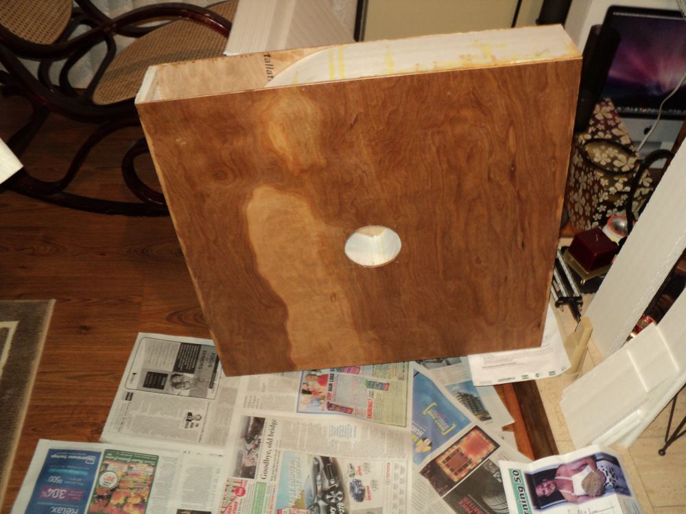

So today I picked up the trim pieces and realized I can't cut them until the grill cloth is in place so I went on to doing the wood oil. Watco - Danish Oil, Fruitwood. Looks really good but...
...note to self: Don't buy dollar store masking tape. How stupid is that? I now have oil where I want to glue on my trim so I will be cleaning with alcohol and sanding before applying the trim.
I added a small piece of wood [3/8" X 3/4"] under the foam right where it meets the corner. This will add some strength for when I put the grill cloth on and as a bonus, it gives me a handle with which to carry the boxes.
That's it for today, hopefully cloth tomorrow.

I am happy with the appearance for something called underlay. Last pic shows the piece I added for strength. In that pic you can see the oil contamination on the edge that I now have to deal with 🙁
Bad Cal!
Too bad about the oil spill Cal!
Quick question for you, since you have the same plywood as I. Do you have any idea what the top veneer is? Does it look good with the oil on? I'm not sure whether to go for shellac or simply do it with oil like you.

Thanks guys! Funny thing is, I had some old 5" mid/base drivers from an old Kenwood stereo and put them in the big Dell cardboard boxes in parallel with the vifas. It completely floored me: full nice bass and mids, and there are highs too. The cardboard boxes beat my other speakers. 😡 The cornucopya has to be better, I can't keep the cardboard in the living room.:gnasher:
