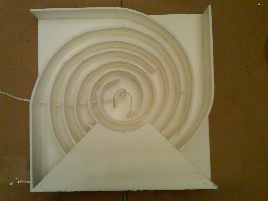

No wait all hot melt approach
I segmented the back and hot melt glued in sections before glue hardens. Having two hot melt guns and four hands would make this easier as I had to lay down the bead of hot melt furiously fast. It is fast and no wait but there is no room for error. Here is one panel glued on the back. I made the portion that covers the speaker chamber circular to ensure a good seal. One of the Son of Cornucopya is now done. This may not work so well for larger ones as you would really need to segment a lot. An alternative is to use 5 minute epoxy as that would be more forgiving than the 30 seconds one has with hot melt.

Way to go 6L6! Baltic Birch is a nice touch. Which driver were you using again?
Yes, the wood is going to be a bit more attractive than the underlayment, but I wasn't turned off by that, I figured a quick bit of paint would have fixed it. However, I like the birch better.
The question in my mind is if the glued edges of the spiral will be able to support the weight of the birch front and the driver. It might be no problem at all, but at this point it's unknown. (There is quite a bit of glue area...) Somebody thought some dowels towards the terminus of the throat would be a good idea for resonance control or reinforcement. I will look into it if there is an issue of strength.

Cal and I discussed using bolts with tubes where speaker screws are.
Rather than dowels.
Ooh! That's a great idea! I never thought about that part, other than using through bolts and fender washers on the back. The tube is a great idea.
The dowels I'm envisioning near the end of the horns... to brace where the outer panels are furthest from the foamcore.
