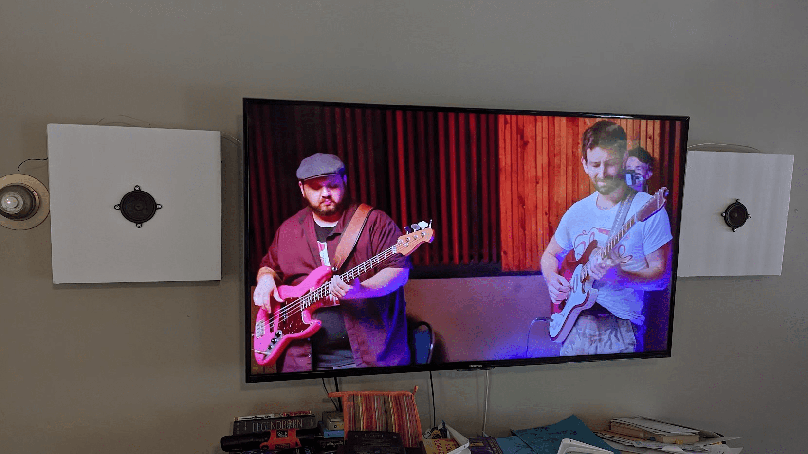

I'm musing on how to mount them as flush to the wall as i can, but once they're mounted I'll post a picture 🙂
Here they are in place. I used some twine and hung them like pictures...
Nice work. Looks like a simple high payoff project. Cover the foam with some cloth or graphics etc and put a wooden frame around it and it will look right at home. Did you settle on 2.5in thick box? What were your vent dimensions again? It would be good to record the final configuration so others can easily give it a try. Thanks

I re-used your instructions from this post: https://www.diyaudio.com/community/threads/full-range-on-wall-for-home-theater.260758/post-4028642
I changed the depth of the box to 2.5 inches, and made the length of the port at the end of the transmission line 5.55cm long.
