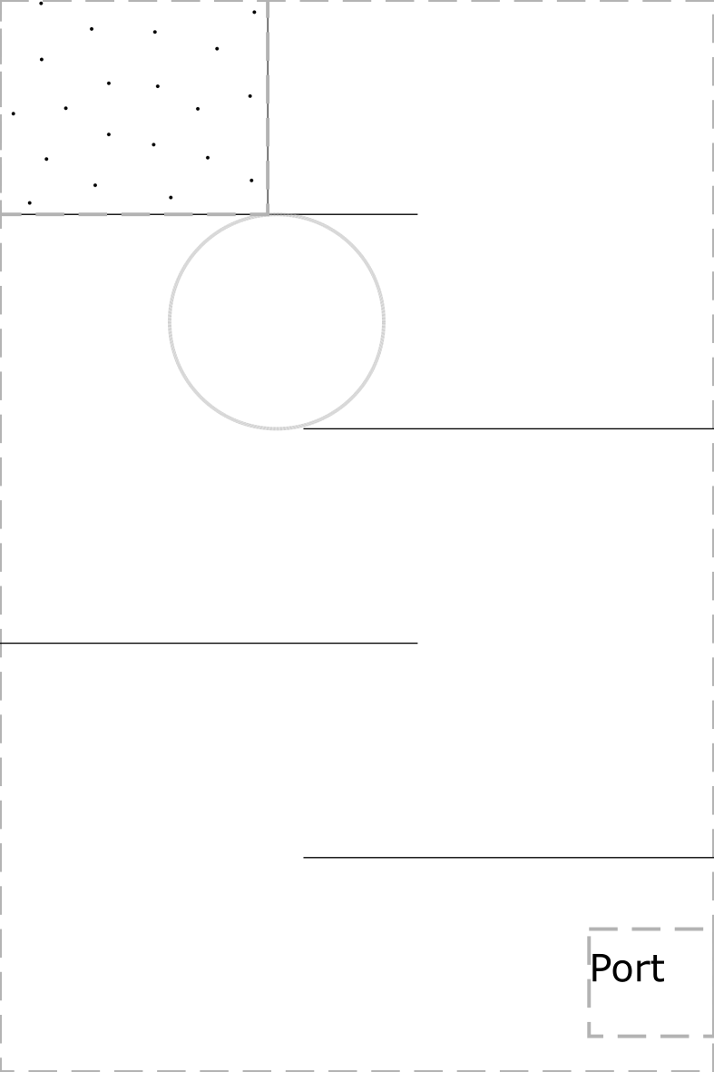

When I was originally thinking of the idea I thought that too. Sorry, I didn't explain the idea clearly, so here's a picture of what I was trying to describe 🙂
The dotted area at the top-left is unused space to make the pipe length 72 inches. I might have put the speaker hole in the wrong place, but I'd guess it should be around 24 inches from the closed end of the pipe. Hopefully that makes sense!
Thanks for humouring me @xrk971 🙂 Yes, doing it like that seems to end up with quite a long path - I might be measuring it wrong, but even with the inset at the top a rudimentary measurement of the whole path is still around 96 inches. I might be measuring incorrectly, though.

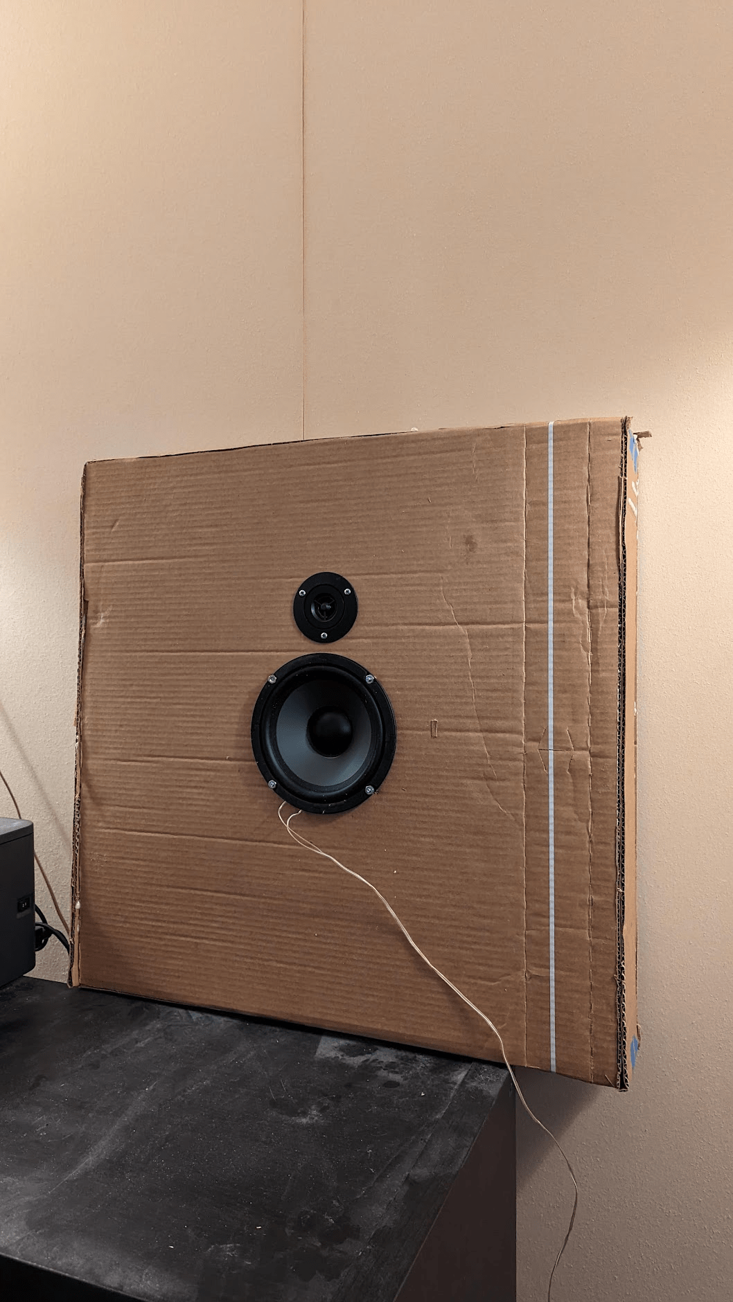

@xrk971 - I decided to take your design recommendations and fabricate it in carboard, for the 6.5" Polycone Woofer from Parts Express.
The front panel is two sheets of cardboard, laminated together with wallpaper paste (because I had it on hand 🙂 ), and then I had some thick honeycomb bits of cardboard I could cut down for the inner walls of the 'pipe'.
I also had some closeout tweeters from Parts Express - the 1/2" mylar tweeters (though the exact part number isn't available from them any more), and I remember getting them because the frequency response of both drivers meant for a crossover between the two drivers without any circuitry. Plus, they're cheap! About $12 in total for a woofer and tweeter.
I've just plugged this in and tried it out, and it's quite impressive - that experience of the deep Bass emerging about 6 feet from the wall was definitely noticed. I'll try it with some more listening material, but it works really well so far! I bet a stereo pair would sound better 😉

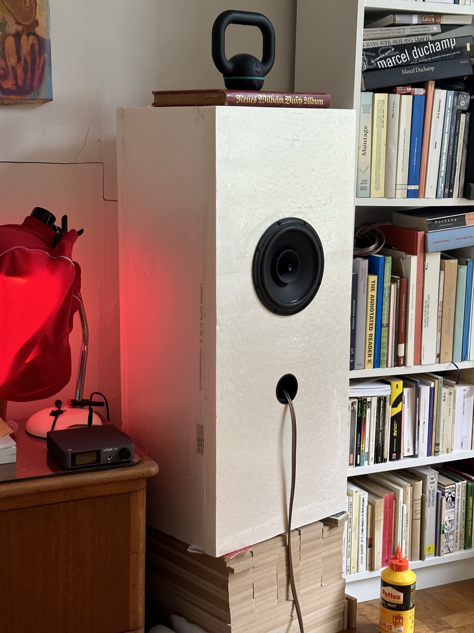

I've read this thread from beginning to end more time than I can remember. I chose XPS for my first ever build, for the ease, and also to save (a lot of) money. I think I may have built the biggest XPS cabinets out there, or close. I don't remember seeing something this big in the thread of elsewhere. It's a 70-ish liters bass reflex with a SB20FRPC30 8" fullrange driver.
They are 94 x 42 x 28cm. Built out of a mix of 40 and 30mm 'URSA' XPS that can be found here in Belgium. It may be slightly less dense than the pink kind you guys can find in the US.
Mistakes were made during the build. My glue (high quality white wood glue) wouldn't set at all. It would take a long time before things became sturdy enough to move on with the build. I don't think I braced the thing quite enough. I'll make sure to fix that once I get started on the second one.
It's also so light that it vibrates where it starts unloading sub 100Hz frequency. I implemented a cuttoff around 35Hz, and after adding some weight on top of the speaker, I can blast it at unreasonably loud level without any audible vibrations.
How does it sound? Awesome, clean and big. I'm verry happy with it. I initially had some leak issues, but after some more time under heavy clamping, I seem to have tamed the leak.

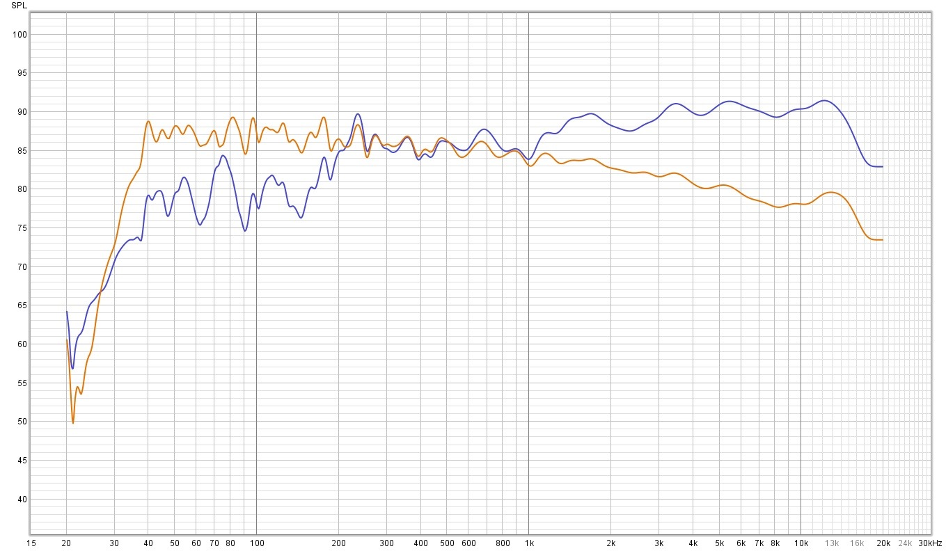

Here are the uncorrected (blue) and corrected (orange) measurements at 1 meter.

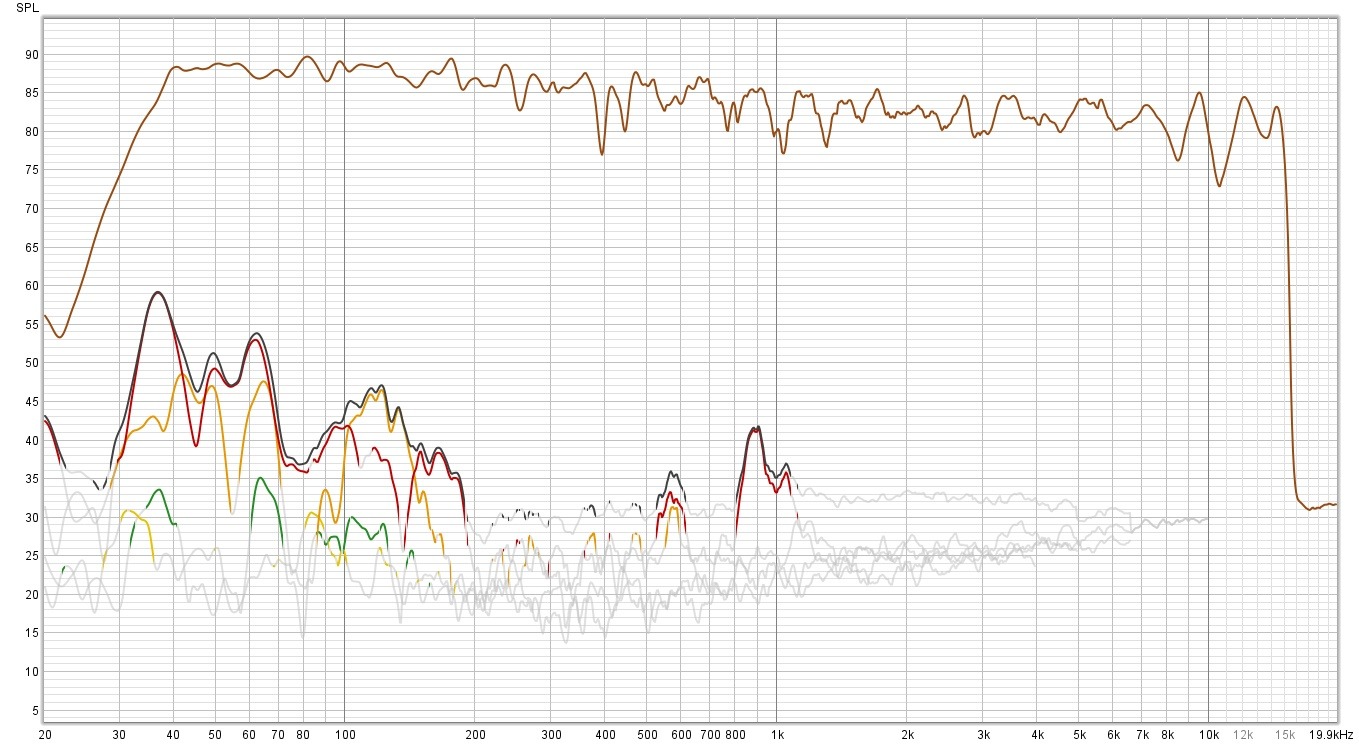

Distorsion numbers (which I don't really know if they're good or not, but it sure sounds clean).
