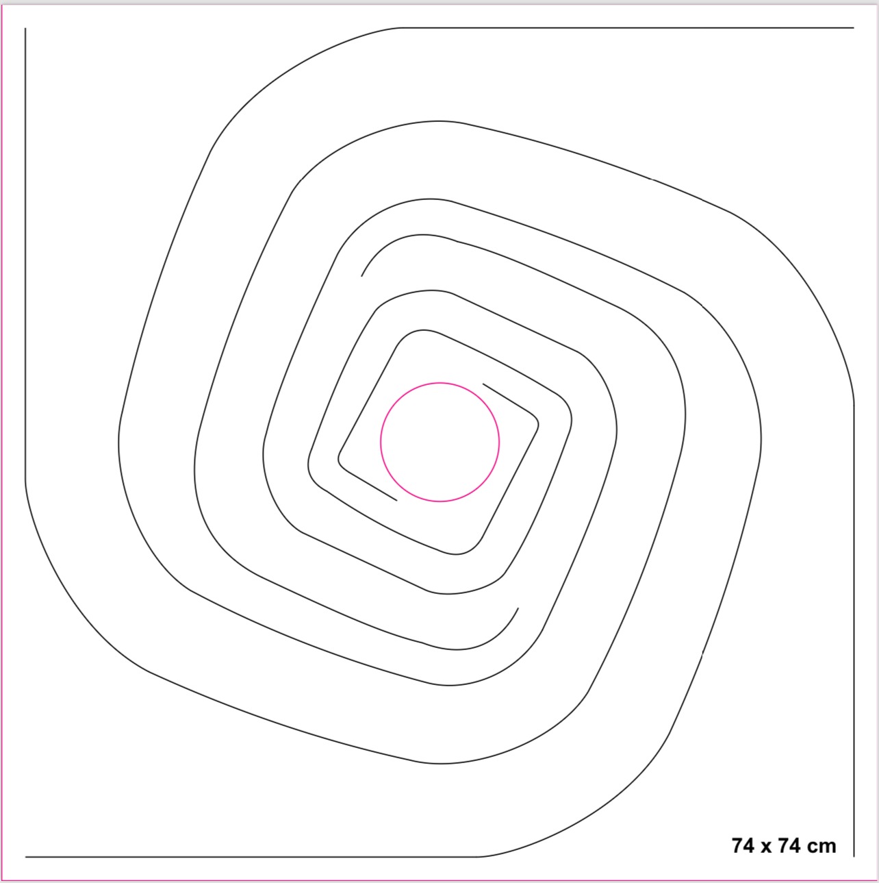

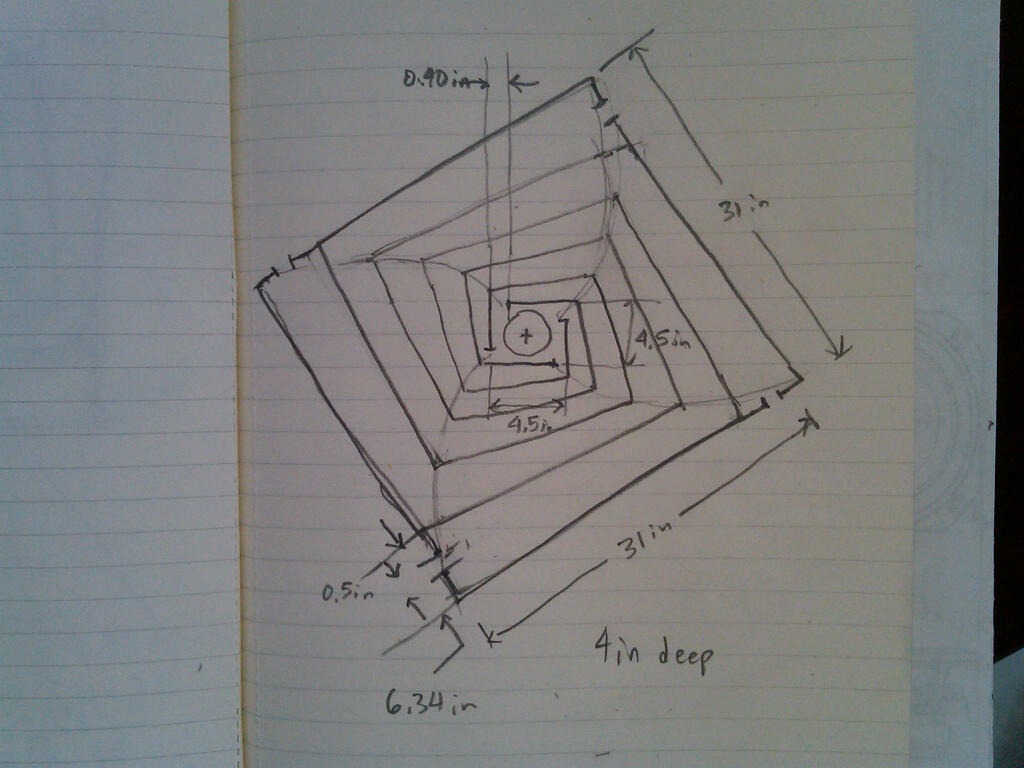

ok fair enough, have you had any experience with the straight section but expanding cornucopya Dave came up with all sections are straight) or do you know anyone who built it? Thanks.
That sketch loses a lot of mouth. Probably won’t go as low,
Dave it looks very attractive to me for some reason. If you made it larger you could lengthen the horn but It gets a lot larger. Thanks for the info on the driver I have been reading the thread will check the driver out soon. I very much appreciate your assistance.
I don’t know anyone who made a straight wall version. The whole point of the foam core was that it was easy to bend and shape into a curve. Straight sections is a lot more work. The corners will give you more acoustic filtering of the mids and highs so more bass relative to mids and highs makes it out of the horn mouth.
not having had the chance to build a cornucopya yet it seemed to me (just looking at it) that straight sides would be easier to mount than working with curves but I will accept your advice and go with building with a spiral expansion.
can you tell me a few things please? how is the horn length determined for a given driver? How does one determine where in the horn expansion the line should be bifurcated?Thanks for the help.
I would stick to making the proven design pdf or image plan and scale as needed. The lengths are determined using back loaded horn theory. The cornu achieves a higher expansion ratio than any other horn. If you are new to horn design, I wouldn’t pick a cornu as the first to design. The quarter wave length and the speed of sound set the length of horn. Set lengths different by 1/3rd length of longest.
There is an Akabak script for this in the cornu thread. Modifying that will be the most effective way to change the design.
This base design has a fundamental of about 50Hz as I recall. This was by member Endia I think. Planet10 also has one with grid marks.

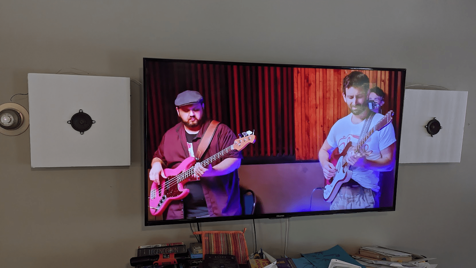

Back to these 🙂 I've been using them since, and they've been great. However, I've noticed that because of their depth the TV seems to 'shade' some of the sound, leaving some perceptible nulls at various listening positions.
I took a few measurements today, and found that if I were to make boxes that were 18x18x6 inches, they would be flush with the TV screen itself. Some testing with other speakers over the last year has brought some interesting results, where coupling a speaker to the screen makes it use that large flat surface as an extension to the baffle, so the mid-range almost jumps out 🙂
The question I have, though, is would a box of this size be too big for the FaitalPRO 3FE25 drivers? Their Vas is 0.06 cubic feet, yet a box of this size would be 1.125 cubic feet! Is that a concern? Would I need a bigger driver?

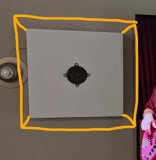

I am by no means an expert on these, but... You could put three or four spacers behind the speakers to have them stand out farther. If the wall coupling of bass disappears, you could make foam core flares at the back to reconnect with the wall... The bigger boxes you suggested would alter the horn loading and make a completely different speaker.

Yes, you can do that but Cornu already has the largest horn mouth opening ratio for any horn speaker and is not lacking bass. In fact, people generally say it has too much bass which is why we add stuffing to game it down. The flared opening once elevated from wall would indeed work. That might improve imaging.

It's an interesting thought, but given that it's meant to be on-wall, wouldn't the spacers de-couple it from the wall? I've got the terminus for the transmission line firing up.
